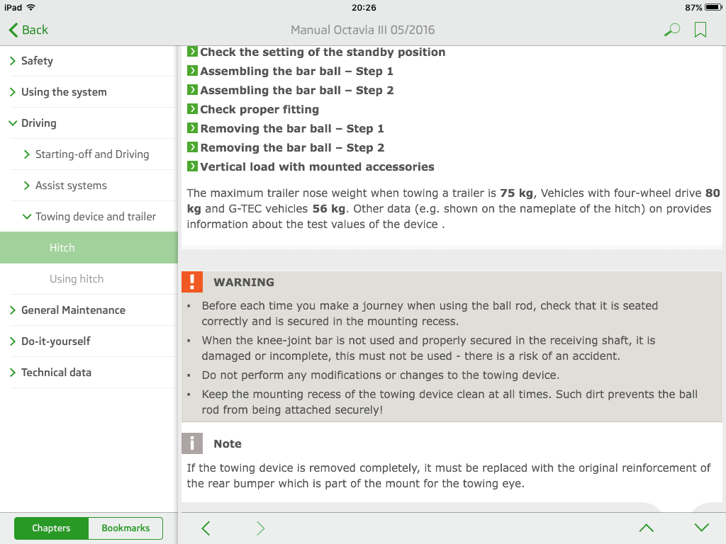

I attach a simple extract from the manual. You can download the whole 300+ page manual from a link on these pages.
It makes good reading.

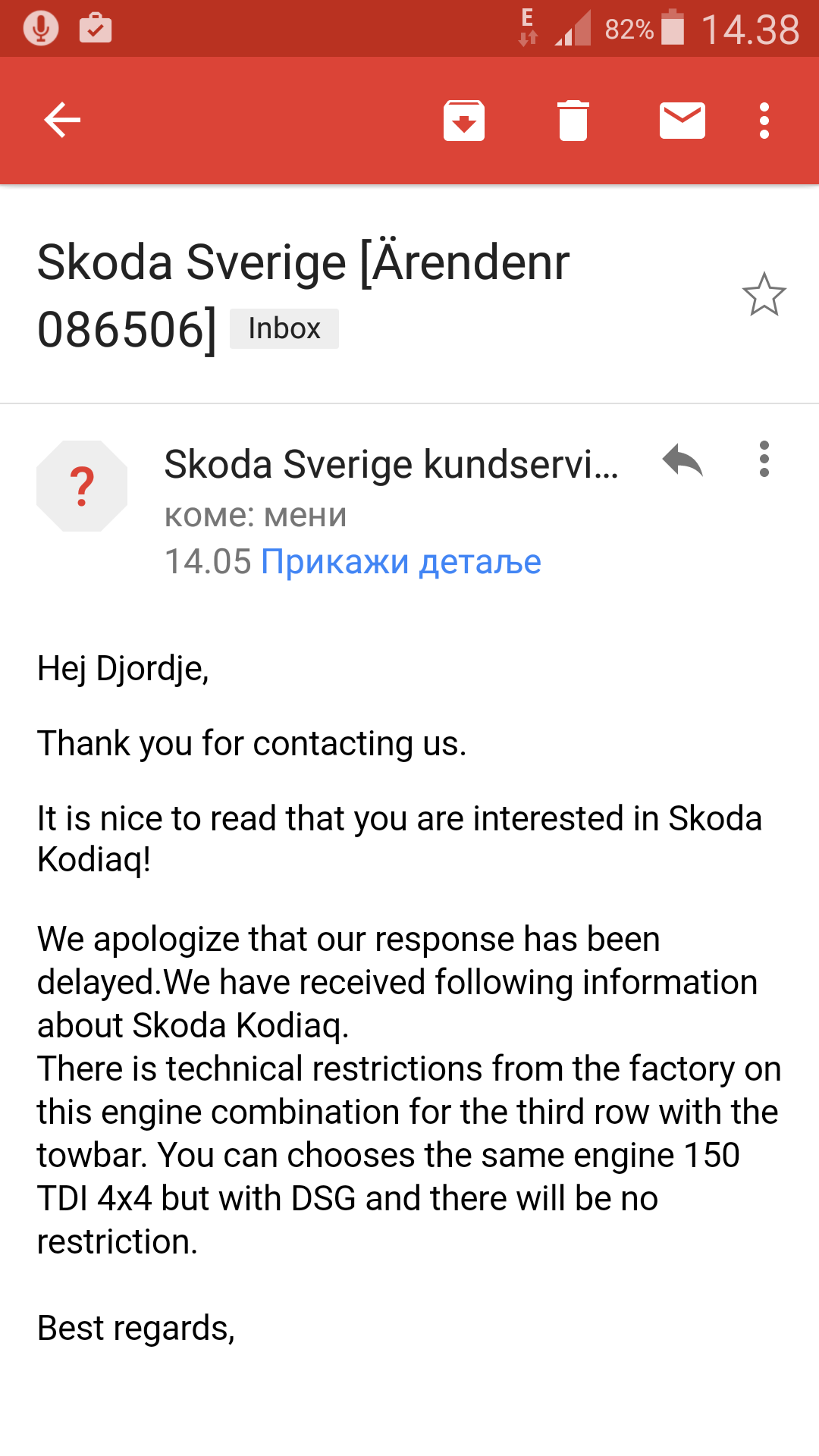

I still dont grasp why 7 seats dont accept trailer hitch in 2.0 TDI 150 HP 4x4 manual?
Local dealer and general importer says that it cannot go, that is the message from skoda central server for car configurations. I am not giving up, I sent few mails in other countries to skoda dealers. It could be an error, but i dont believe. I hope that it will be possible when the car arrives to put do the hook instalation in the servise shop. Serious SUV must have a hook:)
Def no can do:(
