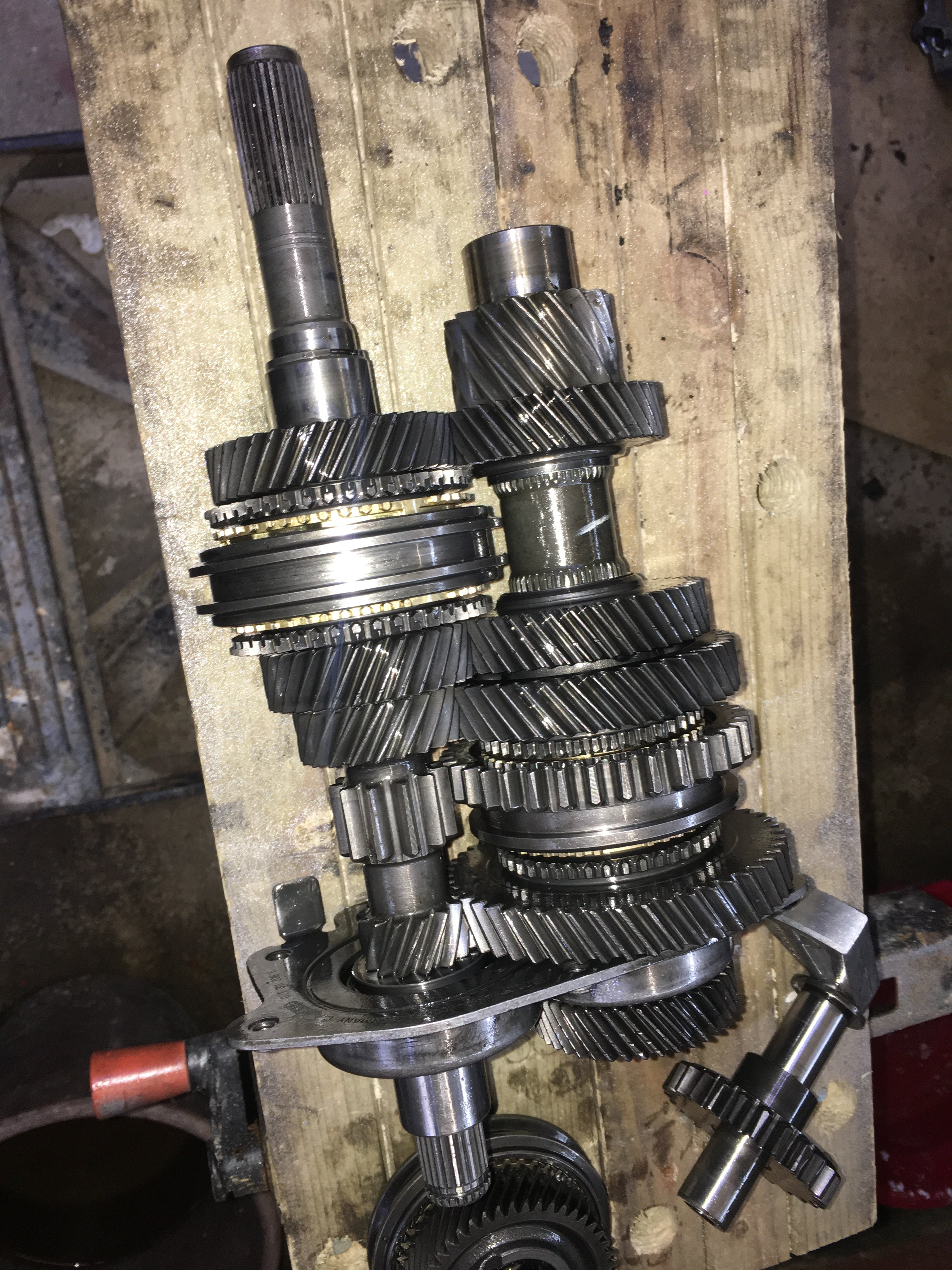

I've just spent some time disassembling the old gearbox to try and find what's at fault, will upload some pictures later of the components that look damaged/worn.
Sounds like it's all working perfectly :)

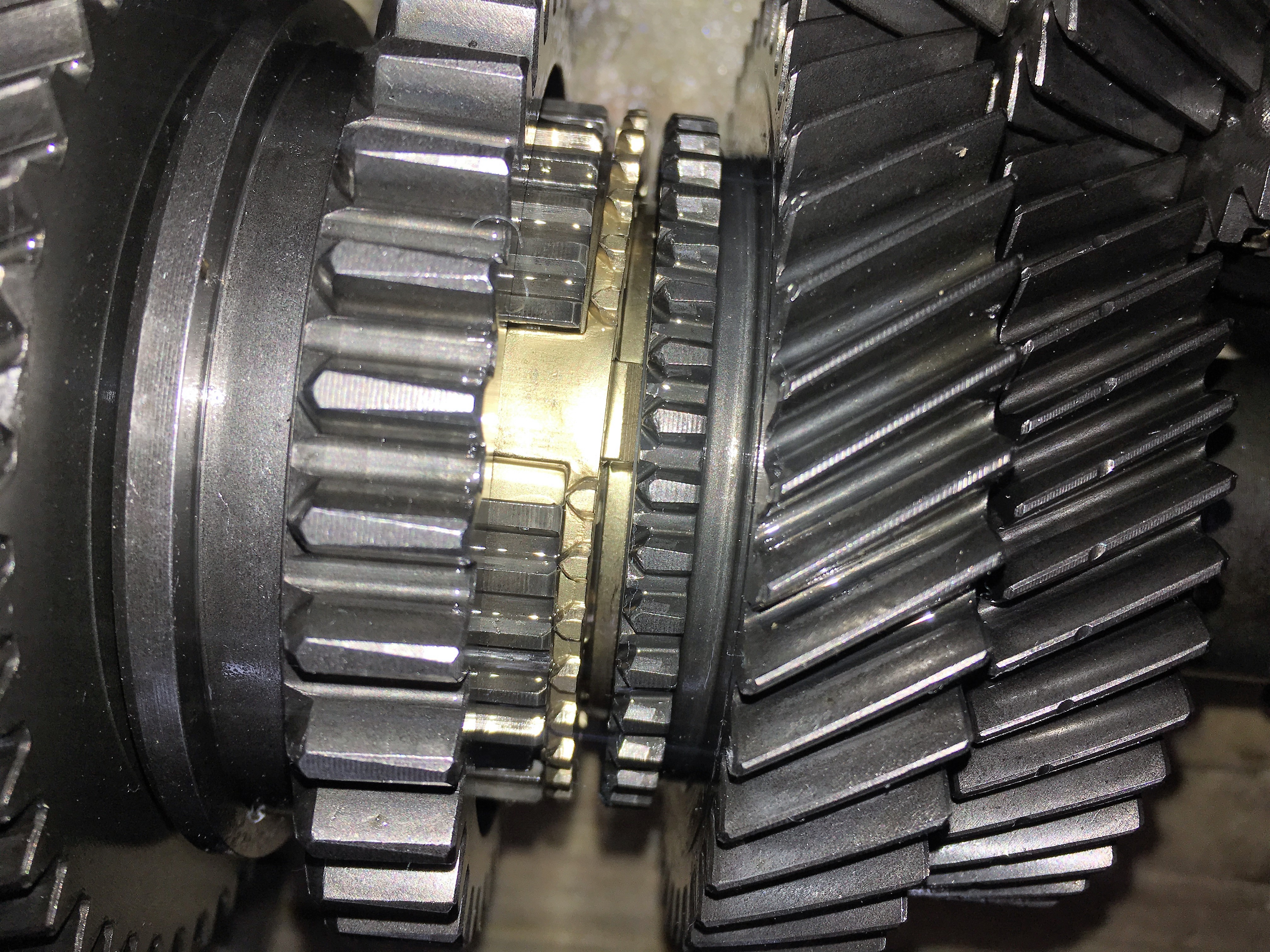

Just posting a few of the pics I took of the old gearbox in case anyone's interested
This is 1st gear, the main synchro ring has quite a bit of wear to the points of the teeth. 2nd gear was similar although not quite as bad

Lots of wear on the 1st/2nd gear selector lever. (cant really see it all that well on the picture)
Main magnet inside gearbox casing
Oooh, look at those nasty chips out of that gear on the right in the first pic.
Someone should have went to specsavers....
What ya mean? Is it meant to have those marks on the points of the gear teeth?
