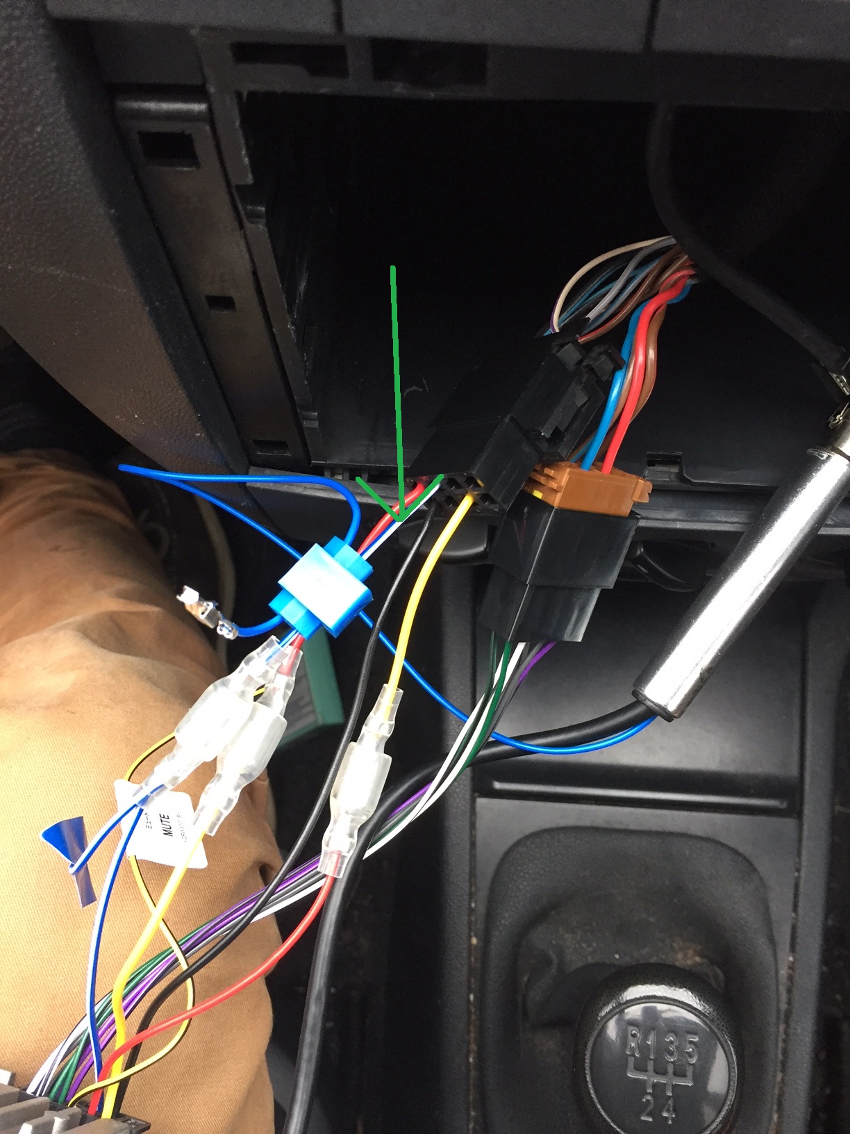

So i tried Medium Wave to see if I could find 5Live or something, but couldn't get anything. Im in Oxford so not sure if the signal is great here anyway. I then tried to "power" the aerial booster using a scotch clip I got from a hardware store.
So I used my multimeter and found the ignition live wire (yellow) that records 12V with the key in the ignition and Zero Volts with the key out of the ignition.
I then found a blue and white striped wire which also was recording 12V with the key in the ignition. I took the key out and before my brain had kicked in I had used the scotch clip to attach it to the radio booster wire. THEN I realised that this wire is 12V with the key out which means I could maybe drain my battery??...whoops!!
Anyway I tried Medium Wave and couldn't pick anything up. Could be the area? Could I ask you to have a look at the photo I took to see if you can see any problems with my scotch clip placement (The green arrow is pointing to this wire I found which is continuously 12V.). Did i place it on the wrong side of the head-unit? Or maybe the wires have to be going a certain way intoo the scotch clip?
For now i've unplugged the radio and i'll need a new scotch clip to try this again with the correct yellow ignition live wire.
Thanks for your help once again!!
You need to remove the clip and connect it to the yellow wire (with the blue booster wire). Permanent live is no good as the head unit won't turn off when you take the key out. You can sometimes get away with using the clip again if you only have one. Put a bit of tape over the splice on the mistaken wire. Don't leave that metal bit on the end of the blue booster wire as it may touch on something and blow a fuse. The wire isn't supposed to protrude out of the Scotch clip. The is a little stop inside that is meant to prevent it. You need to cut the metal bit off the blue wire before using the clip.

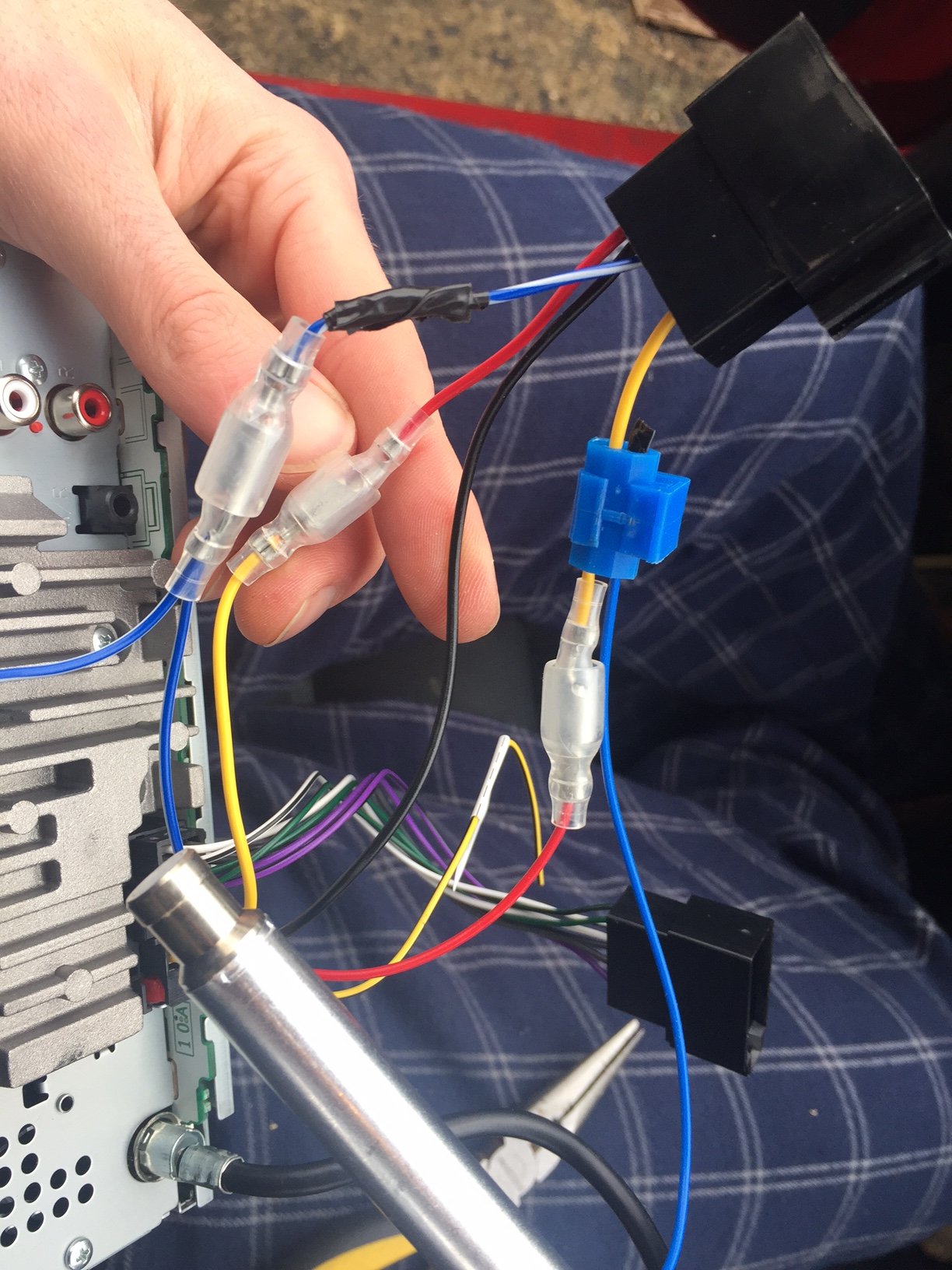

Hi again,
Finally got round to having another go at re-wiring the radio. Thanks for your advice, looks like I made a number of rookie errors :)
I managed to re-use the scotch clip on the yellow wire.
It looks like this now (see image). No more metal clip waving about in the breeze :)
