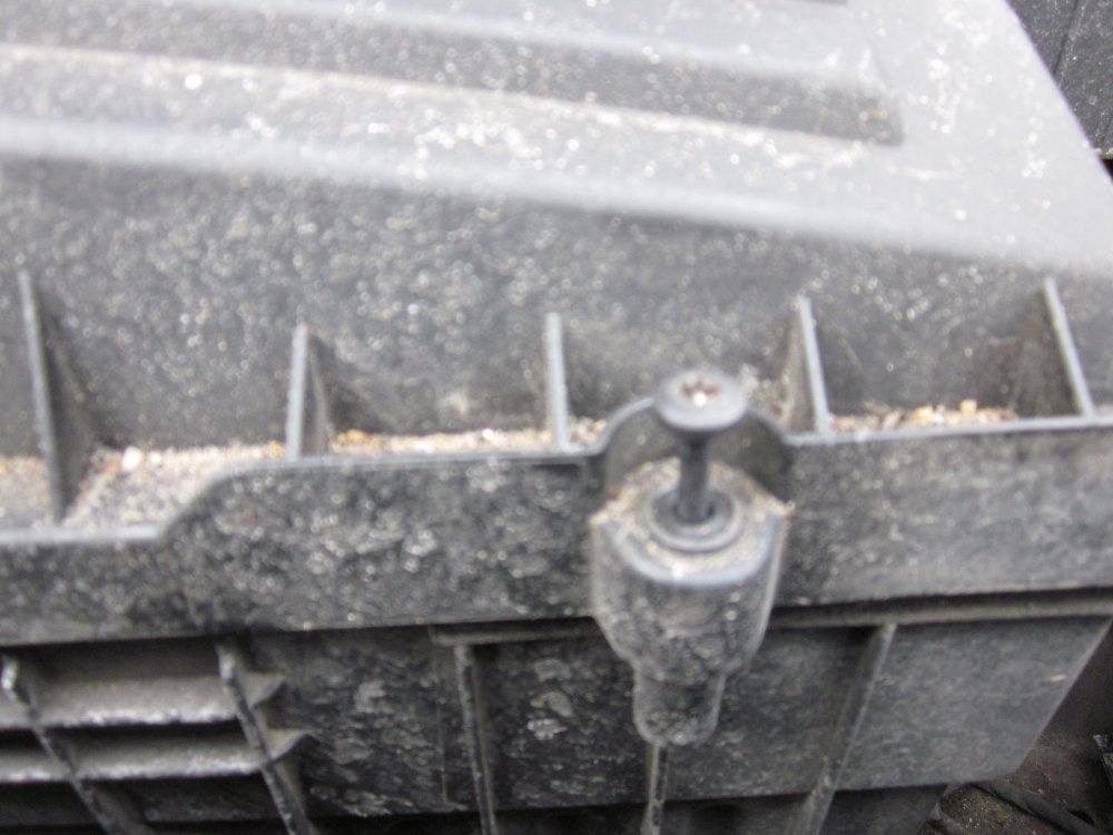

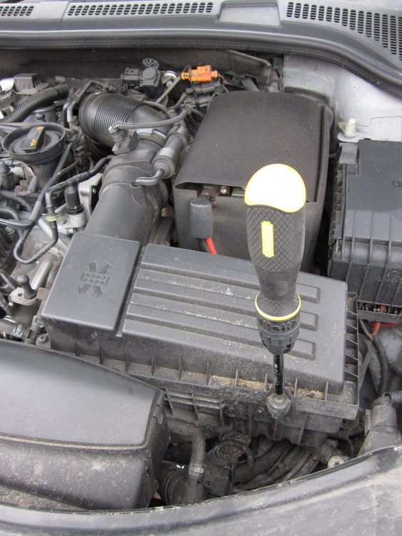

Some of the above on my MKII VRS are quite worn and tricky to remove. I thought I'd try to source some replacements before servicing it next weekend. I couldn't see anything on ebay, but maybe I didn't search hard enough. Do they have any specific names apart from 'housing screw'? Or would they be reasonably priced at the dealers?

The air box screws are a little unusual. In a TSI they are anyway.  They are a very coarse thread  and they are not threaded for the first 25-40mm I can't remember exactly - you'll have to remove one and check.  You'll be hard pressed to match them exactly, I had to get some close matches and file the non threaded section down smooth. The non threaded section allows the top section of the filer housing to seal more easily with the bottom section without getting caught up in the thread.

My airfilter box screws were very corroded on the heads - imagine yours are too.

I'm engaged in the same search for air filter box screws for both my Octavia and my son's Fabia 2.  The screws in question are known as Hi-Lo thread forming screws, and in the case of the Fabia at least, they're Phillips headed (not Pozi-driv).  These threads are generally specified where multiple insertions are required into plastic.  The plain shank allows them to be captive in the box lid.  They're definitely not freely available from DIY stores.  Our dealer has made the same response as that received by TheClient above:  happy to sell us a whole new box lid for £(stupid amount).  I'll measure one up and see if a specialist plastics fastener supplier can supply any.  I'll let you all know how I get on.  Clearly stainless would solve the problem in the longer term, and as Phillips drives are not my favourite, I'll see if they come in either Pozi or Torx.
