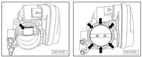

For mine BBZ engine I took TB off, cleaned (with moving of butterfly- it's only possibility to clean edges of it), re-installed without adaptation- works fine.
That greatly helped to solve issue with RPM's, hanging from time to time after releasing of acc.pedal.
BBZ have no gasket but some green rubber rectangular ring which still looked perfect after 10 years.Capture.JPG
