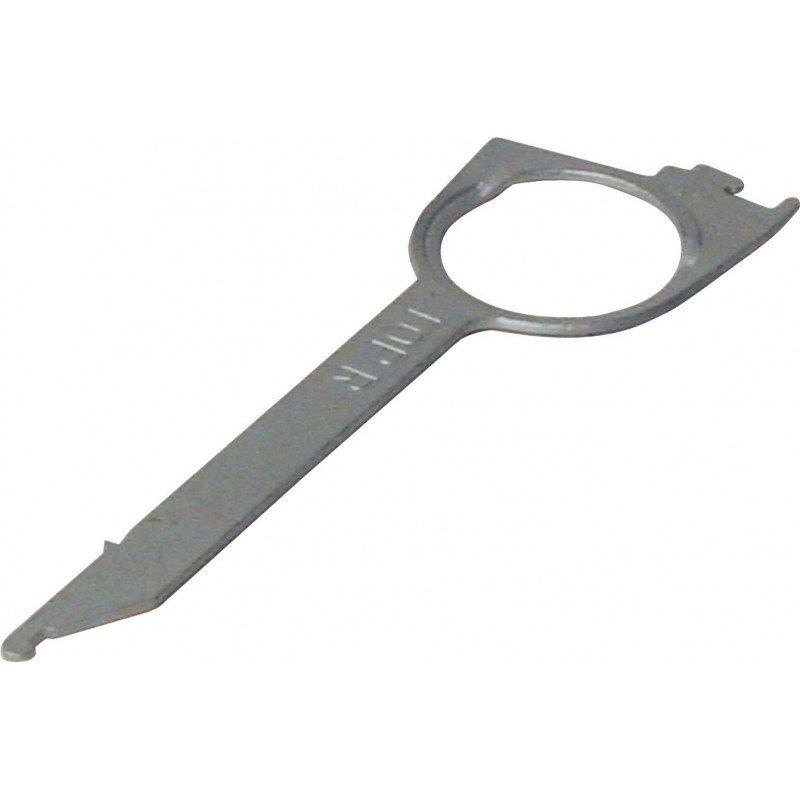

I have took the plunge and order the Navgate Evo! Can anyone suggest which stereo removal keys I have to buy to remove the existing infotainment unit?
Best double check with supplier but I'm pretty sure Autoleads PC5-93 type fit modern VW group vehicles.
EDIT:   This may be of some help to you:   https://www.youtube.com/watch?v=EFf716OG7CY
Edited by Guest
Thanks Scot5. Before you replied I ordered this
Keple Car Radio Removal Tool Key by DIN Release Keys Set for Audi, VW VolksWagen, Mercedes Benz, BMW OEM Head Unit CD Media Player Pins | Universal Pin Stereo Hooks Tools (2 pairs) https://www.amazon.co.uk/dp/B079Z9QTHG/ref=cm_sw_r_cp_api_i_-e9gCbKPF9QZS
do you think they will do the trick?
