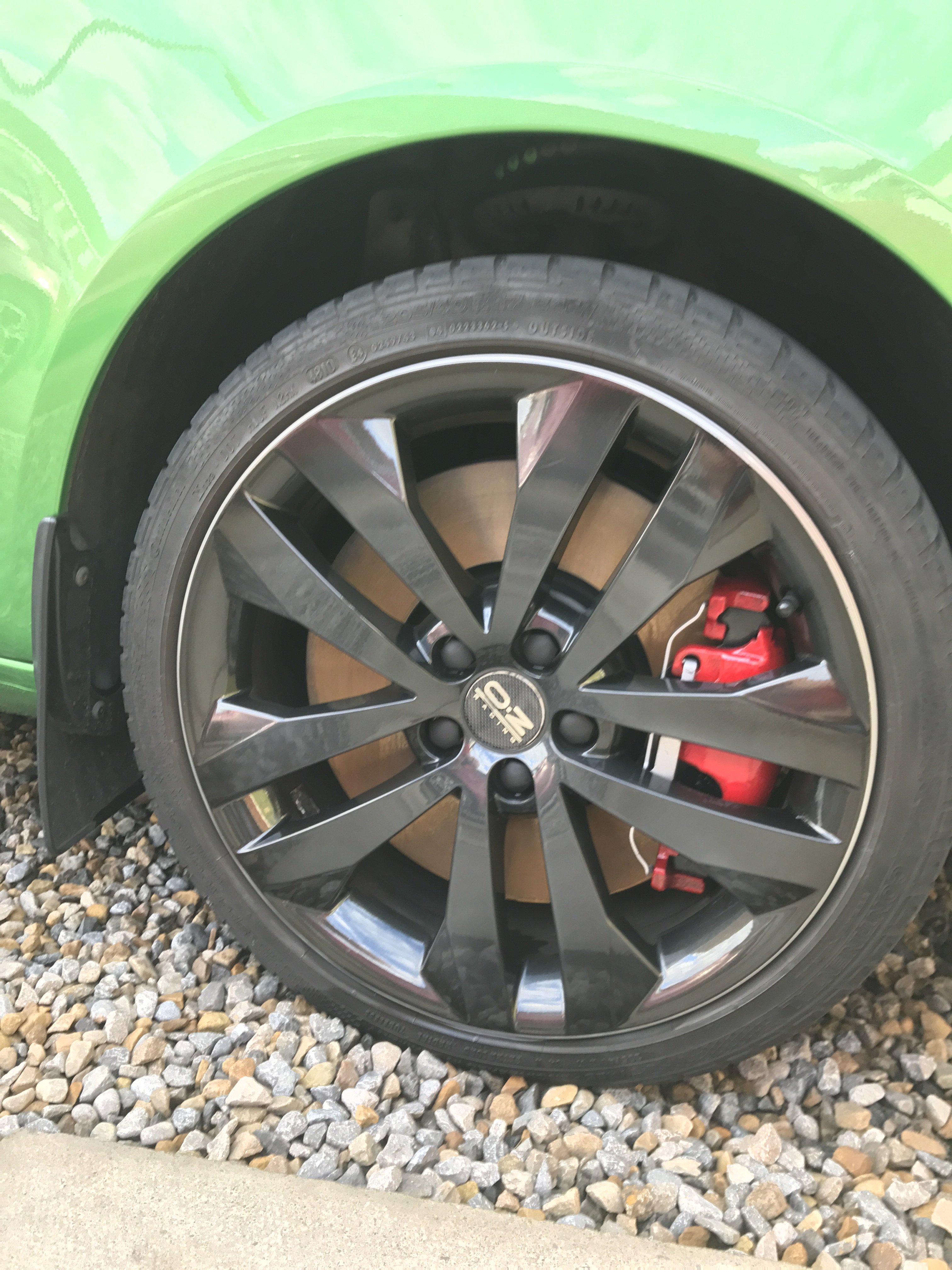

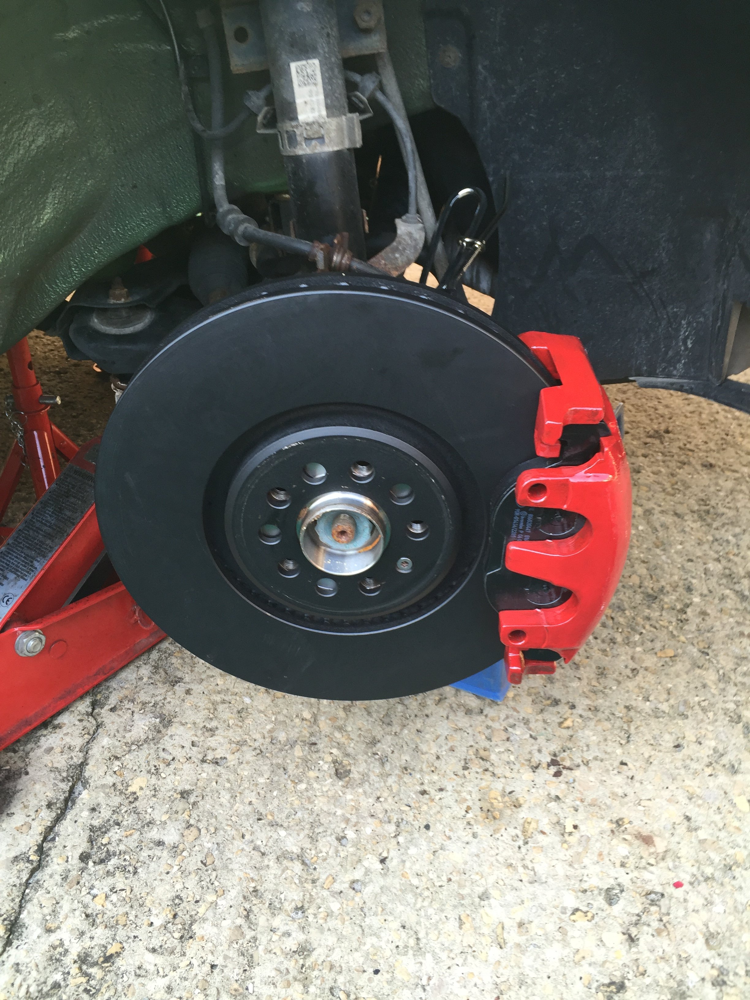

Hi mate, well....................
I was informed by people that yes they would.  However, it seems that those who managed to fit them under the original vrs 17" wheels had used second hand discs and pads!
I used brand new discs and pads and found that the pad retaining spring clip, that isn't shown in the picture touched the inside of the spokes, damn!!!!!!!!!!!
So, I used a 5mm wheel spacer that allowed it to clear but found it gave a horrible wheel wobble at 65-70mph.  I wanted to use hubcentric spacers but it seems they're only available on 10mm and above spacer and I wanted to use the smallest possible!  As the pads are wearing in I've been able to drop to 3mm spacers and the wobble is much much less.  I am hoping that in the next couple of weeks with some 'enthusiastic' braking I'll be able to ditch the spacers all together!
My 17" Gigaro wheels have an offset of 41, I am contemplating getting a set of OZ Superturismo or Team Dynamics Pro 3 wheels with an offset of 38 which is in effect what I'm running with the 3mm spacers up front.  But that's only if I can't ditch the spacers!
Hope this helps!
No they're no OZ wheels, just stickers over the manky original peeling centre caps..  Haha!

Yeah, I'd go for the 312mm set up had I known what I know after my shenanigans of fitting the overkill brakes!
it is however comical if I let someone drive the car and they put themselves through the windscreen by braking 'normally'.
