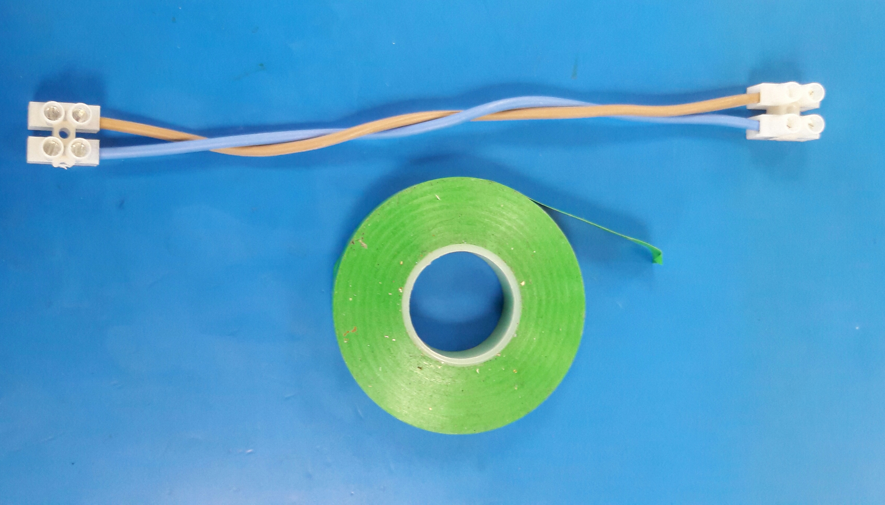

Get under there and do at least a temporary fix.  Low state of charge kills batteries, fix it now, quick-and-dirty, and do a tidy-up when the weather gets better.
All you need is something like this, and a few minutes:
what thickness wires do i need and what are those wire connectors called?
  • Sponsor
They're only low-current wires, anything will do. The connectors are just 'terminal block', any DIY shop or electrical shop will have 'em. usually in strips of 12 which you cut down with a knife.  Something like this: https://www.amazon.co.uk/Double-Position-Barrier-Block-Terminal/dp/B008IDO2FK/ref=sr_1_3?ie=UTF8&qid=1488298280&sr=8-3&keywords=terminal+block+5a
They come in various sizes with screw terminals to suit various thicknesses of wire, you probably want a small size to suit thin wire, like my amazon link. Even smaller would be better still, less tape needed to wrap them up.
You could just twist the wires up and tape them up, instead of using the terminal block, main thing though is to make sure the wires on the car are nice clean copper where you join to, if they've been busted for a while they may have corroded not just at the break point but back up inside the insulation a distance.  Keep stripping back insulation 'til you find clean shiny copper to join to.
I put the reel of electrical tape in the picture because you do want to try to weatherproof the joins, just wrap them generously in tape to keep splashes out 'til you fix it neatly (may never be required if you're not too fussy).
Edited by Wino
