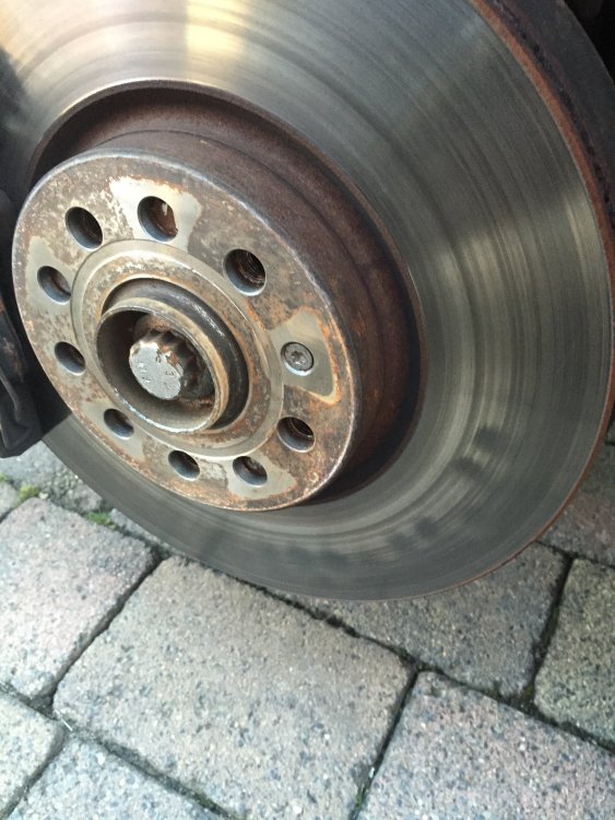

this is a photo of my warped disc. Pretty obvious when you look at it?
The inside of the disc is almost trying to get out that is what causes the spots. These are actually slightly raised on the disc, hence the wobble.

what do you think to the picture of my disc Tilt? Do you think it could be helpful to the OP?

when I say "it's almost like the inside of the disc is trying to get out" I mean the heat spots look like the internal vents have basically cooked and are trying to burst out from within the disc itself.

I do not see how your picture can help the op, but if you ask scott maybe he will tell you wether it does or not.

You mention the photo of your warped disc, and state it is pretty obvious when you look at it, yet your first line in the same post states that the only way you can tell if a disc is warped is by measuring it's run out, you think.
