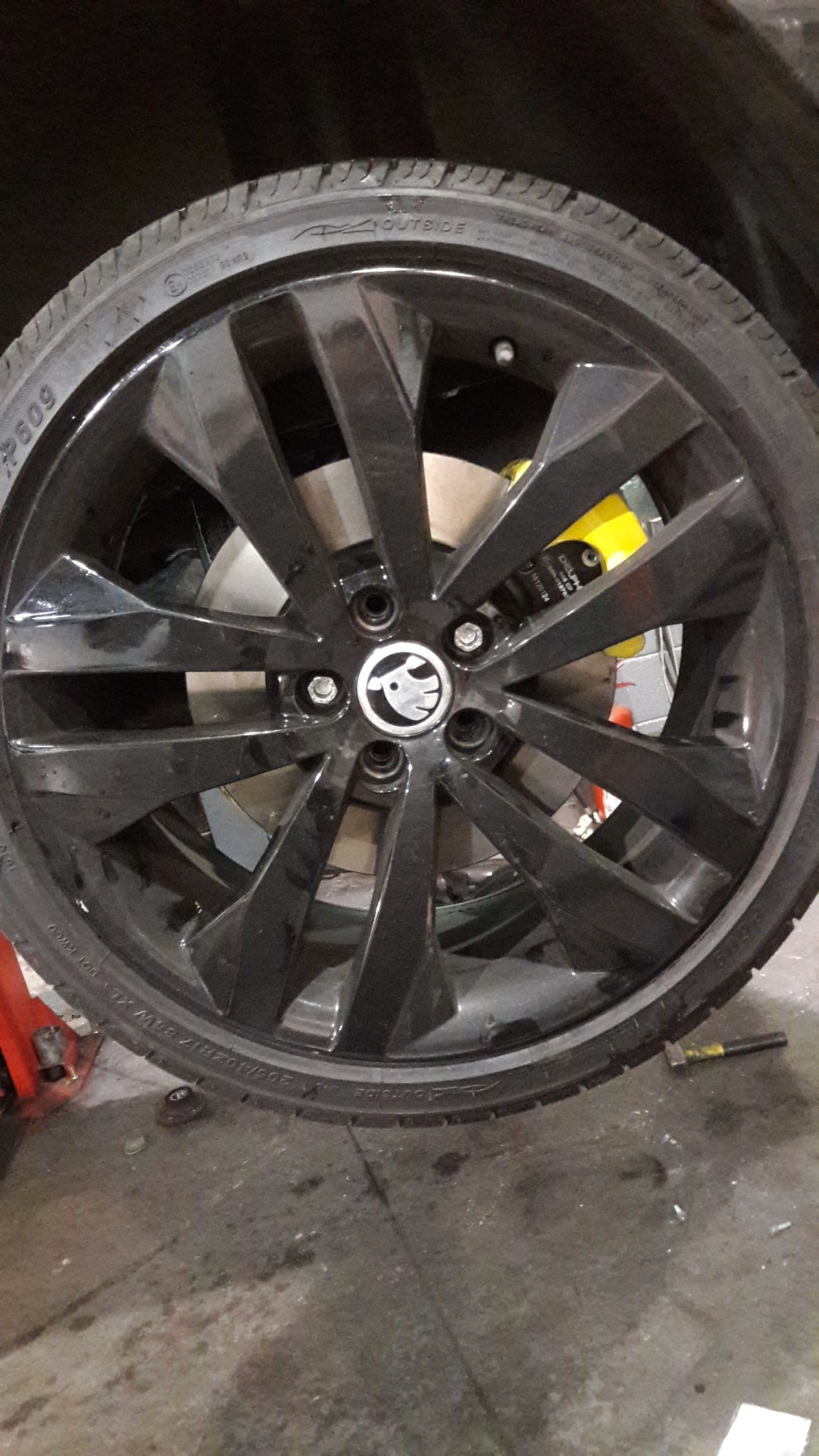

Well so far I have lowered it on h and r springs 40mm fitted a rear arb whiteline that I had powder coated yellow to match , fit a seat ibiza rear disc brake axle and 10mm front spacers and 312mm front brakes .

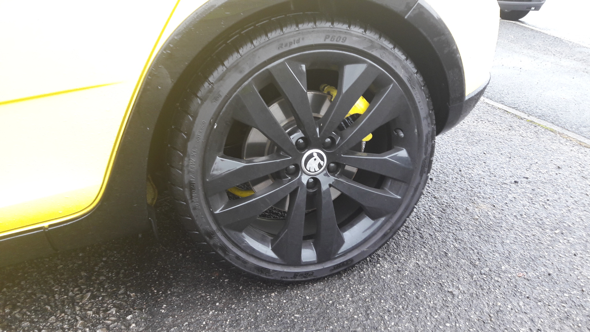

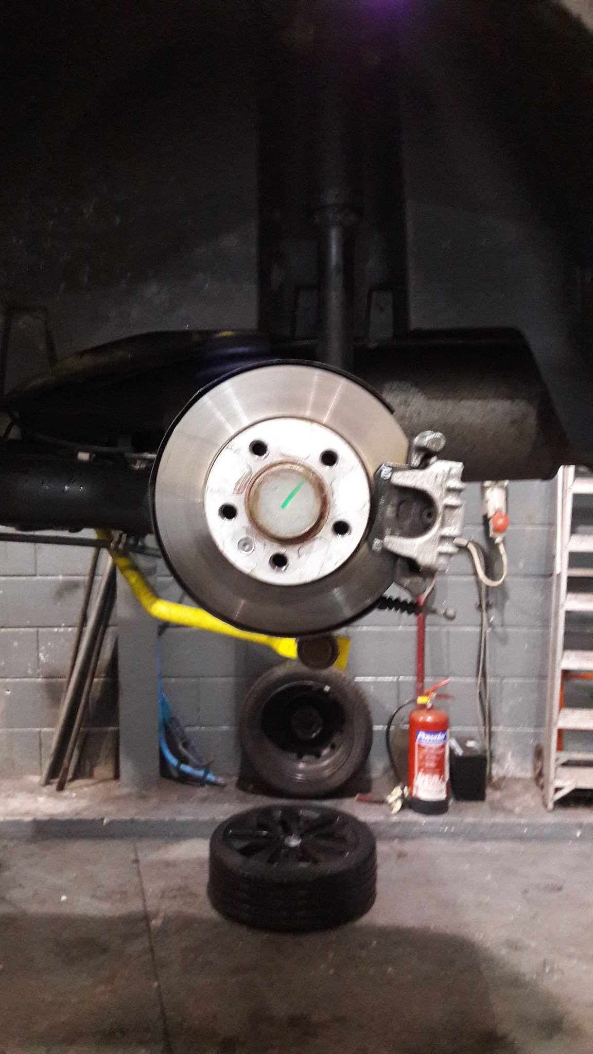

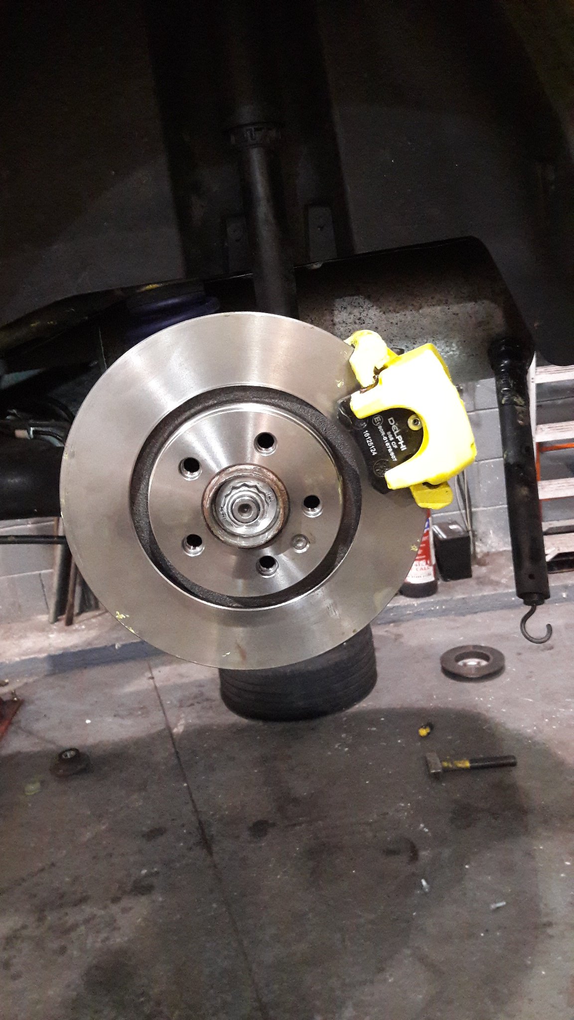

Recently just done a 280mm rear vented discs conversion more for looks than anything else tbh. Used 4wd 256 calipers and carriers and an adaptor kit link here
https://www.bolt-action.nl/product/vw-mk4-280mm-rear-brake-adapter-kit-r32-s3/
You need 4wd calipers and carriers s3 or audi tt from the rear and 280mm vented front discs from a mk 4 golf tdi
Just need to paint my 312mm front to match now

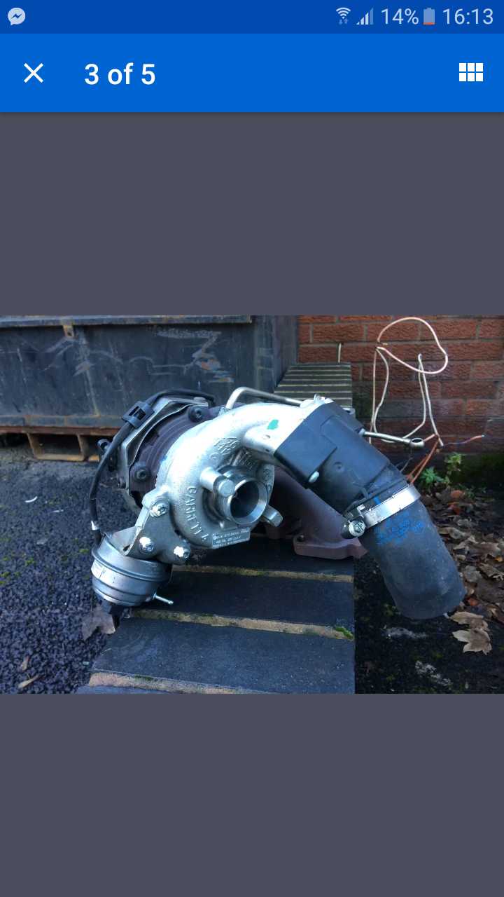

Also won a 2.0 tdi 170 turbo low miles which will be going on in the future
Great choice on the rear brakes, they look perfect :thumbup:

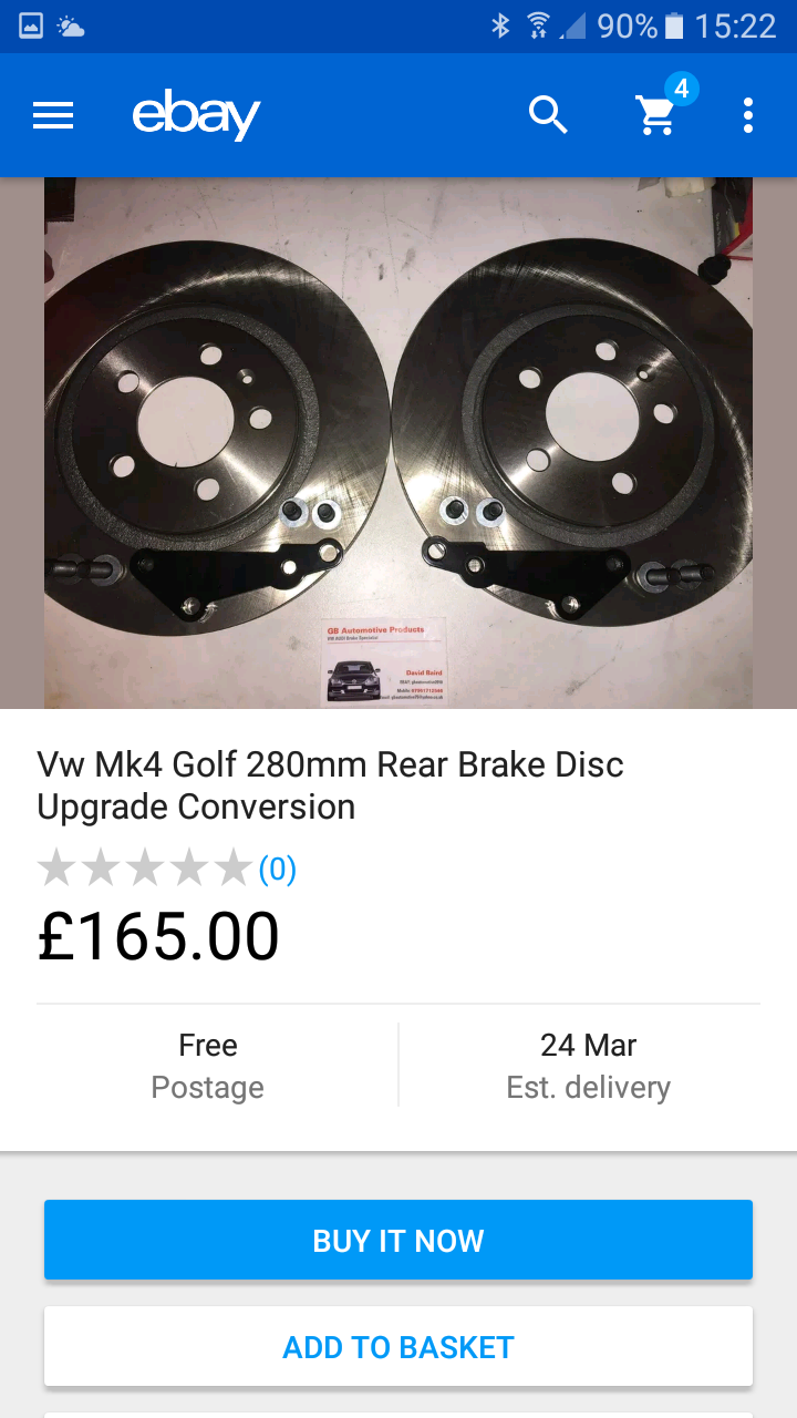

Yes you need 4wd ones but there is a kit for 2wd set ups on eBay
Sounds interesting, got a link to them?
Won't let me paste for some reason so here's a pic
is this a direct fit if running 256mm vented rears off octavia?
The above kit yes bud

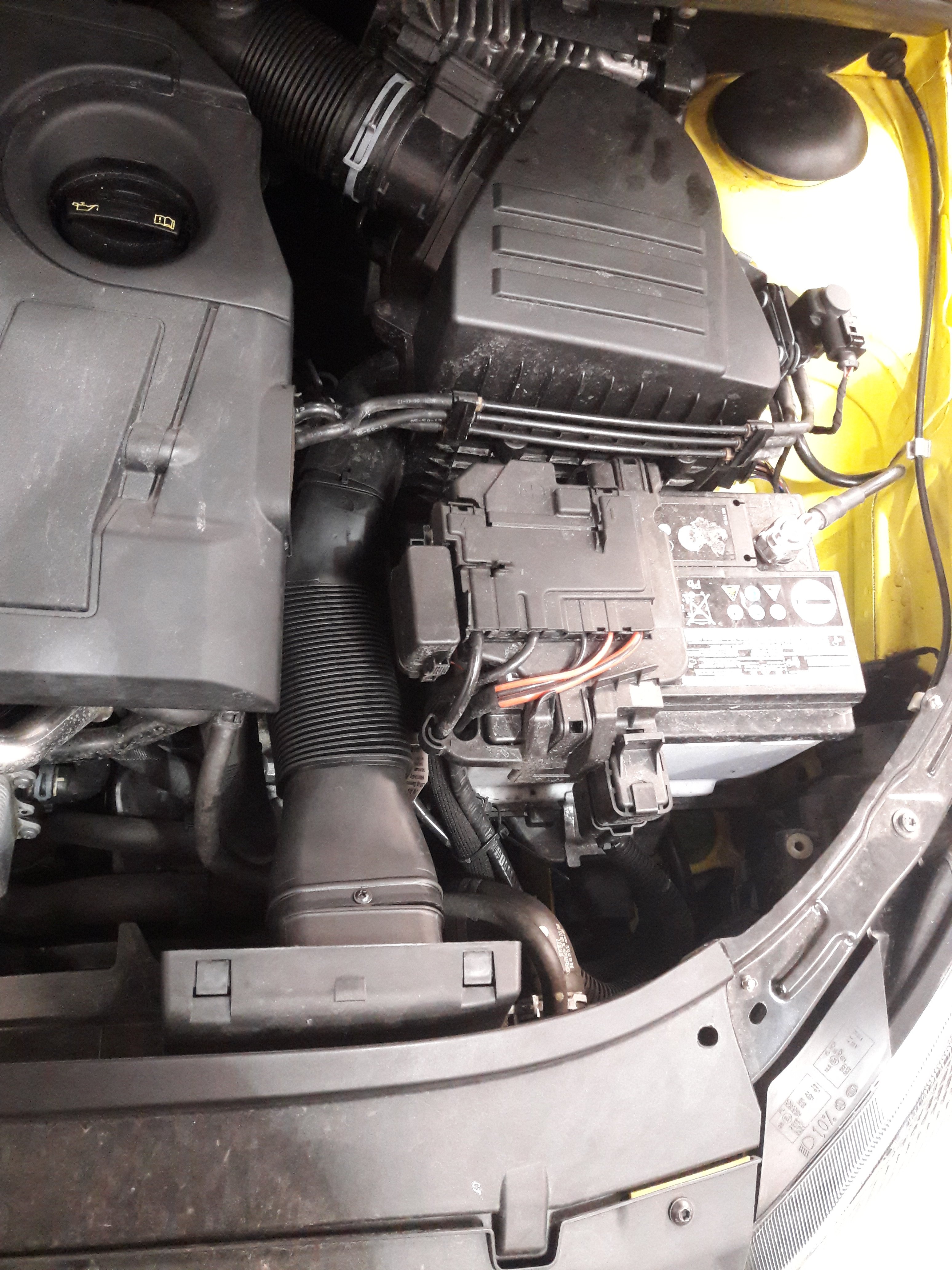

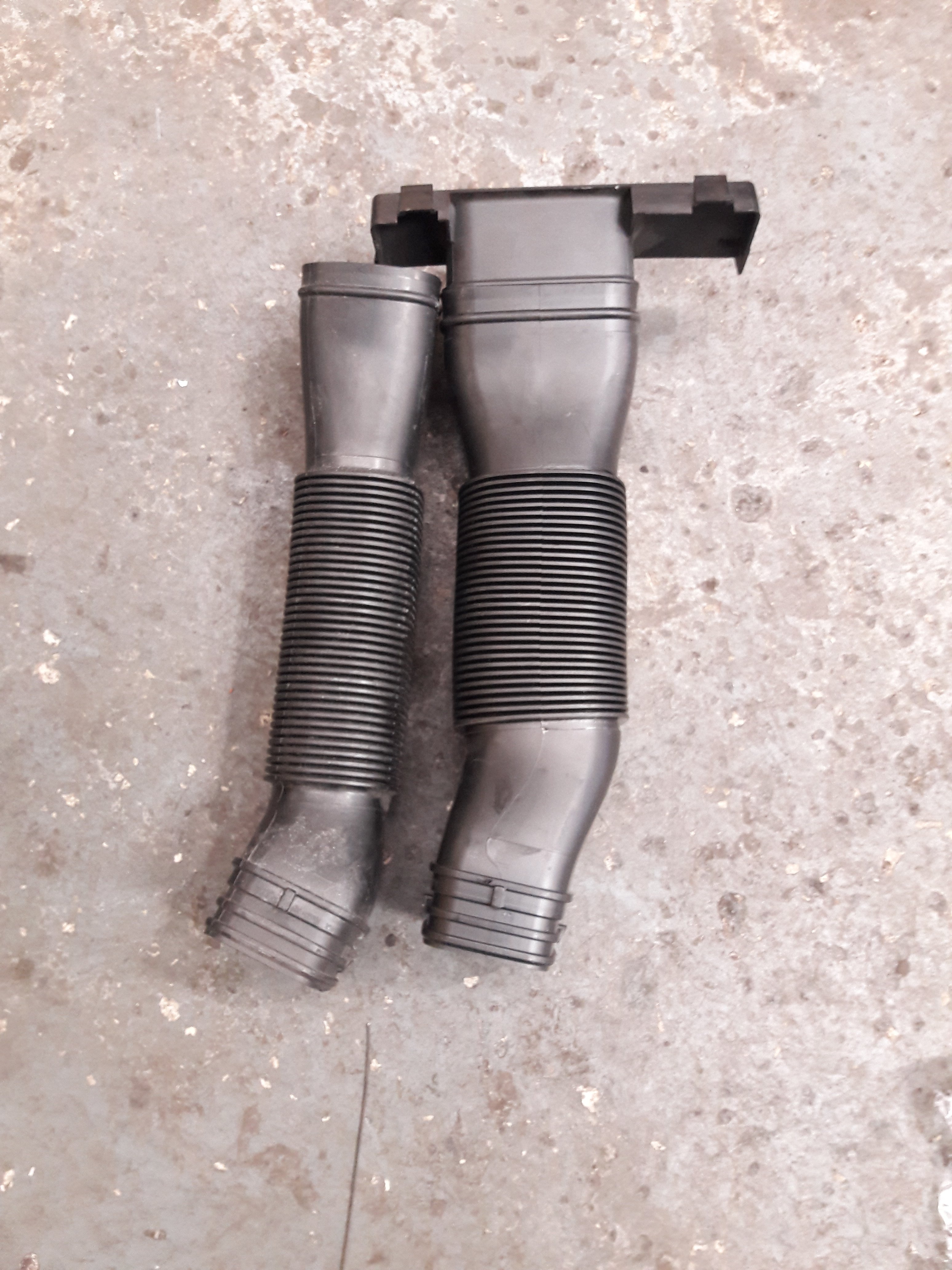

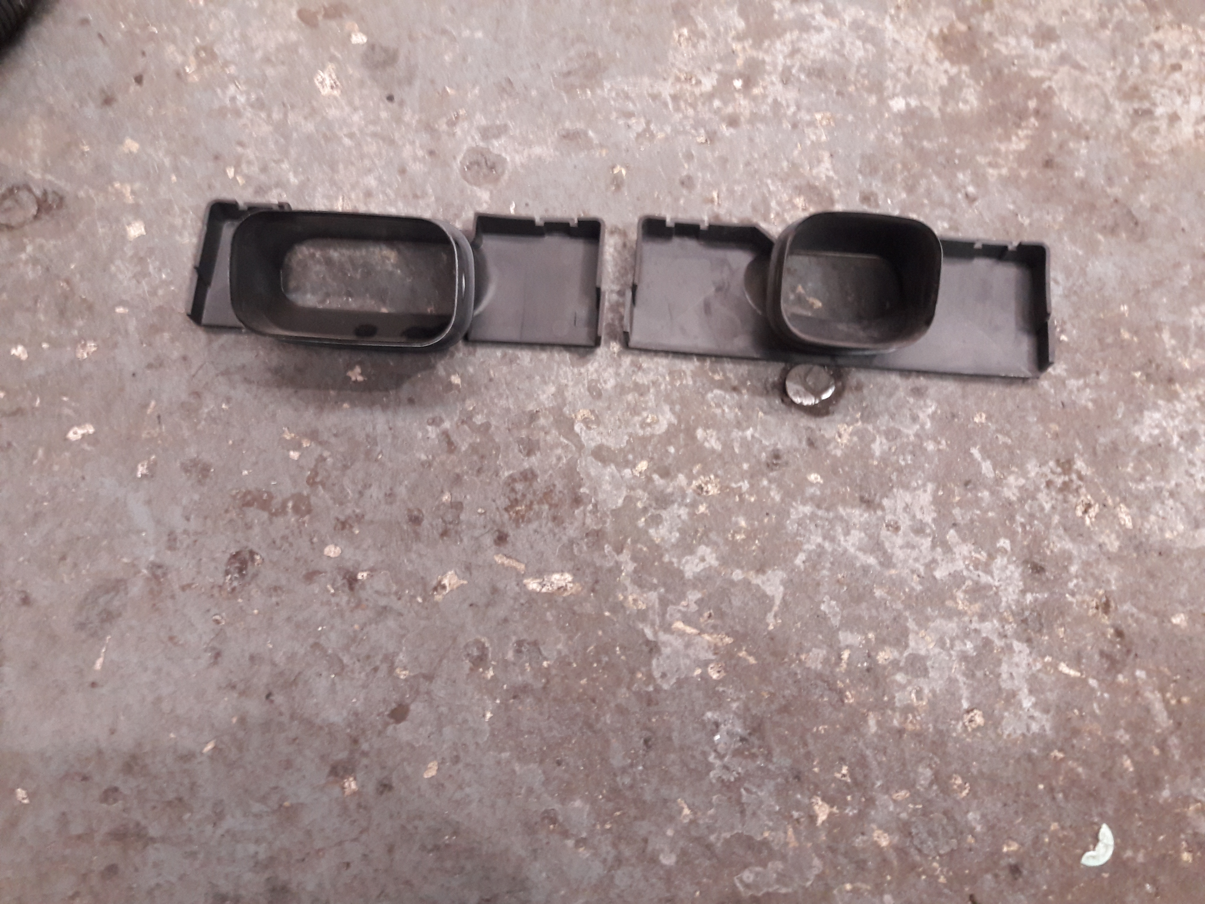

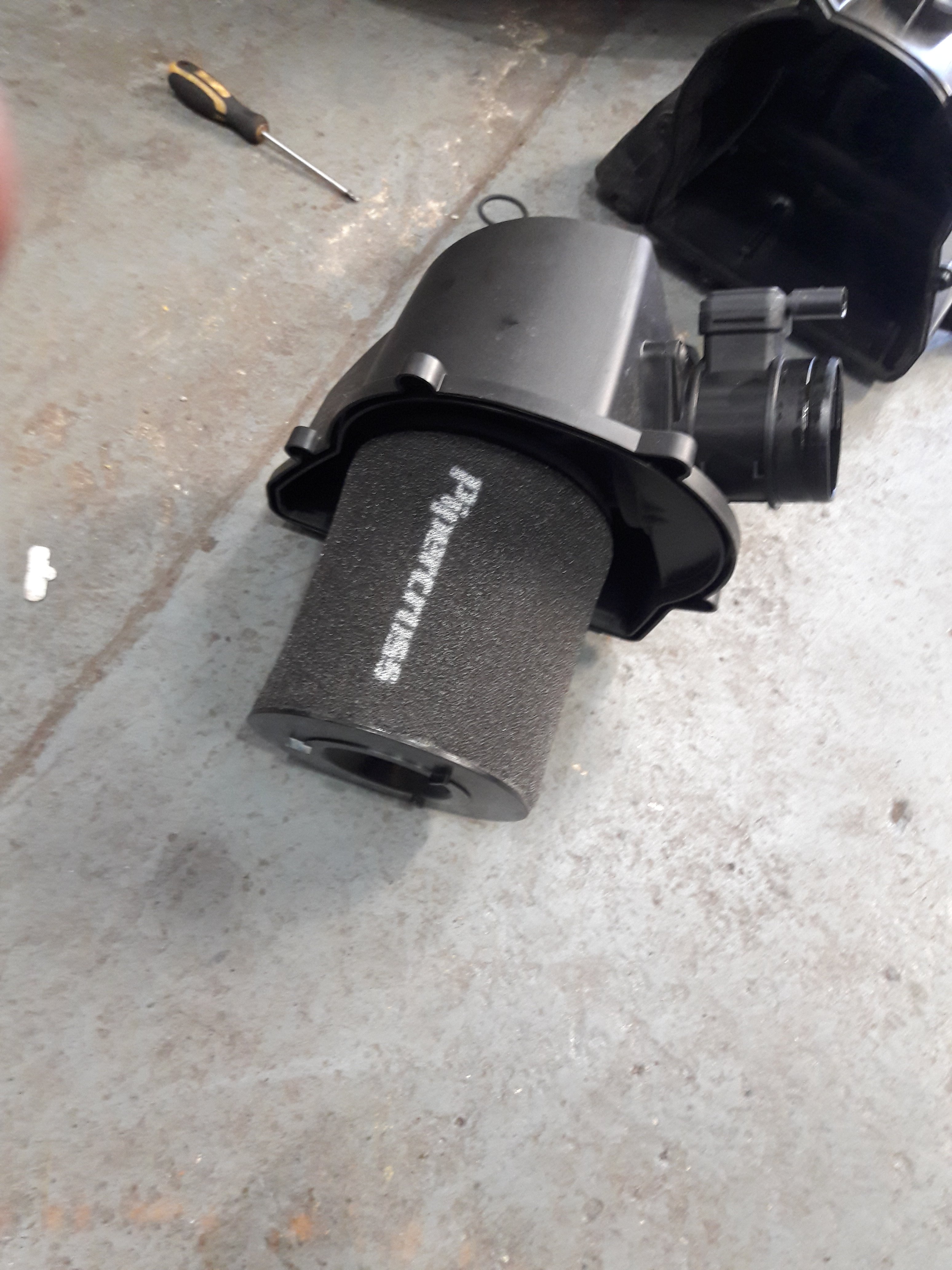

So recently I fitted the vrs intake and a pipercross panel filter the size difference is alot can only help also gutted the inside of the air box, it's a tight fit near the coolant pipes but if u move the coolant Pipe clips round it helps
13 hours ago, Madmilligan said:
Interesting, I've been looking at the K&N filter box replacement but thought it needed a bigger intake as well, looks like this would be the solution. Was the VRS intake expensive?
It was 15 pounds from dealer for intake and bit for front panel I'm looking at a vrs bottom of the air box so it fits into it better as a different angle I'll let u know how that goes
