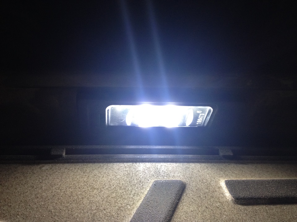

Thats great thnaks, should have added....I have x2 bulbs left over from the Sportage that fit and light up (decent Samsung Cree LED) actually fitted them last night and hooked up Carista which unfortunately has no option to activate LED licence plate adaptations! I will email the guide to Carista and see if they would be willing to add it into the app (I'm on their beta program!)

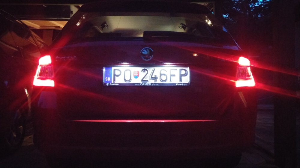

I have the original 2016 F3 LED license plate light, and even though I had to change the encoding of faulty bulb. but it glows beautifully
sorry fot my english

Result:
original skoda led 000052110. Retrofitted on my Fabia.

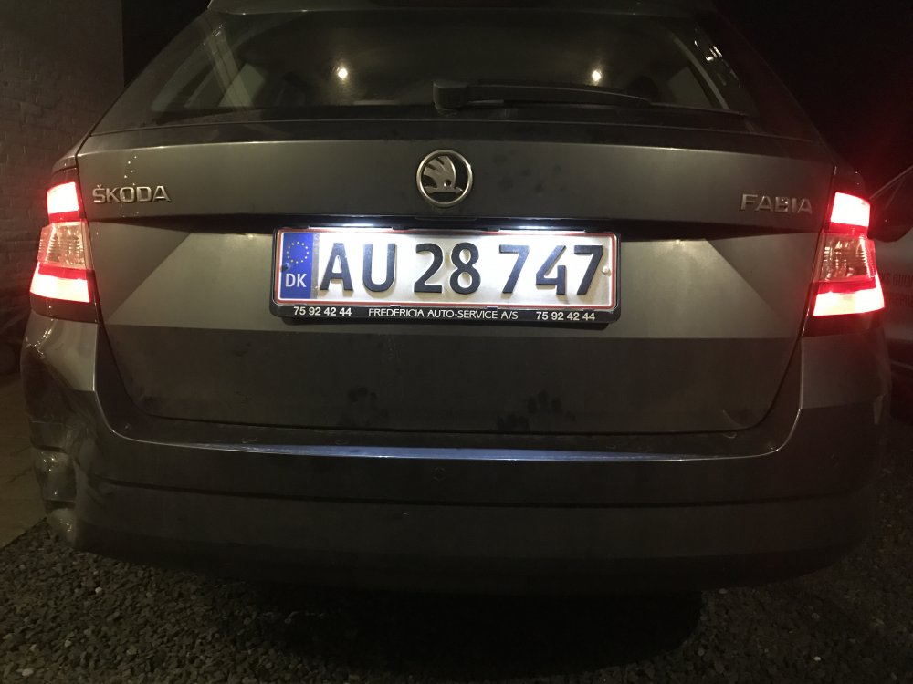

My Colour Edition has them too
There is some light from the wall behind me. So not the best pic
