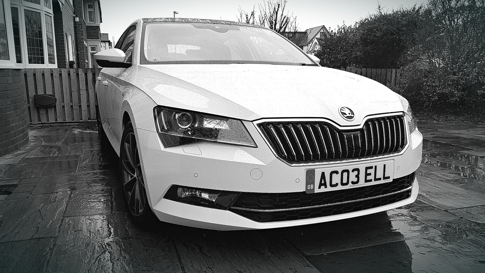

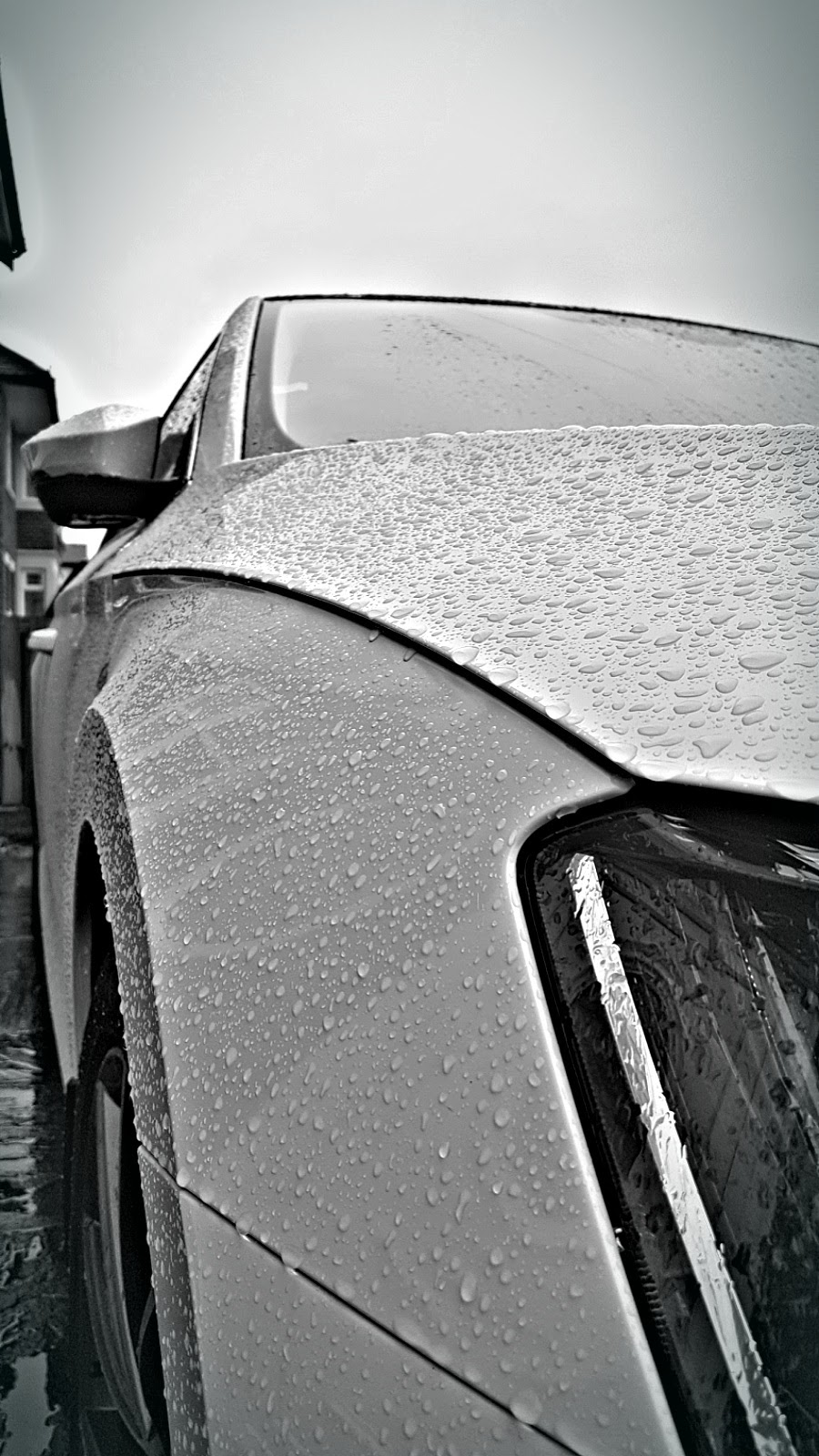

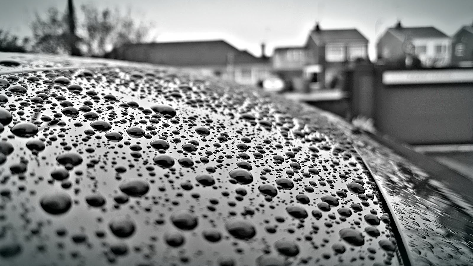

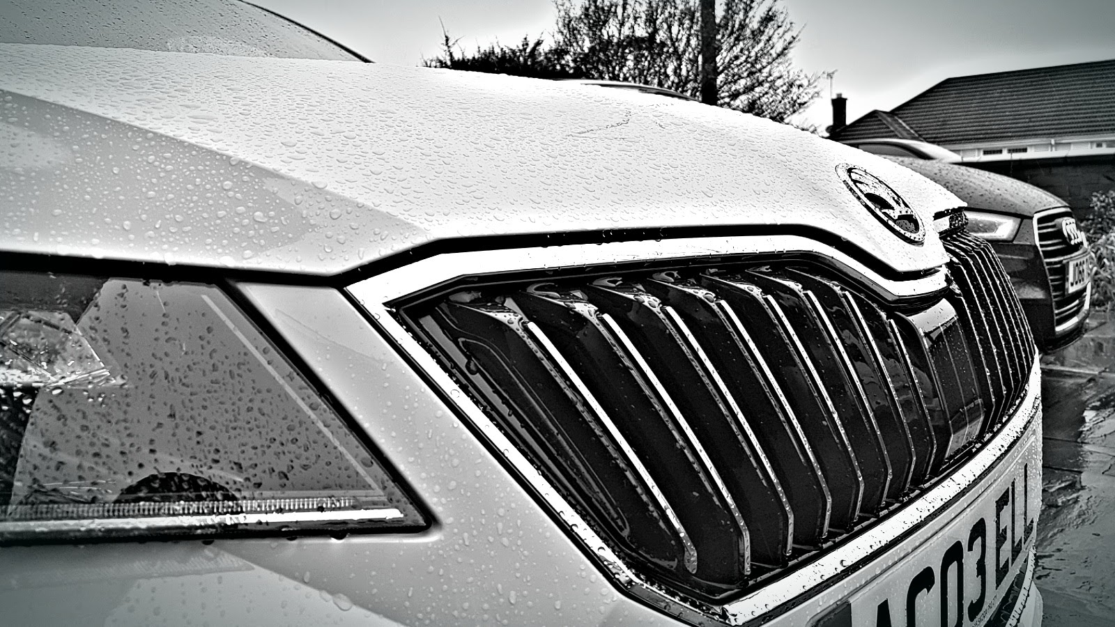

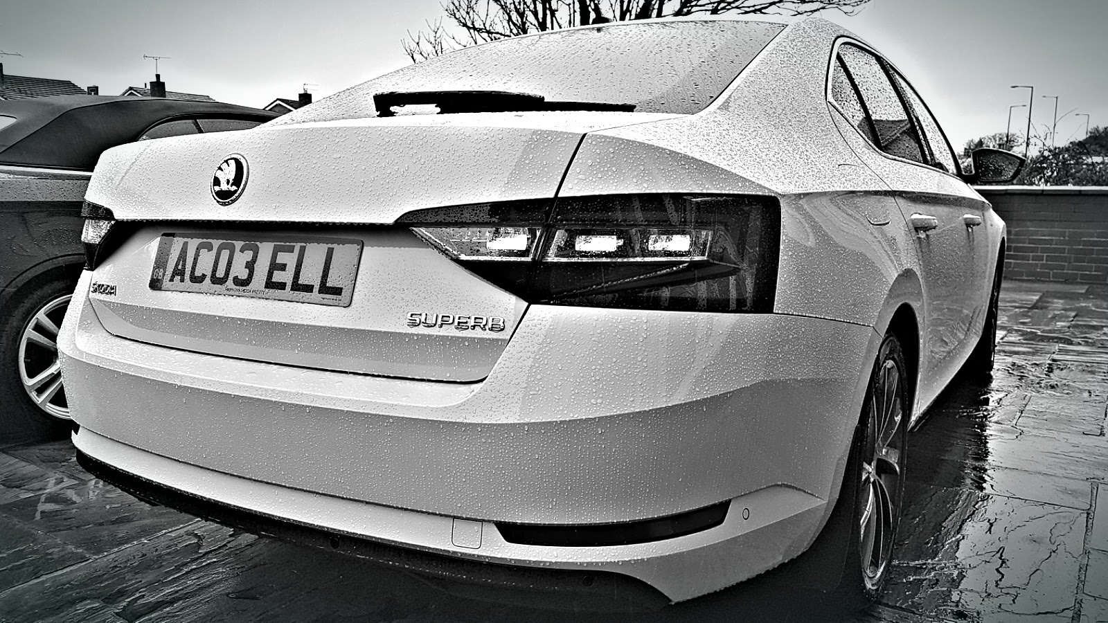

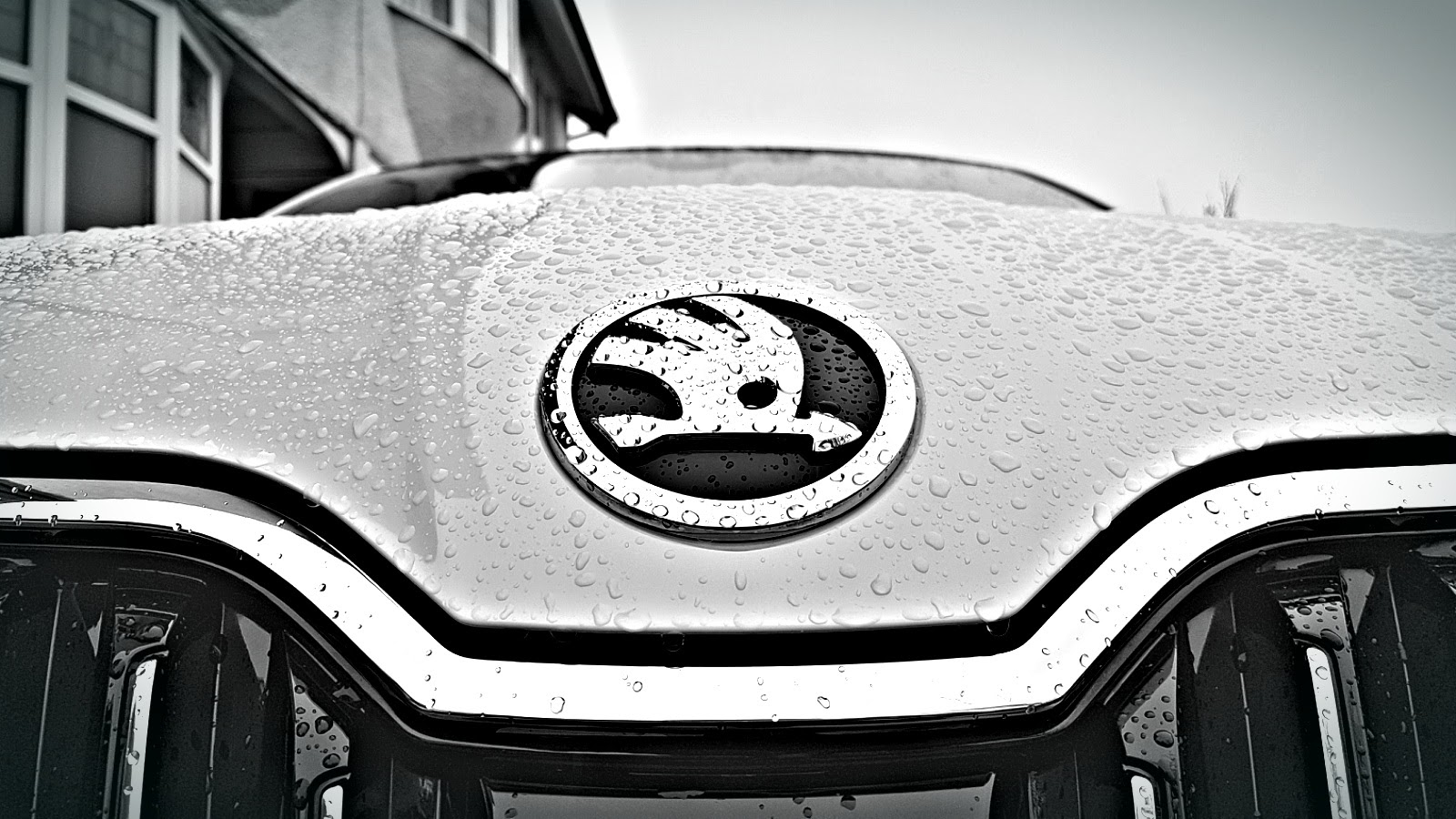

I have attached some photos from after this weekend's wash (I think greyscale shows off detail better ;)). It started to rain as I was rinsing so didn't need to dry, and it shows off the NXT Gen beading :)
Cheers, Drew
