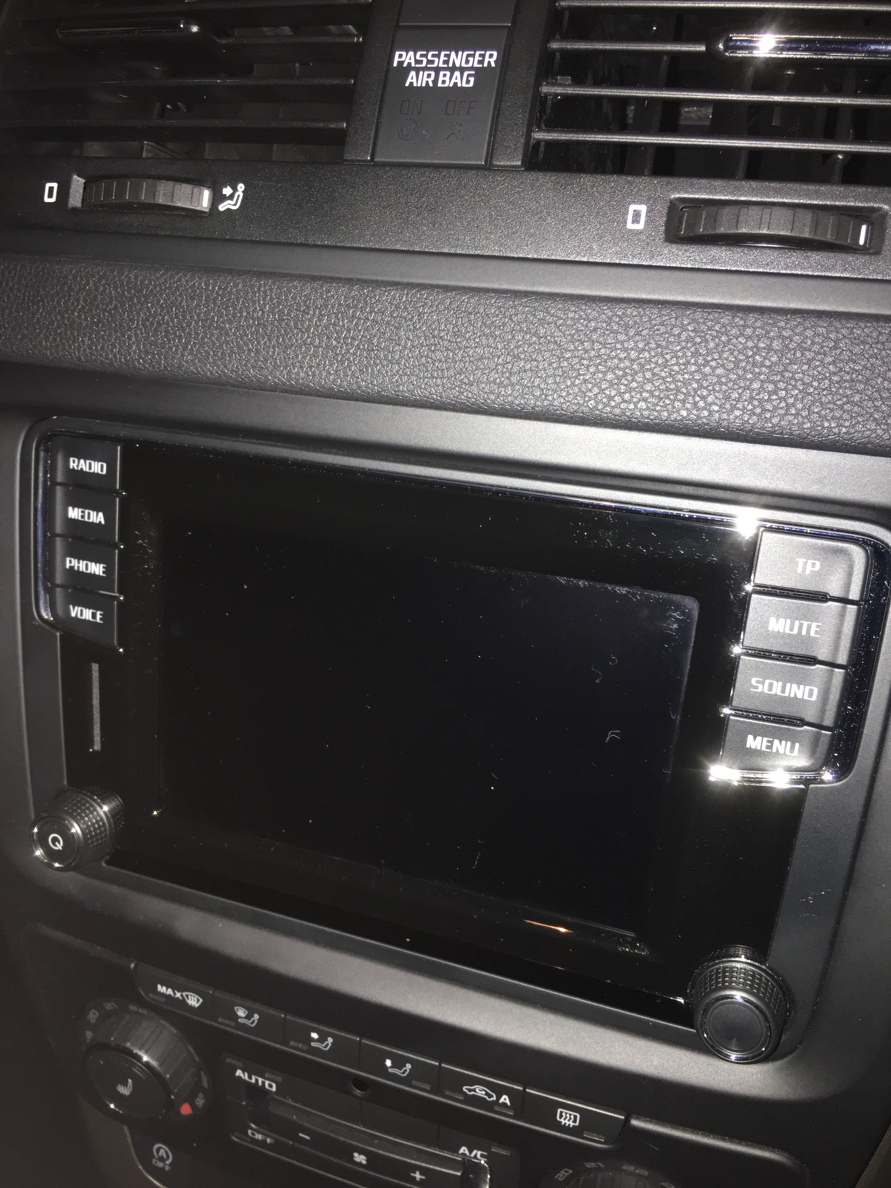

It's a 2015 Yeti TDi (150) SE L DSG.
2015 could well be the new MIB version. Post a pic of the head unit, or find one on Google which looks like yours.

This is an example of the existing unit.  This week we've had chats with maybe 5 dealers all of whom have said it can only be done via the Kenwood aftermarket unit with subsequent loss of pretty much every steering wheel and OE function there is.

Yep, that's the MIB version. Unfortunately the units are equipped with (or suffer from) Component Protection which means you can't just buy another and install it, it'll just lock itself and become a brick.
You can possibly go for an older unit such as a Columbus or Amundsen + unit from the last generation of cars, with a bit of fiddling they will fit and work, but something such as you currently have is more complicated I'm afraid.

The new Columbus MIB unit won't fit mate. What you have there is a single piece, double din sized head unit connected strainght into the dash. The MIB Columbus unitis a 2 piece affair with just a screen in the place of the unit there, and a second drive unit in the glove box. Fitting one will be a chew to get the drive unit to fit somewhere it's not designed to go, and the display unit is also a different fitting so will need some cobbling to make it fit. Then there's the cost (about £1500 for an unlocked ready to fit unit), then there's the issue of trying to make it work correctly.
However, the older Columbus units are designed for the older generation of cars and need a wiring loom to adapt them to fit, and then some coding to make them (hopefully) work correctly.
You don't state your location, but if you're near North Yorks you're welcome to stop round my place and we'll pop a DAB unit in and see how it fits and works. There's a secondary complication whichever way you go of needing to source a DAB antenna, but that's easy enough to find a way round if we can get past the other issues.
