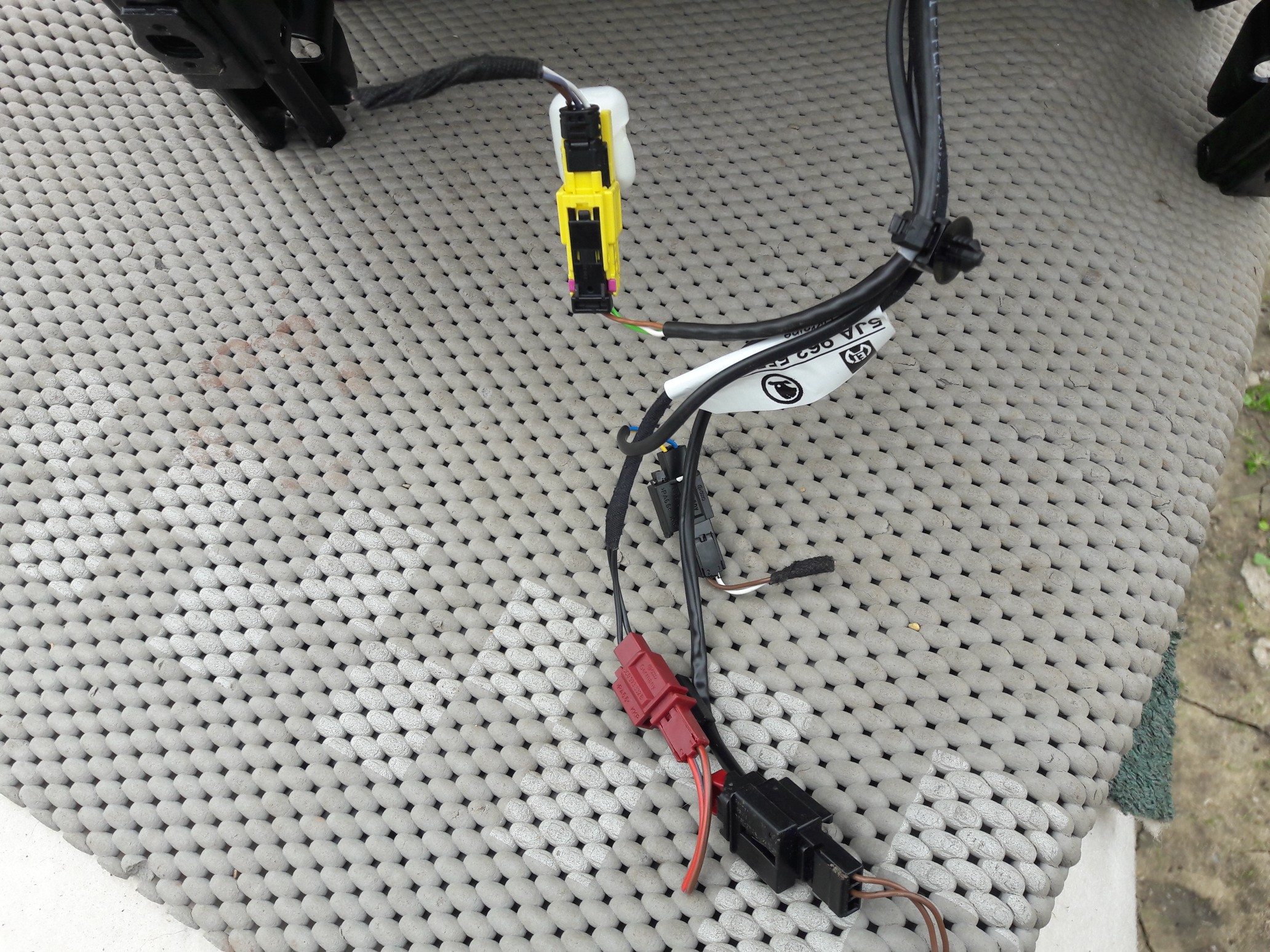

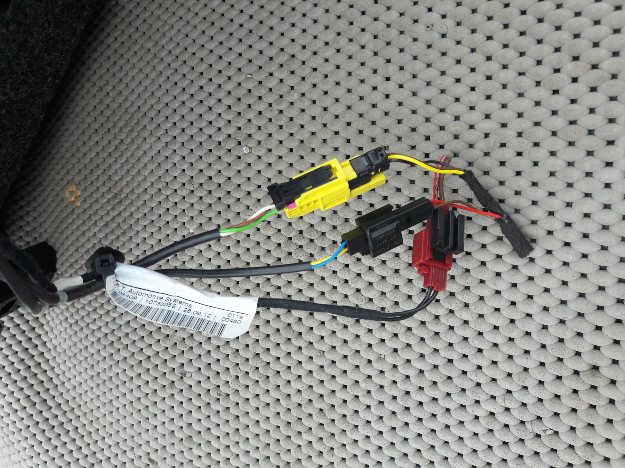

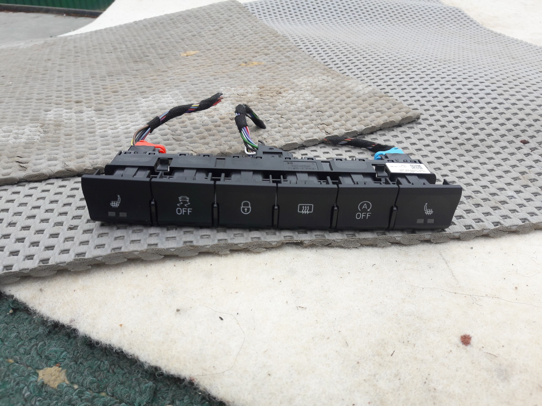

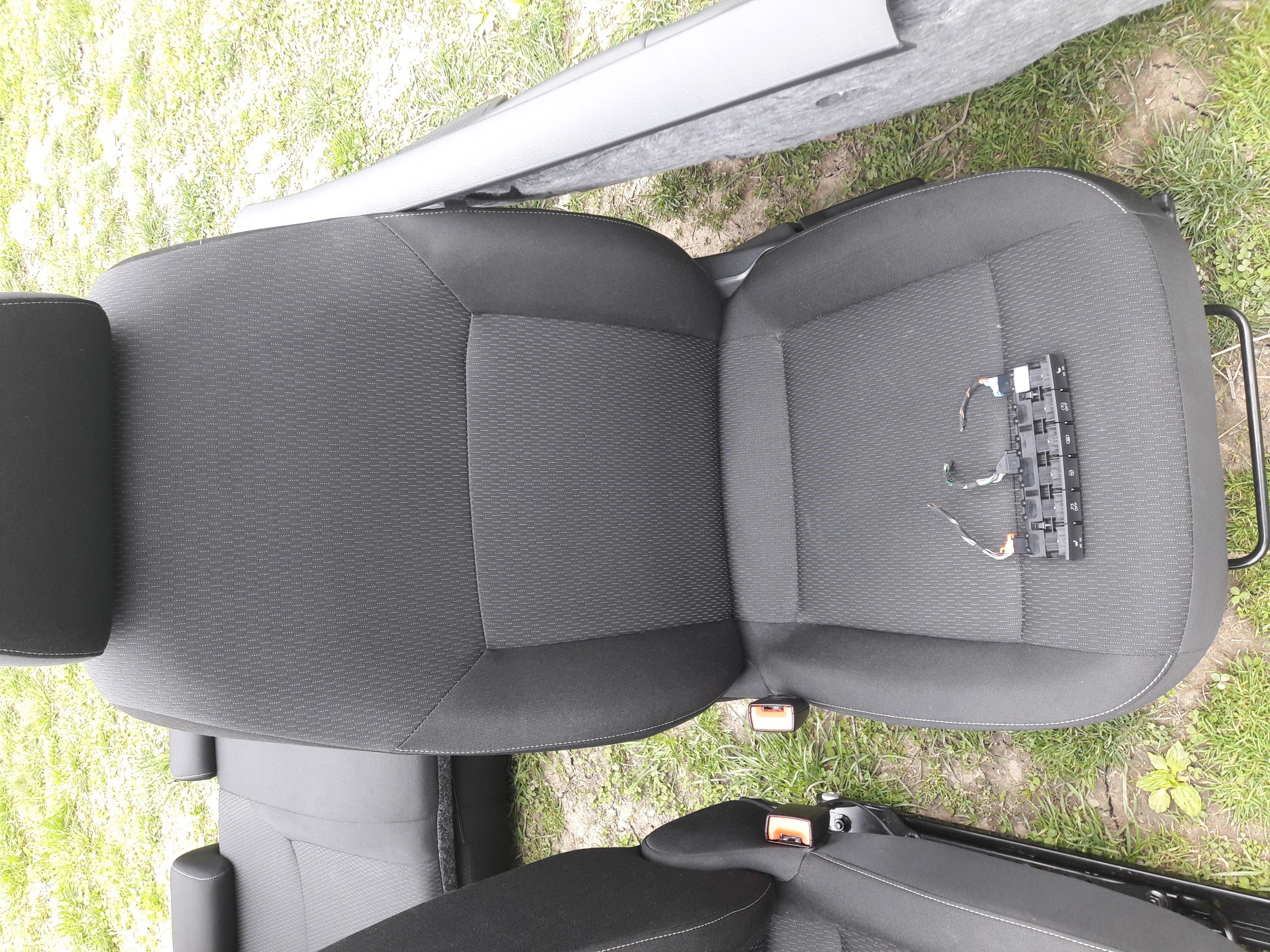

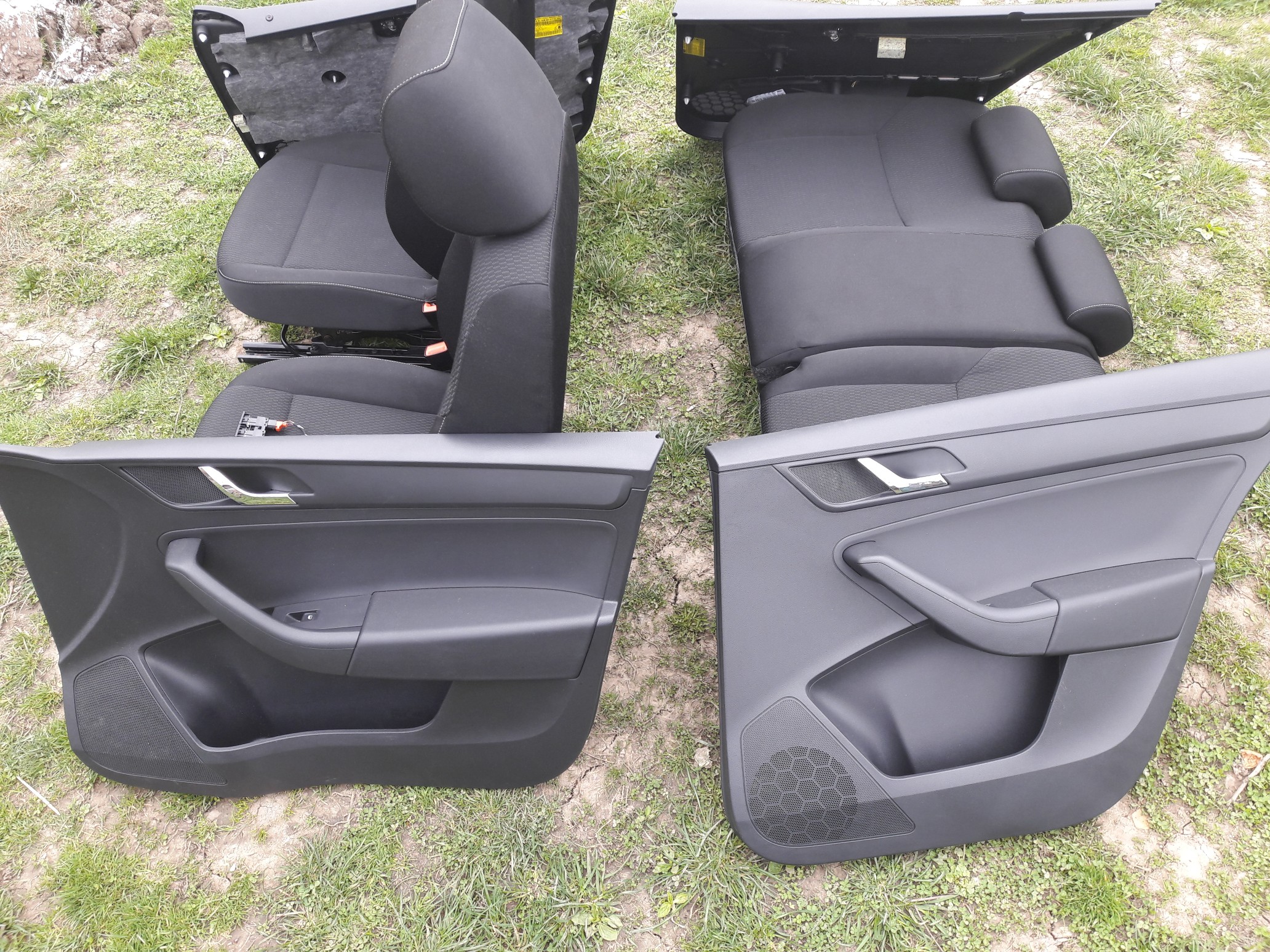

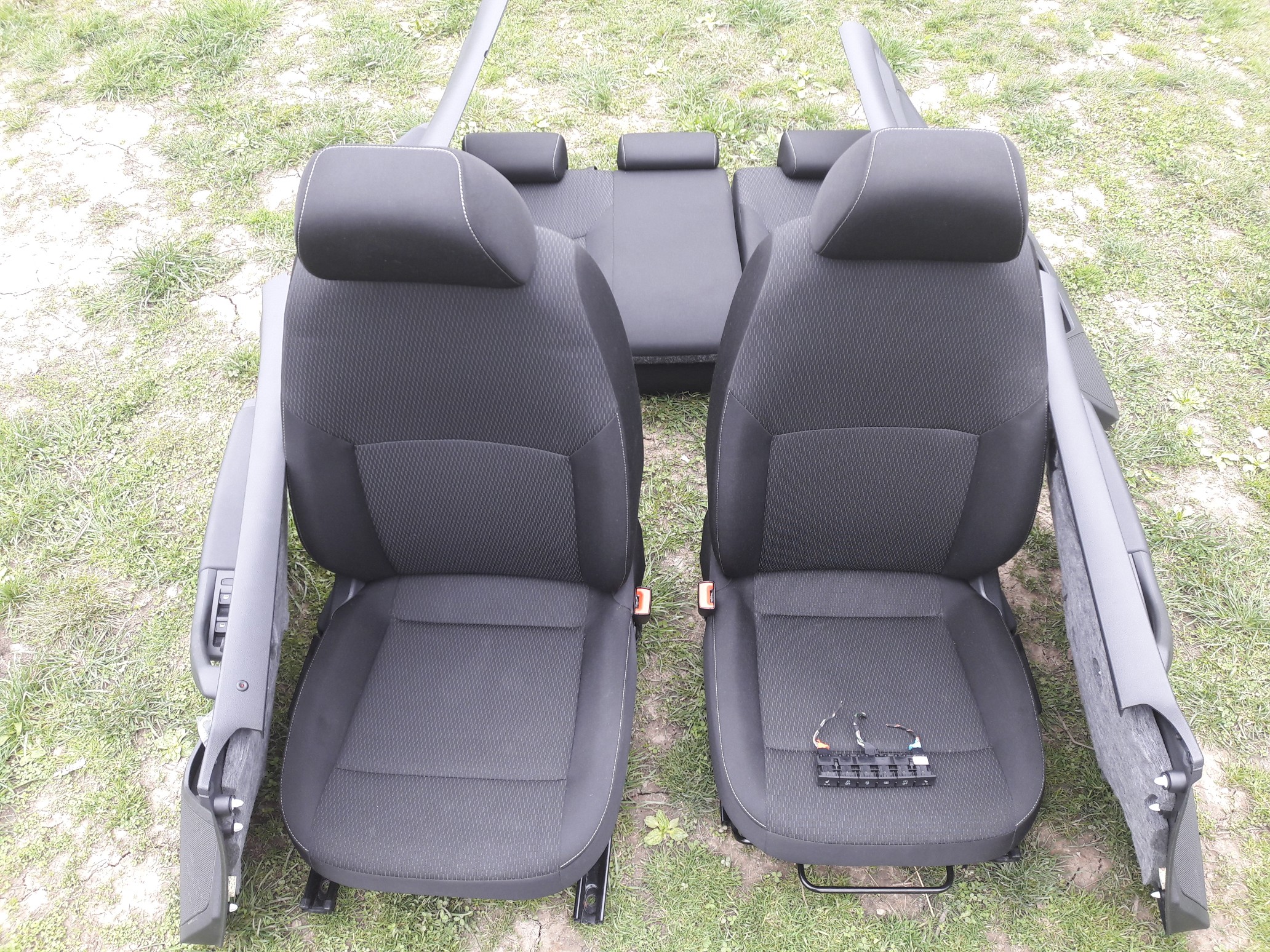

Hey @stargixxer , if you are interested i'm selling skoda rapid interior with front heated seats + module for commands and some other stuff , like door panels ,
Selling them because i made upgrade with Sport seats interior with heated .
