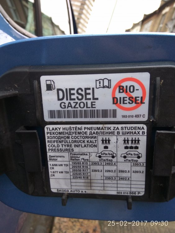

Hi Guys,
Could someone help me to identify the correct specified tyre pressure for my car. My current tyres in the car is 215/45 17 91Y. I have checked the fuel flap and it seems correct pressure should be 32psi all around..but in manual it says "The tyre pressure should be at the highest pressure specified for your vehicle at all times." Please see the pic below and let me know what pressure is manual recommending me.

37psi! Is it not too high..most of the time I am the only one person who is in the car. And on flap says 2.2bar..but manual says to keep the highest lavel..so that's why I was thinking what would be recommended one for me.
The diagrams on the flap are saying that if there are 3 people (or less) and 1 case (or less) then run at 2.2bar (32psi) all round, but if there are more than that (up to 5 people and 3 cases which is maximum load) then run at 2.5bar (36psi) front and 3.2bar (46psi) rear.
So for you that means run at 2.2 bar (32psi) all round, unless you're a hypermiler.
Remember the manual covers all variants, engines, etc. so it's guidance is very general, and in situations like this the sticker on the vehicle should be followed.

That's what I thought as well. But I already put 37psi for the rear and 37.5ppsi for the front..I think I have to re do to 32psi all around then..most of the time boot is empty and me alone is in the car.

Decided to go for 32psi..but now at the moment i have 37psi for the rear tyres and 37.5 for the front tyres which i want to keep on.
You have "non-official" sized tyres fitted to your car I think.
The difference between 215/45 R17 & 225/45 R17(official size)  is around 1.5% accuracy on the speedo. (your speedo will read higher)
As you have some other problems with your car (and 1-odd tyre) you could request that Cargiant fit the correct tyres to your car?

Do you actually have that tyre size fitted? Non- standard size according to the filler cap- so you will need to extrapolate a pressure based on that data. Fitting a standard sized set of tyres and flogging those you have may be a better idea if the dealer will not cooperate. 2.2bar seems the best pressure for a non fully loaded car until then.
