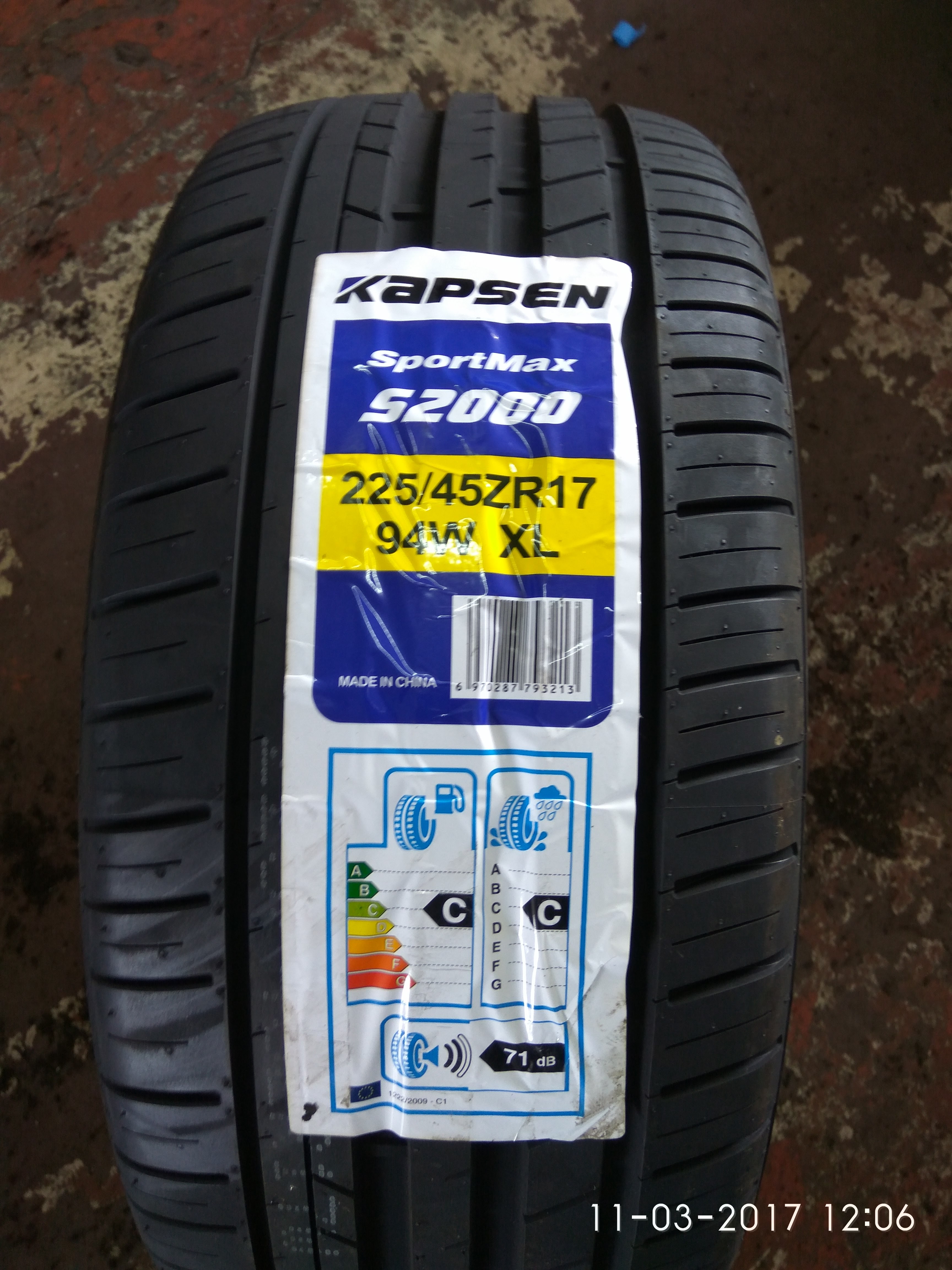

5. Changing the tyres: 3 Michelins old 5 to 8years and tread depth 4mm,4.5mm, 5mm, 1hankook 2015 tread depth is 6mm. will it be wise to replace all of them and put some kind of brand new  budget tyres like Autogrip or Midrange Joyroad. I got a deal of £210 for  Autogrip and £220 for Joyroad

No one had patient to read my post as it appears to be to demanding, isn't it? well, I will highly appreciate if anyone bothers to share their upgrade with me. btw, I have changed the tyres today.
4brand new with C rating for both energy efficiency and wet grip, 71dB , 94W xl
sounds like a downgrade on the tyres, wait until its wet and you will slide all over the place.

Ok I'll go first. Budget tyres are not an upgrade.
they are not budget tyre that I put now..Midrange tyres..and even their specifications are better than the tyres I had before.
Ok. You asked about fitting unknown brand budget tyres and then didn't fit them. Mid range tyres aren't an 'upgrade' either (ie better than standard original fitment).

Have you also now fitted the correct size of tyres as per the filler cap?
Yes.. They are 225/45 17
Which tyre brand/type did you fit eventually?  And what tyre pressure have you used (as per another thread)
I have put 32psi all around and below is the Picture of the name and specification of tyres.

Now about tyres: I wish if I could go for branded tyres like Michelin, Dunlop, Goodyear etc. but those would cost me a fortune where is these sporty and heavy load capacity tyres coasted me just £180 including balancing and fitting. they might not be branded but lets see how they go. even some expensive branded tyres you wouldn't find the wet grip, efficiency match both for C. I am very happy with weight load and speed rating wise as well.
