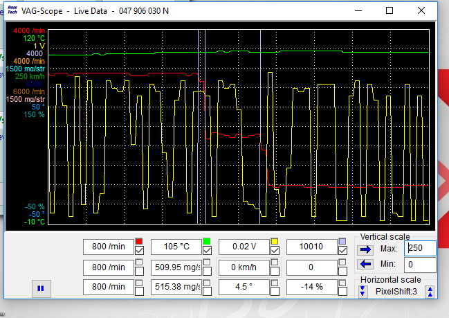

Hi Ricardo,
Please could you have a look on the lambda frequency-please find attached vag measurement. Looks that the frequency is the same at 900 and 3200 rpm. Should the frequency raise with rpm?
Thanks.
The frequency has nothing to do with the RPM of the engine.What is important is the amplitude of the signal varies approximately from 0.1 V to 0.9 V.
