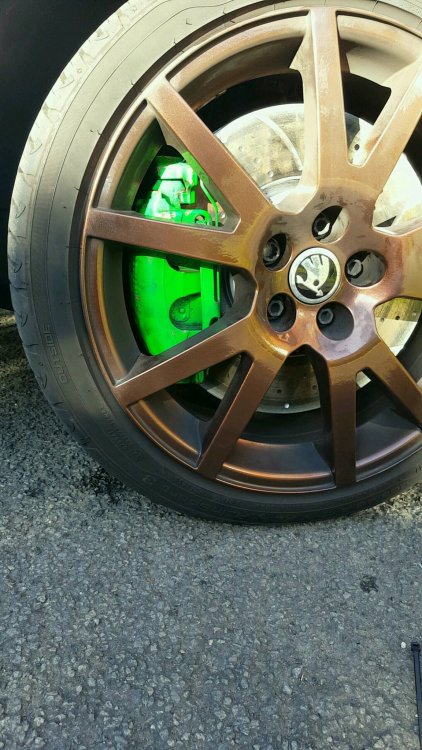

Not the best photo, but just to clarify - MK4 R32 brakes are a direct fit and clear my 17" spiders with no spacers. You will need to use the R32 brake lines though, and it won't fit in the standard bracket so you will need to secure them some other way.

Is that disc the wrong way round?
