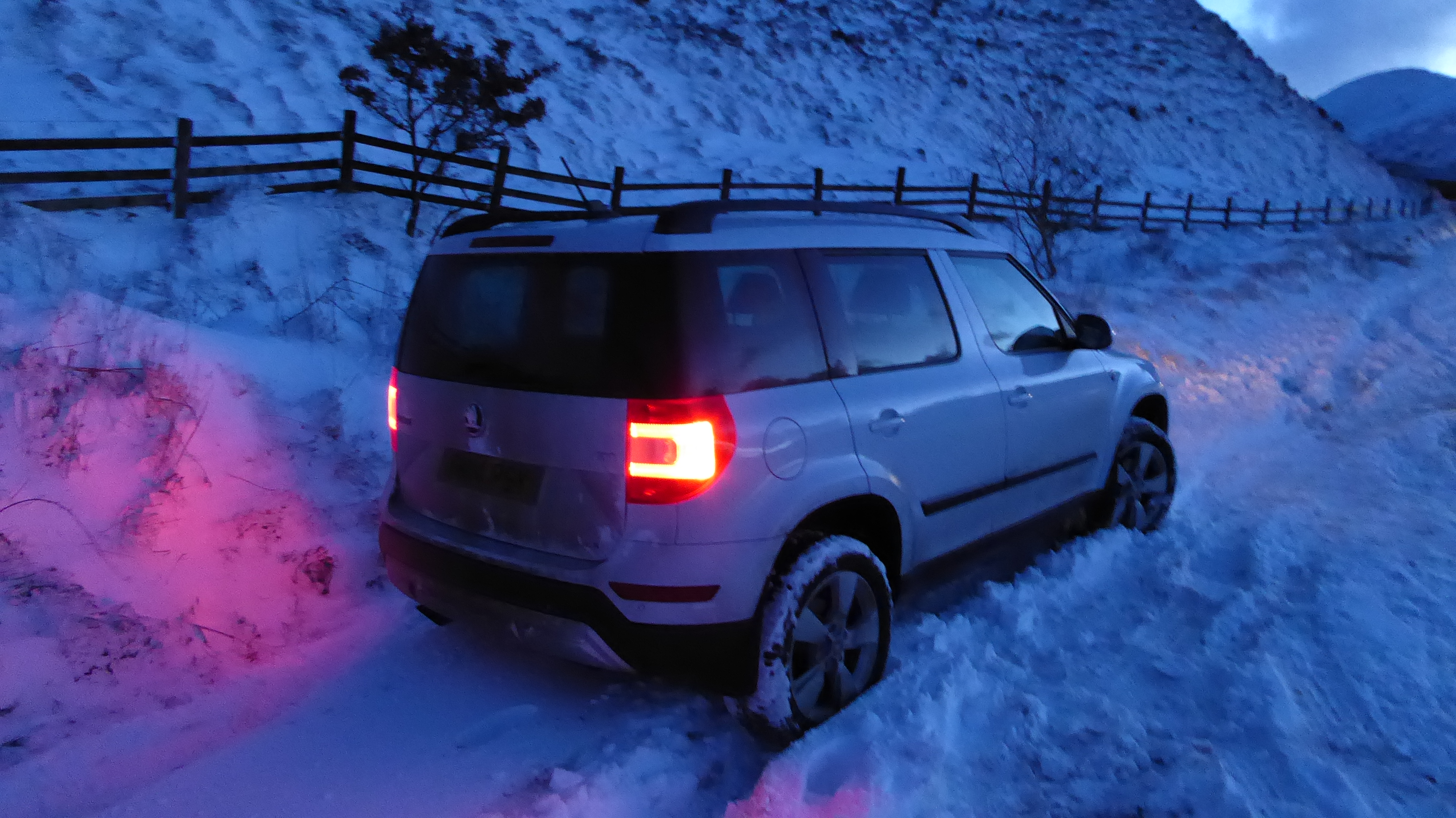

Agreed!
I have Cross Climates on my 4x4 Yeti and they've proved equally as adept in the snow as the 16" winter tyres / steel rims I'd run for the last few winters.
I've now decided to stick with these all year round and have sold the 16" winter tyres / steel rims.
