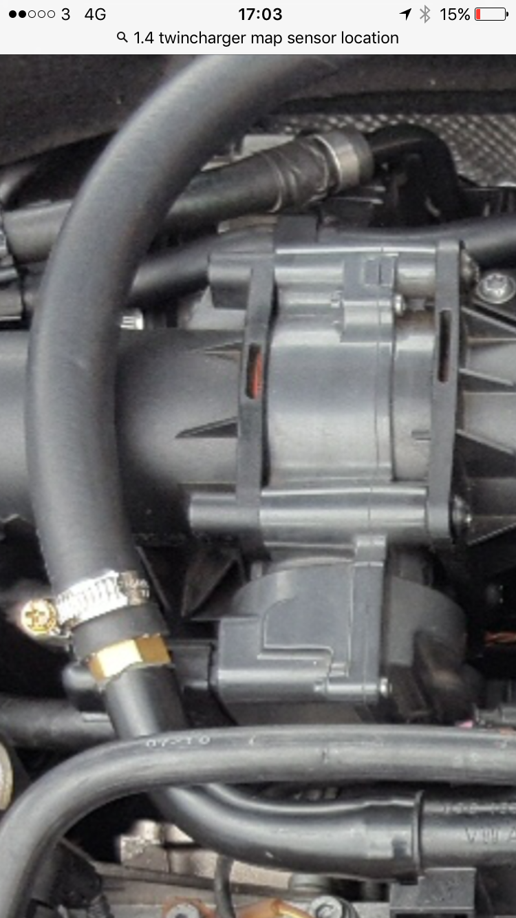

Hey guys, finally got round to ordering and have received a new map sensor but I can't really see where it is, does anyone have a picture or diagram showing it's exact location?
It's on the throttle body I think
& Do not expect to see the pipe with the jubilee clip, that is not OEM.

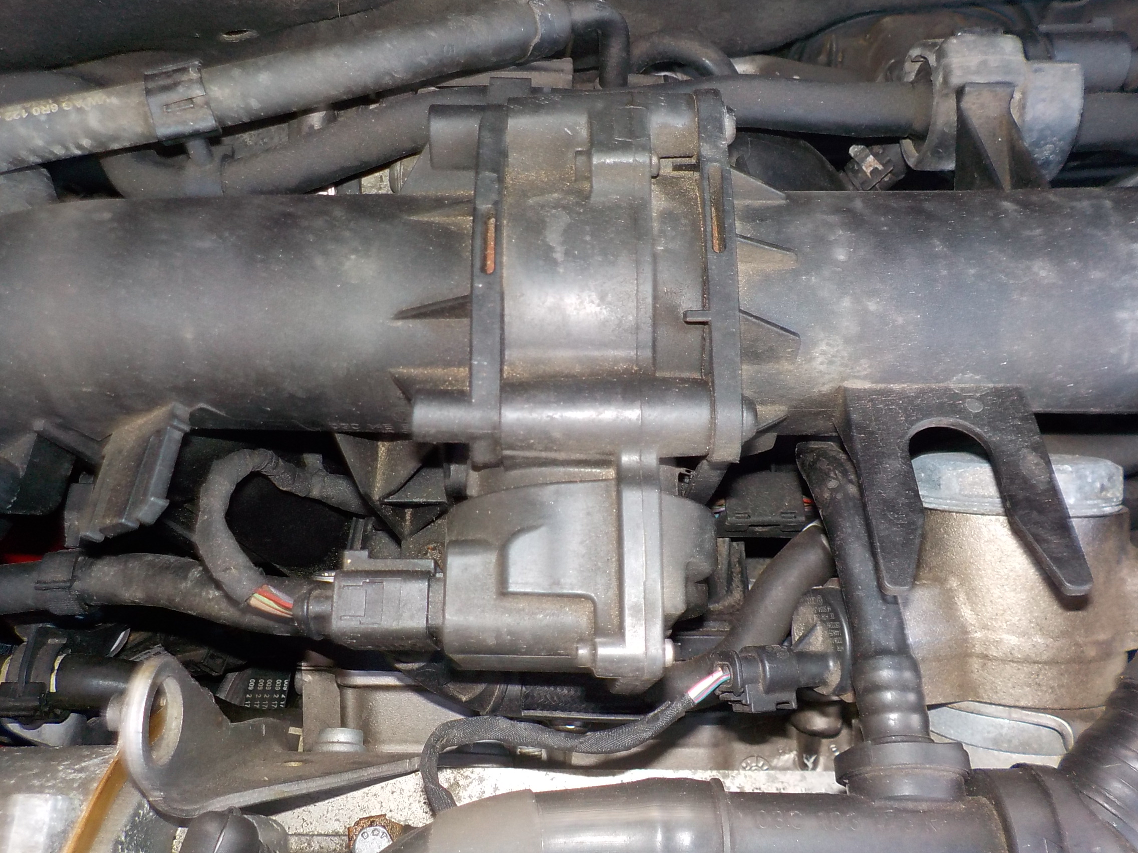

That's the bypass valve for the supercharger, the throttle body is at the back of the engine.
that has to be the throttle body as it goes directly to the turbo if that was closed the turbo would get no fresh air
just had a research and it looks like your right flexi mouse ;)
Edited by thomasaspin
No problem ;)
It is a confusing engine to look at, and has 3 map sensors that can go wrong.
