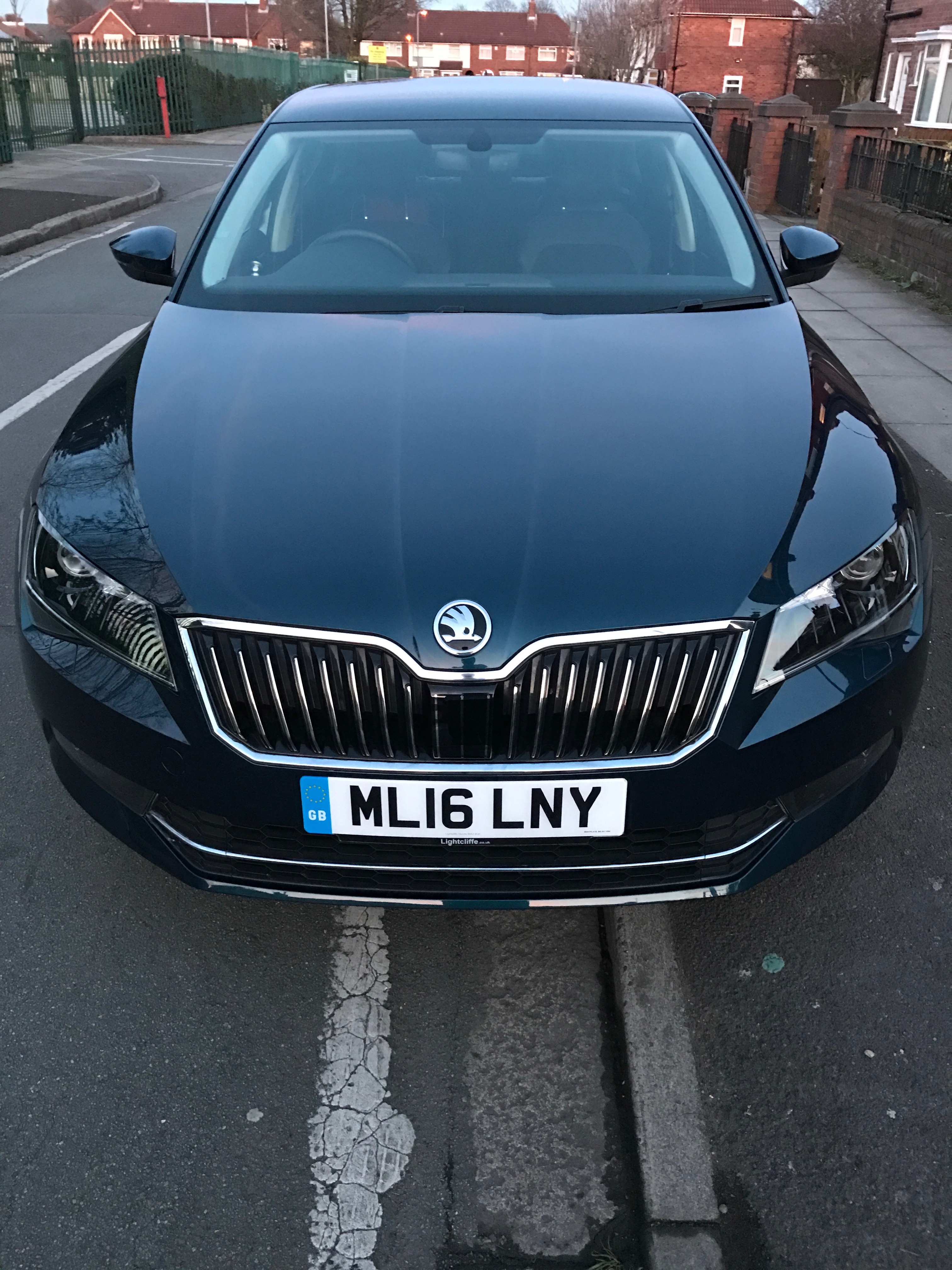

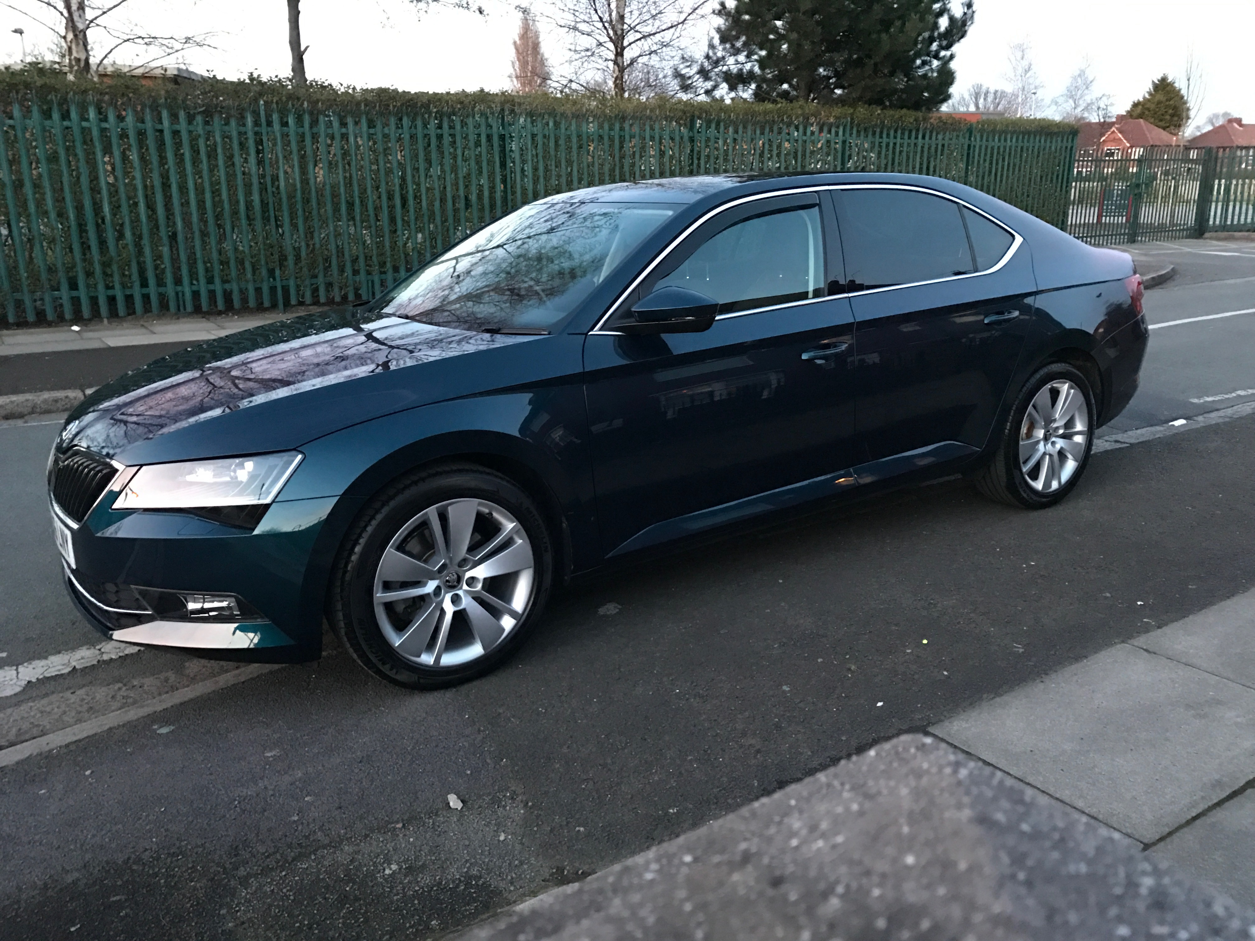

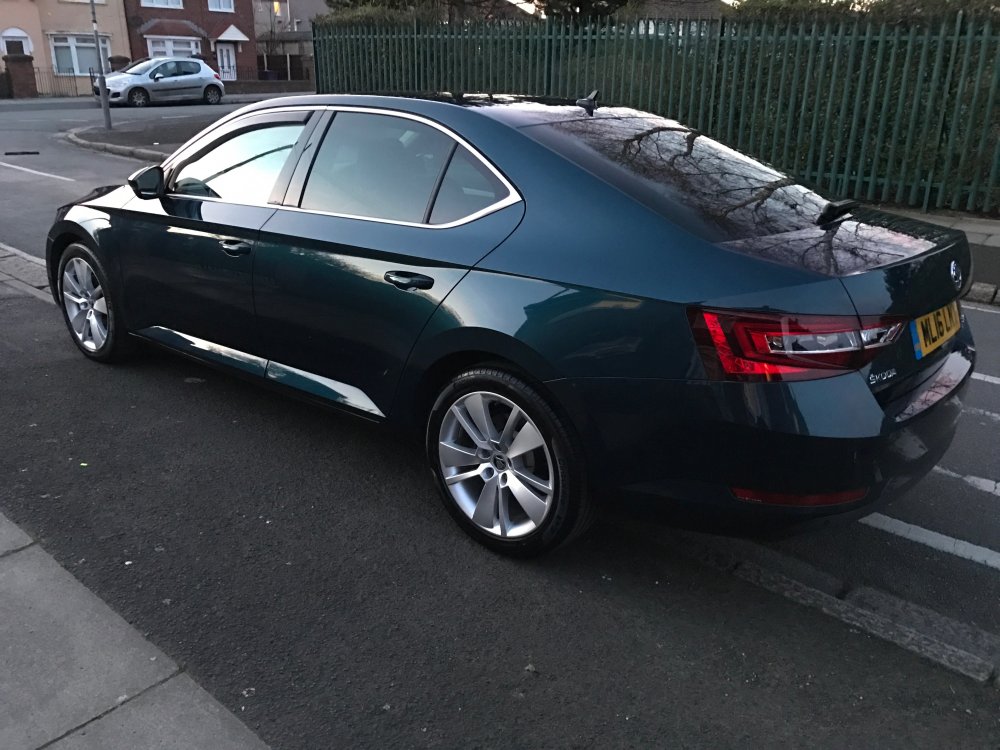

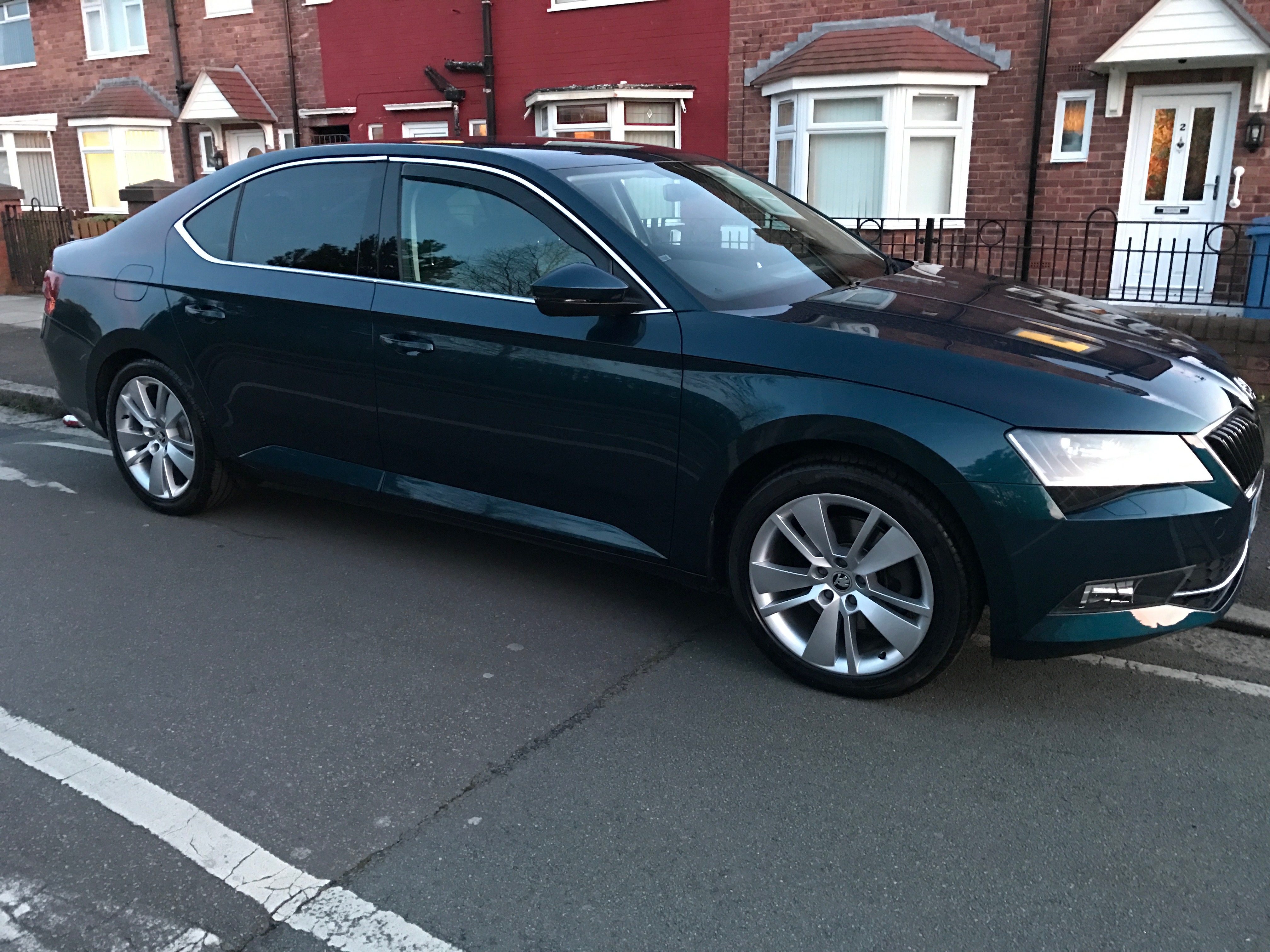

On 25/03/2017 at 22:22, Rainmaker said:
Having used Bilt Hamber Double Speed-Wax to see us through the winter (which it did admirably), I fancied a change. I was debating on grabbing some Fusso but landed on Sonax PNS instead. I need something that will last a good while and maintain protection, as I have arthritis and kidney disease so a detailing session can literally land me in bed for a week. I still love it though.
Today I finally got around to a spring decontamination. Power Maxed TFR followed by Bilt Hamber Korrosol and Gyeon Tar. Then a TBW with AutoGlym Bodywork Shampoo (wax free), with extra attention given to the wheels (separate bucket and wash implements) first. After that I clayed the car with my new CYC fine blue clay mitt. What a revelation that was! So much easier on my hands than a clay bar, and much faster. It literally was like washing the car with a microfibre mitt, only with glassy end results.
After all that the car was rinsed and then machined off with Dodo Juice Lime Prime (mildly abrasive pre-wax cleaner) on a Chemical Guys green hex pad with my Shinemate DA. Then a quick wipe down with Gyeon Prep (fantastic stuff) before applying the Sonax PNS. I have read all about how 'grabby' it is and how stubborn it is to work with, but I have to say I found it a breeze. I used a foam applicator (with an MF one in reserve in case it didn't work nicely), just a second or so of spray and then a quarter of a panel at a time. I found the product was only grabby if spread really thinly, so I did keep the pad moist and topped up a tad when required. I managed to do a whole Superb with about 1/4 to 1/3 of a can at a guess, so nothing excessive. When kept 'wet' like this it goes on beautifully. Online tutorials had said to remove immediately, which I quickly found counter productive. Letting it flash off for 30 seconds meant the residue wiped away very easily and you could see where you'd covered without any issues as PNS mildly darkens the paint and has a fresh waxy/oily look.
Having read about how 'clinical' it looks and having resigned myself to losing the wow factor in favour of easy long term protection in light of my health, I have to say I was pleasantly surprised. It's not as deep as a 'nuba wax obviously, but it really does have depth. The colour is darkened a little but in a way that makes it pop, and the shine and gloss are lovely. It's not quite a 'hard candy' finish, but certainly more than half way there. All in all it's a nice mixture of depth and hard shine, so hopefully it'll keep the car clean for the summer.
I finished off with some Megs Endurance tyre gel and will be putting on my new Soft99 Glaco rain repellent on Monday (Mother's Day tomorrow!) to complete the look. If you've ever considered PNS but been put off by online reviews about application, all I can say is ignore them. Do your prep and you'll have no bother at all. It goes on like slightly oily water, is easy to stretch around and wipes away with barely any pressure as long as you let it flash slightly first. Highly recommended!
Here are some obligatory iPotato pics (unedited).
