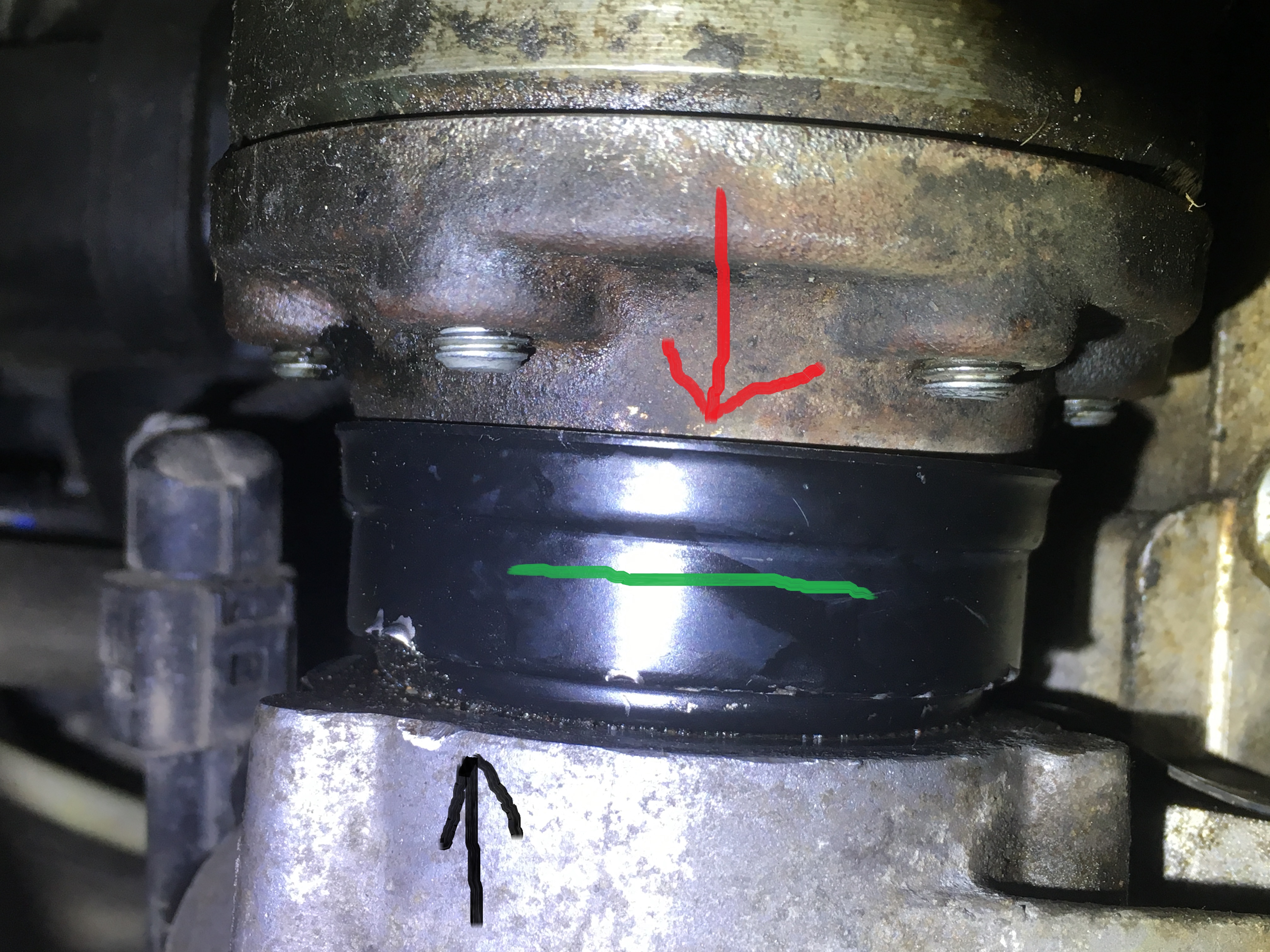

Thanks for that, before I do anything else I think i may have an alternative place that the oil is coming from
Ive cleaned all the oil from around the gearbox, dogbone mount and subframe as it had dribbled everywhere.
I found that when I cleaned the oil from around that metal sleeve where it was forming a 'drip', there was lots of oil all up and around the gearbox casing where the sleeve is fitted.
I am now going to leave the car jacked in the air until later so I can see exactly where the oil is leaking from, as there is no indication of it coming out from behind the flange shaft from the diff seal.
Im not sure how much sense that makes but here's a picture that might better explain it.
The red arrow is where I thought it was leaking as the drips of oil form here(might still be the case), but appears dry.
The black arrow is the recess where the oil seems to be building up, note the damage to the left where It seems a lever has been used at some point. (maybe the breaker who I bought it from??)
The green line shows where the front of the seal was tapped in to, not all the way back but in the same position as the old one was mounted.
Yes, just been for a drive and the oil is pouring out of that hole on the left of the sleeve.
Going to try and get some oil resistant sealant tomorrow and run a bead of it all the way along the join
turns out the diff seal was never leaking, although im sure 99% people would of changed it first as it was exactly what you'd expect from a leaking diff seal.
All good experience though :)

:thumbup: Good news I think.  Shouldn't be under any pressure so may well seal OK.
Yes, no pressure and not leaking whilst car is stationary so must be just above the level of the GB oil.
Wonder how much oil I've lost must be quite a bit i reckon as it seemed to be pouring out all over the subframe
Glad its this tho and not the diff seals again as Ive had enough of removing those spline bolts lol.
Will pick up some loctite flange sealant tomorrow from halfrauds and get it sealed up.
Used the loctite 5990 liquid sealant which has done the trick.
Driven 100 miles and no leaks so I'm really pleased as I don't have to take off those driveshafts again :)
