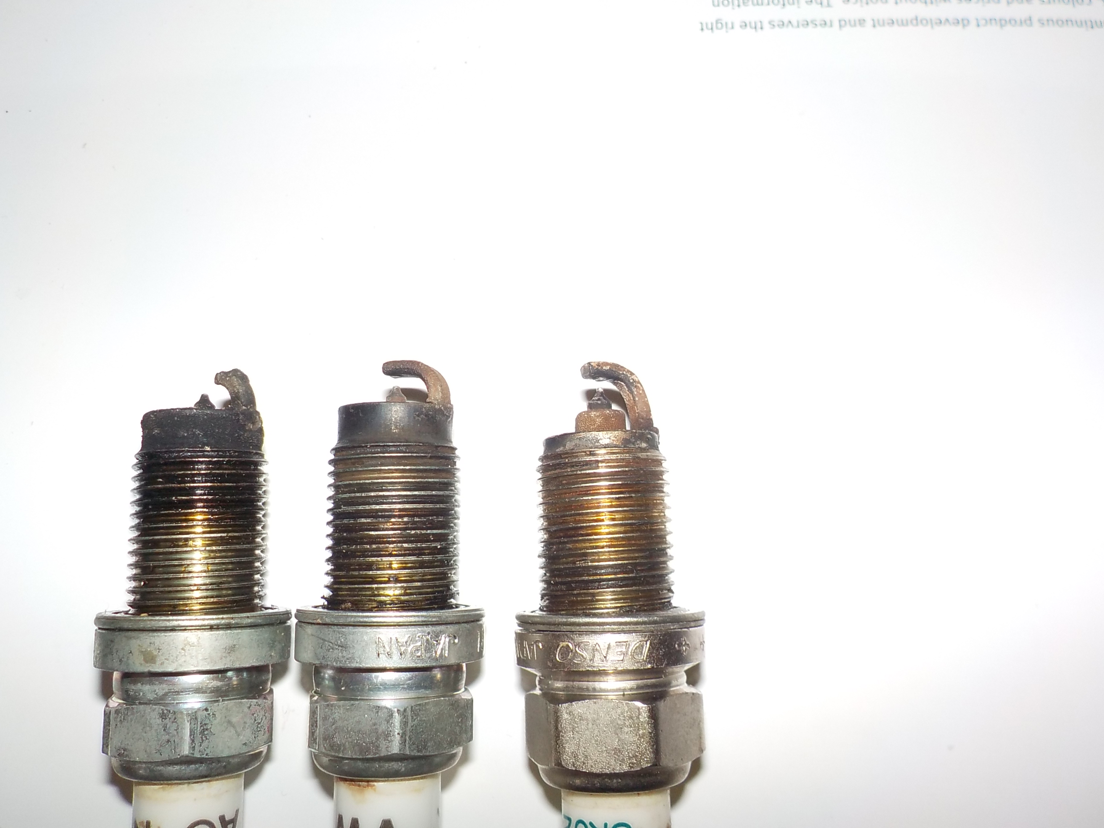

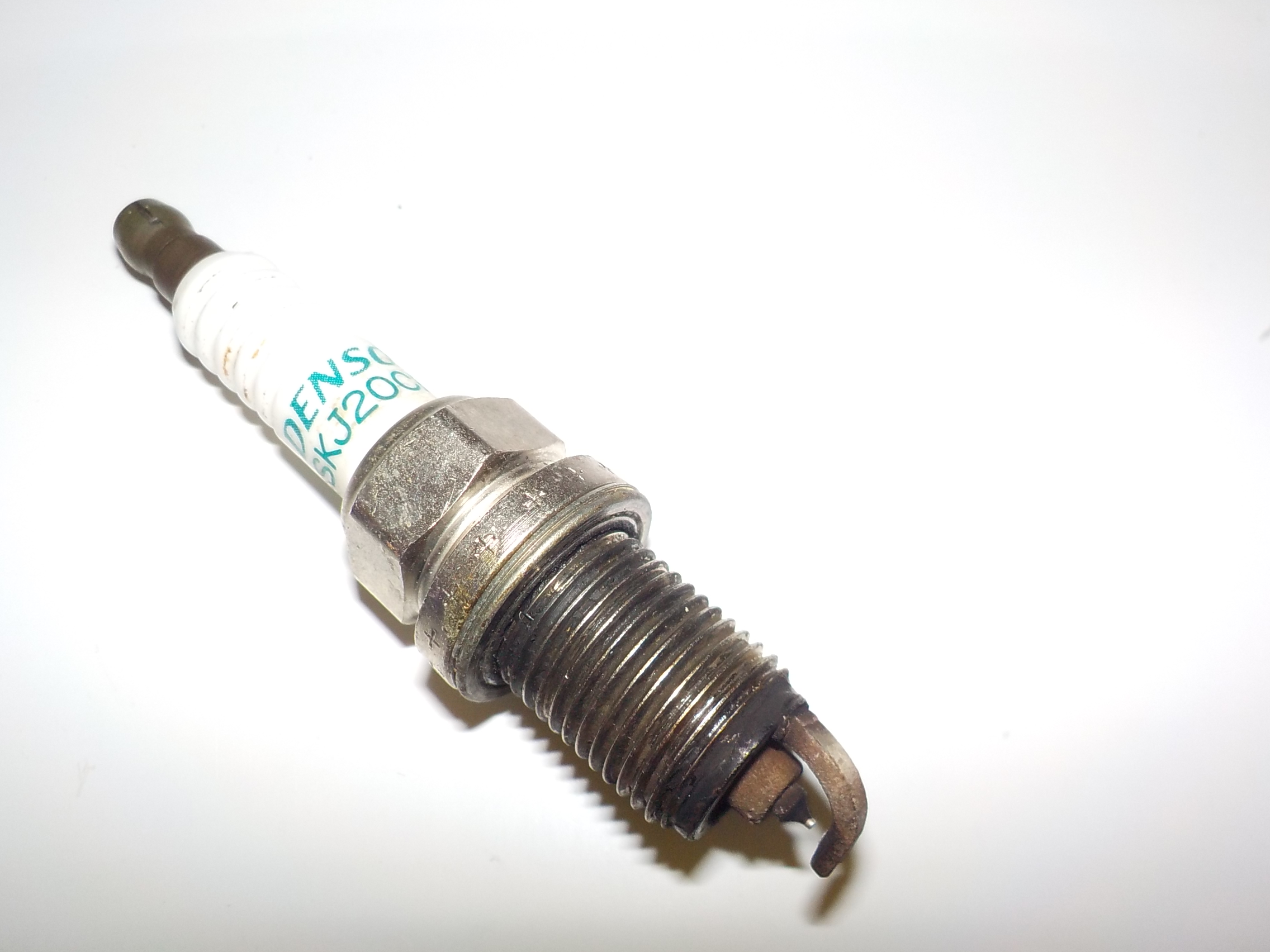

& A TIP DOES NOT ALWAYS BREAK OFF, THEY CAN JUST BURN DOWN WHEN LEFT UNCHECKED,
AS MANY HAVE FOUND OUT, ON TIME IS OK, TOO LATE IS OBVIOUSLY TOO LATE.
Plug on the Left is Standard Skoda Twincharger burnt out, tip never broke off, middle how they should stay.
DENSO on the Right, see the different length of the plugs that actually do not burn up in the 1 bad cylinder.

The plug on the left is exactly what one of mine looked like.

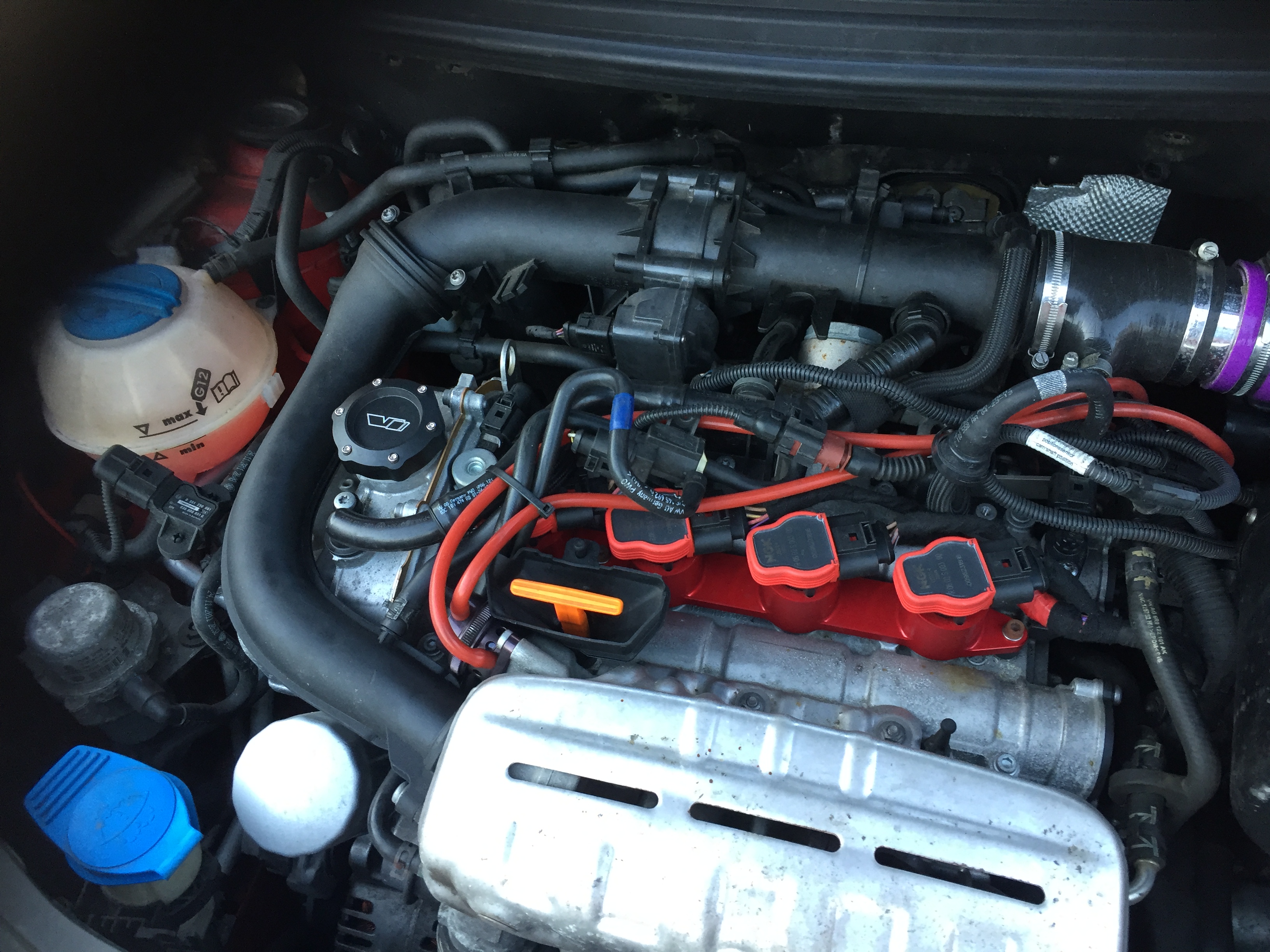

If I was you mate I'd get your squirter jets done look at skoda for some goodwill, upgrade to Denso plugs with a tip gap of 0.6MM, either get a new set of coilpacks fitted OEM or upgrade to Audi R8 coils like I've done I'll post a picture of my engine bay
Here's the upgraded coils which give a bigger bang ;)
