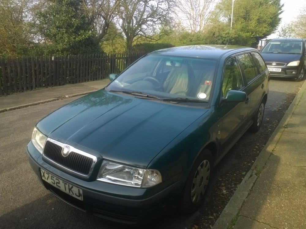

Had my 2001 1.9 TDI Estate from nw. 300,000 miles.  Practically no repairs. Only 1 silencer and servicing. A reliable workhorse. Drives like a dream. Steers itself and the kids grew up in it. Loved it.  Two things happening. Next month I'll be a pensioner and skint. And the clutch is going.  My mechanic says labour about £450 and don't buy unbranded parts.  I see I can get cheapo DMF to SMF kit for £114 but it's not a brand the garage recommend is sensible. Even so it's going to cost close on £700? And what's the car worth? Ziltch. So there's the dilemma. Bite the bullet, ditch the old reliable friend and spend everything I've got on something 2nd hand that's hopefully not going to have a little secret package of problems already, or spend what I've got on what I know is an otherwise pretty good car and keep on truckin? I'd really like the 'committee's views.  I'm torn between the more expensive desire for 'something new' and the fix-it and carry-on approach (given I've been lucky not to fork out for a clutch already in 16 years).

Shell is good apart from minor scuffs and it passed Mot January with minor niggles. One window is erratic so probably needs a relay but it doesn't bother me. Otherwise electricals and aircon all fine.
