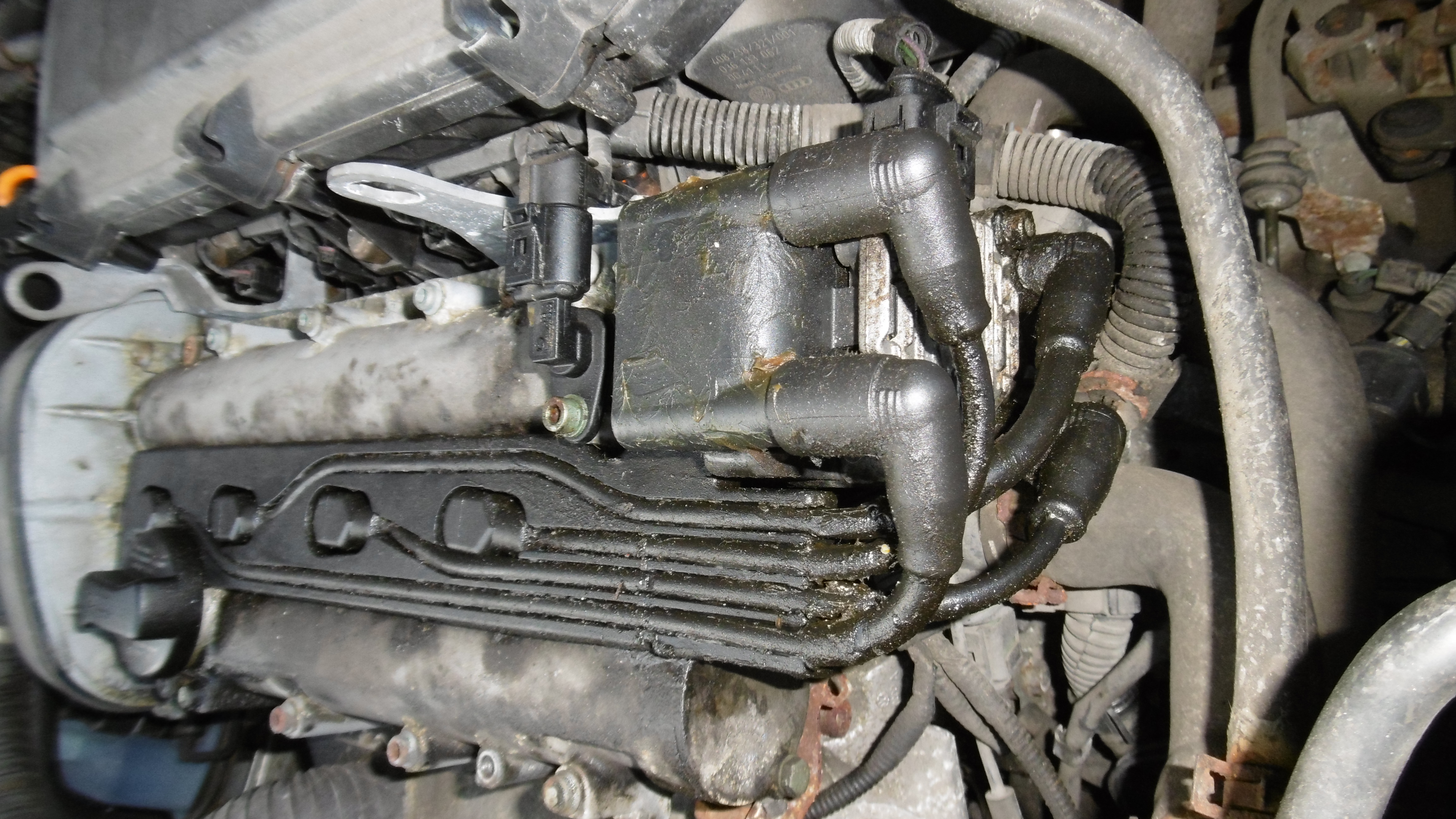

My 2001 1.4 16v has the wasted spark type coil - photo taken from the gearbox end of the engine with plastic cover removed so that you can see lead ordering
PS the stuff on the leads is grease - the coil on these cars (and distributor with previous gen polos etc) is just behind the radiator and somewhat prone to the elements . Every year I removethe leads , clean with wd40 and bake for a few mins on a very low oven - then seal with grease. Stops condensation forming and stops any mis-firing on a damp wet day

that coil pack isnt on mine. (the part that the grease is on) we checked the timing today after towing it, the car started but as soon as you clutch or brake the engine cuts out, and doesnt start again.

Coils can be wasted spark (as per my photo) or individual coils over plugs with a wiring loom - so issue probably not this

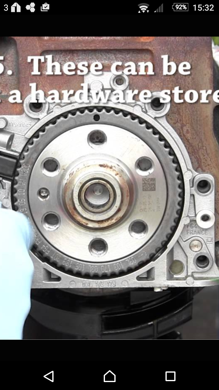

i've read online though, thats there is a plate? on the gearbox that has to be set a certain way for the car to start? ive never ran into one though, it looks like a sprocket? except thin, its attached to the gbox.
do you know what this is? its not in the haynes
I've not encountered this either I am afraid.

This is time I'm thinking it's the crank sensor? I think that's what it's called. From what I've read it's supposed to be
.5mm out or something,   can anyone she'd light on it? Also the name of it thanks
Can you give me the engine code - i.e AGU, AUQ on a 1.8, so that I can source some info on your 1.4?.
If that is the sensing gear, I'm guessing the sensor is at the 10 o clock position to the gear. I need more info from you to be sure. :)

engine is a 1.4 16v 2002 BCA, from what ive read that is an oil seal? that if, out by a fraction of a mm the car wont start.
so ive ordered the part for renting. itll be hear tomorrow. hopefully this is the problem, the car is actually ****in me off at this stage.
A bit of info on the subject - http://workshop-manuals.com/skoda/octavia-mk1/drive_unit/1.4_ltr./55_kw_engine_mechanical_components/enginecrankshaft_group_pistons/removing_and_installing_cylinder_block/replacing_the_sealing_flange_for_crankshaft_flywheel_side/
What bit are you looking to change?. if it was my car I would be checking readings from the engine speed sensor that reads from that gear to see if it supplying an impulse.
thanks alot for that it helped. i was a tooth out on it and i had it at 0.56mm rather than 5 so we redid it. engine still isnt starting though. atm im thinking it could be a crank sensor. but i dont know what id be looking for. any help here would be great. it was a different engine block used with the old rocker and head off of the seized engine. so im thinking its the sensor/s wha tdo you reckon?
