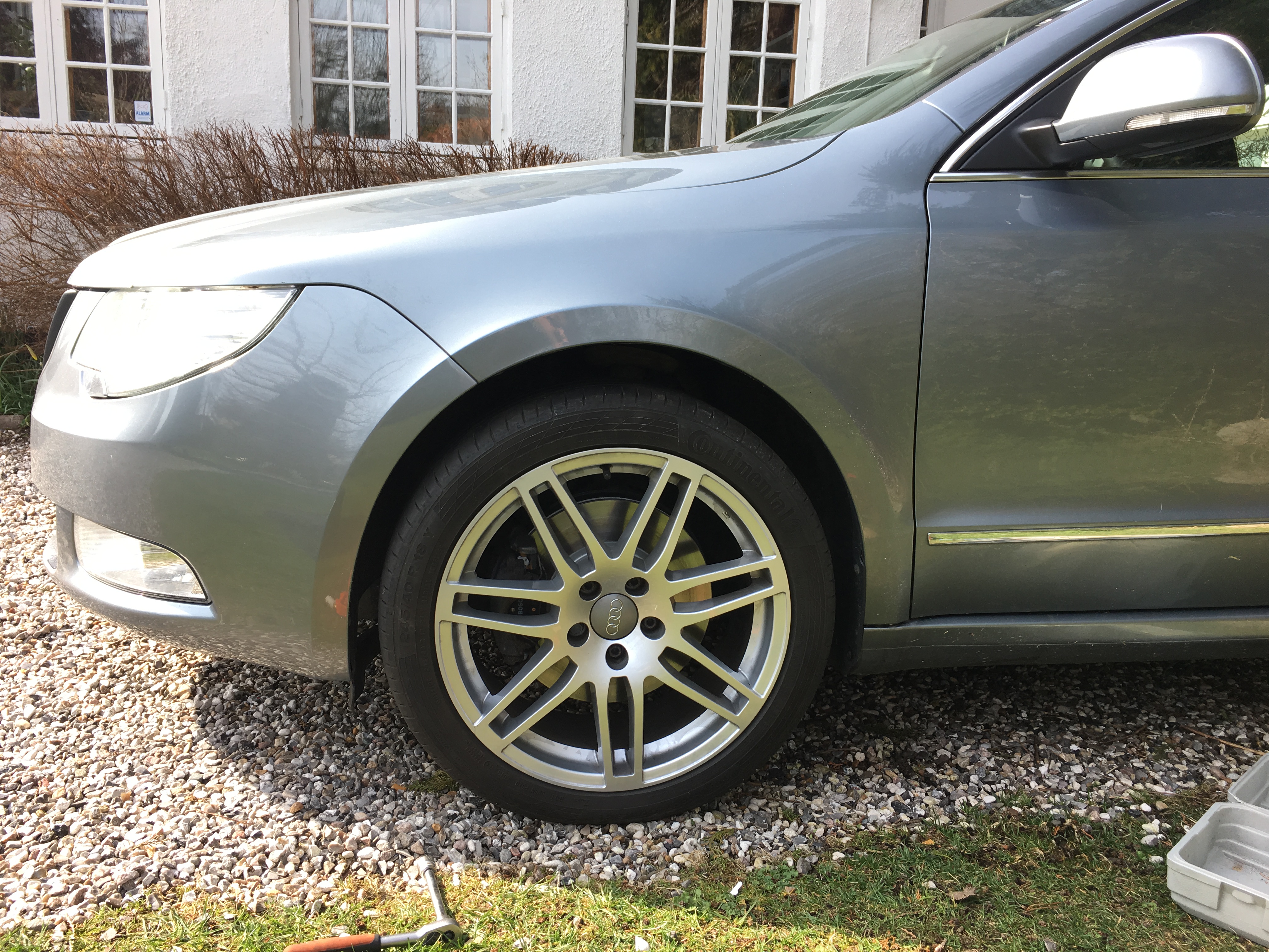

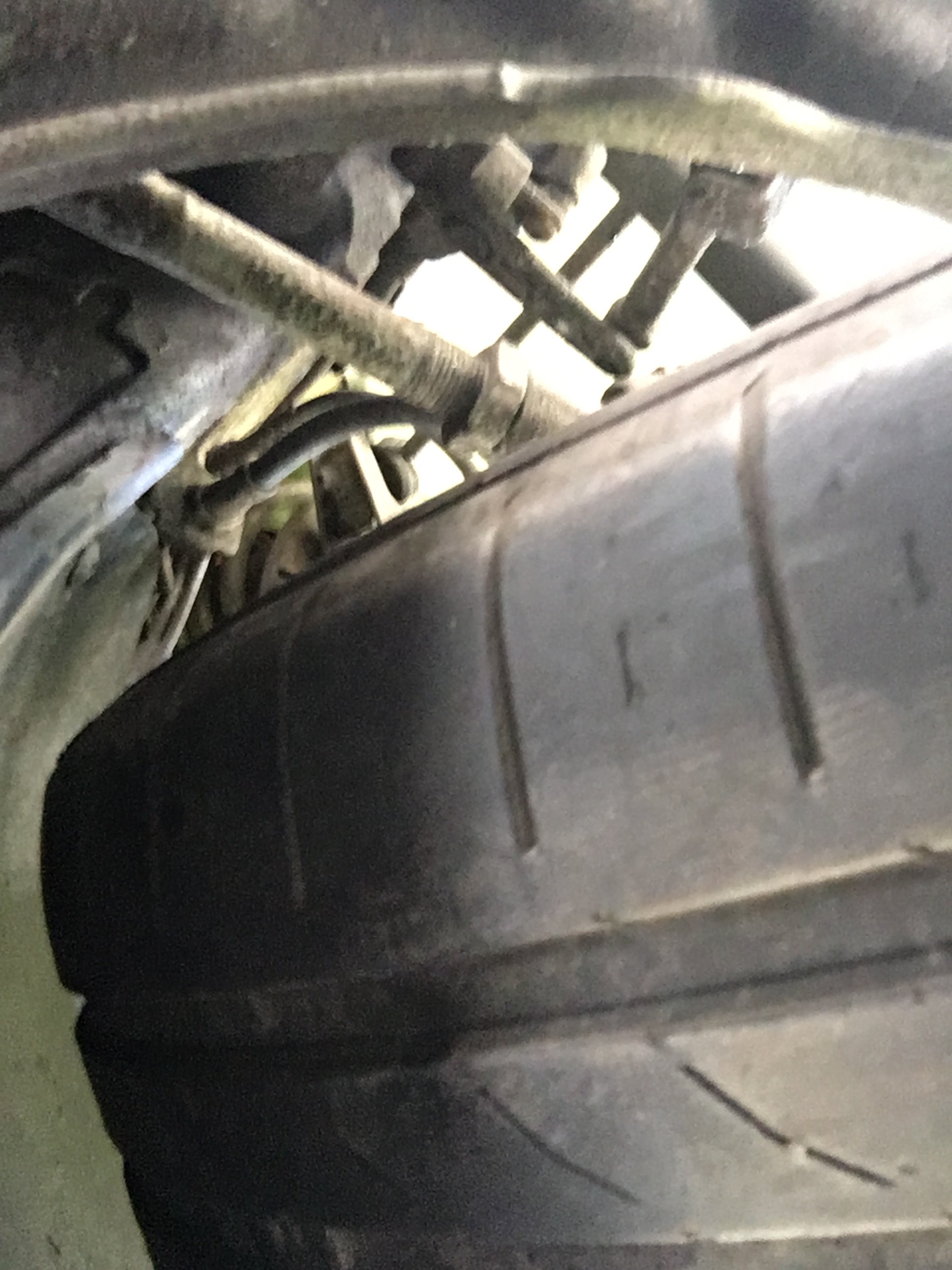

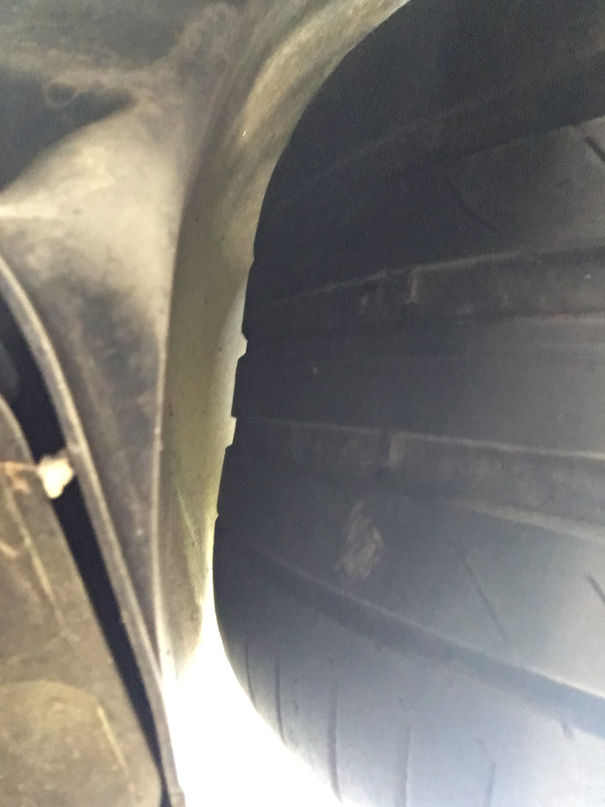

I picked up my "new to me" 2012 Superb yesterday. I purchased some used Audi style wheels locally a few weeks ago. 18x8 ET42. It has 245/40/18 tires. Asked here about it and got mostly skeptical replies about fitment.

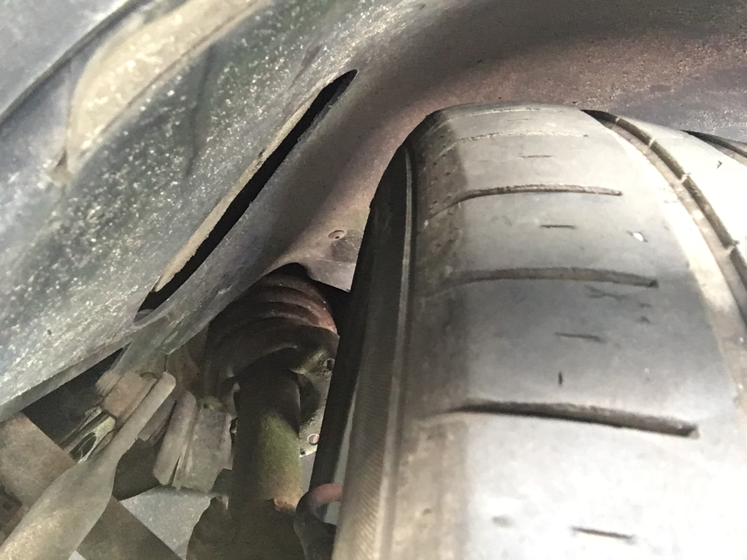

Well today day I decided to try them and they actually do fit. It's tight at full steering lock. Maybe 1/2 inch clearance to the rubber wheel well liner. 1/2 inch again to the strut etc. The rears are about the same. 1/2 inch to the rubber wheel well.
I drove on smaller roads w loads of sharp turns and some backing up etc. No rubbing to my surprise. But the car is unloaded etc so it could be a different story w 5 people in there or a trailer.

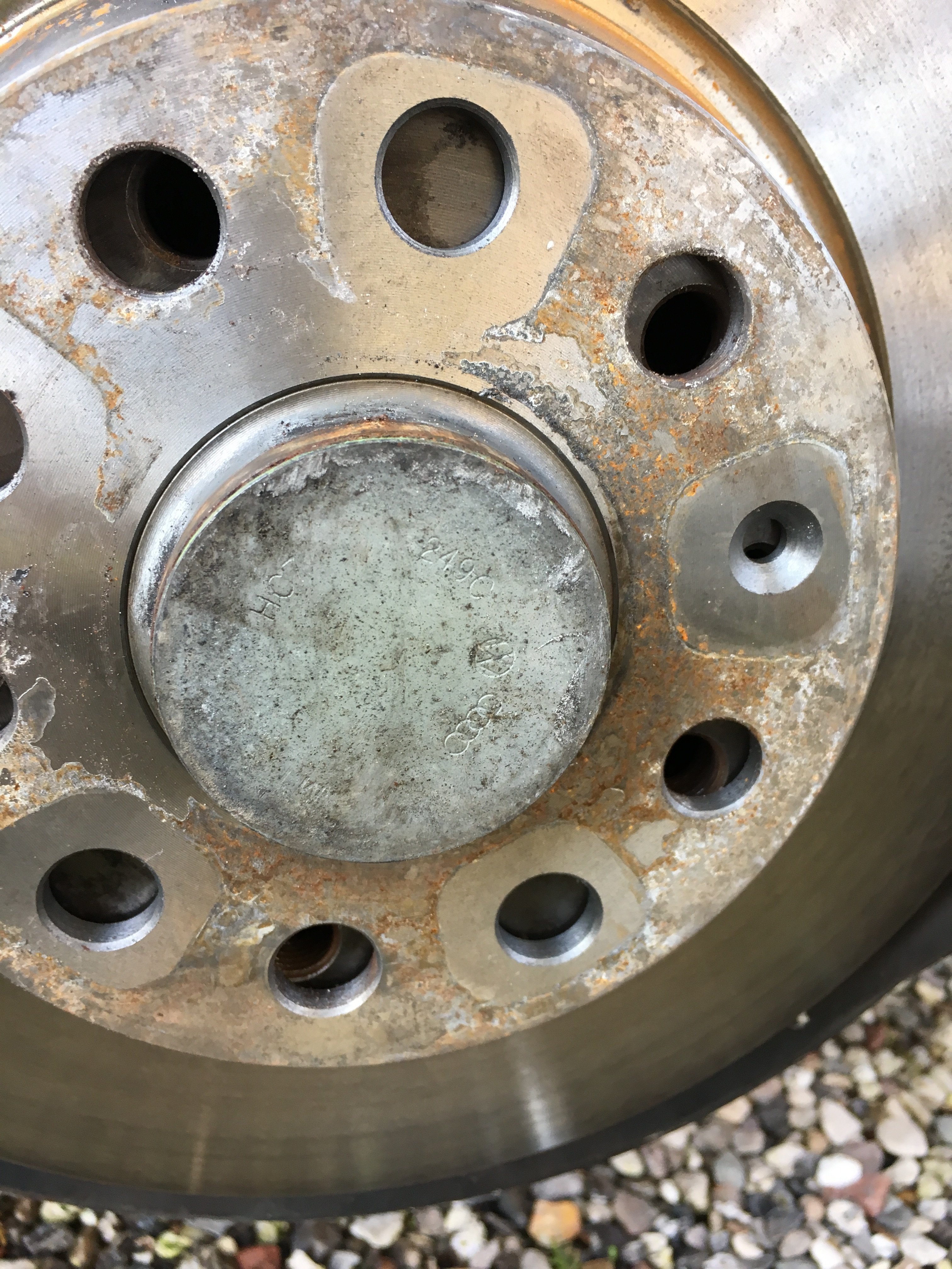

However I think one of the tires has been cupped in the tread as there's a rotation type vibration now that wasn't there w the stock tires. Also found the driver side rear break disk is missing that small locking screw to set the disk to the spindle. (Is that a critical situation or merely a hassle when mounting the wheels)?
The grub screws do nothing but stop the disc from spinning when the wheel is removed, they are a few pence each (same as fitted to VW , Audi and Seat) so personally I would get one from a local dealer (or TPS)
Just bear in mind that your speedo will now be reading slower than what you are doing.
Thanks for the tip on the screw. This is the first car I've owned w wheel lug bolts. I was sure the screw didn't matter once the wheel is mounted but wasn't sure if it had any other function. Thanks for clearing that up.

Fair play, they do fit! When I test fitted the same size wheel and tyres on mine they hit the arch liners, but mine is the Greenline model so it sits 15mm lower.
You'll get away with 5mm front and 10mm rear with the spacers. It will certainly improve the look further.

Nice rims, I like them alot! One of the nicest rims to fit both Superb and Octavia. And with the tyres the sit very well on your car.
The reason for the tight fitment towards the inner plastic arches, is the fact that 245/40R18 wheels is 2 cm wider than standard. Thereby the diameter will be 1.56 cm larger, giving 0.8 cm less clearance towards the plastic. As long as you have clearance, it all good. All clearance is good clearance!
If you experience some vibrations, it may be necessary to do a rebalancing of the wheels. It may be that a weight has been lost.

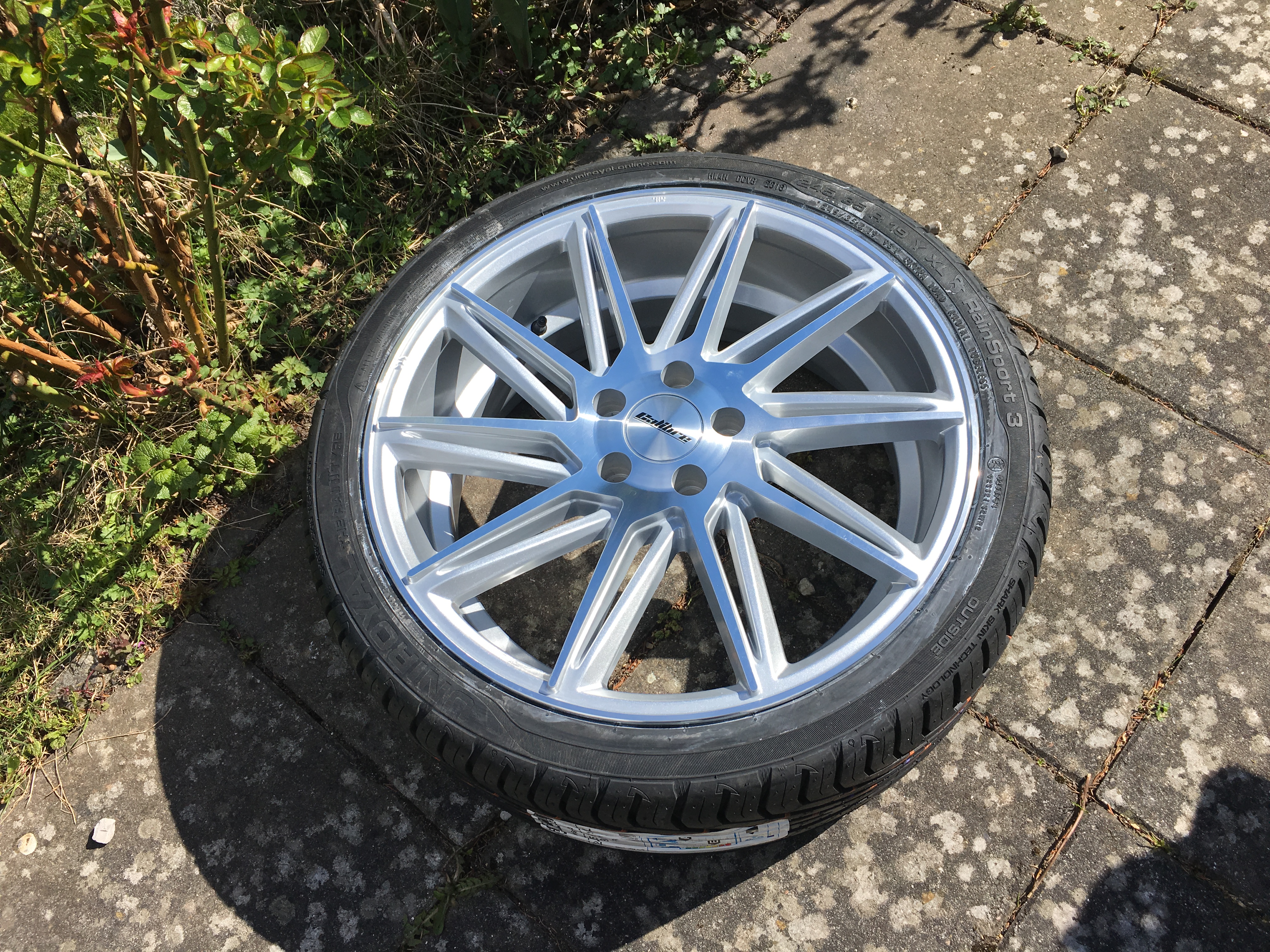

Just got these in today. 19x8 et 45 with 245/35/19s. Didn't have time to get them on the B. But hopefully tomorrow.
Wish thy had a bit more concave form. But the Skoda wheel wells just dont allow it.

I like the look of the Audi ones, but we are all different! Hope you have a nice small brush to keep them clean.
I really liked the Audi wheels too. But they needed refinishing and tires. I'm still planning on getting winter tires for them. And have a local place to powder coat them either graphite or black. Haven't decided yet.

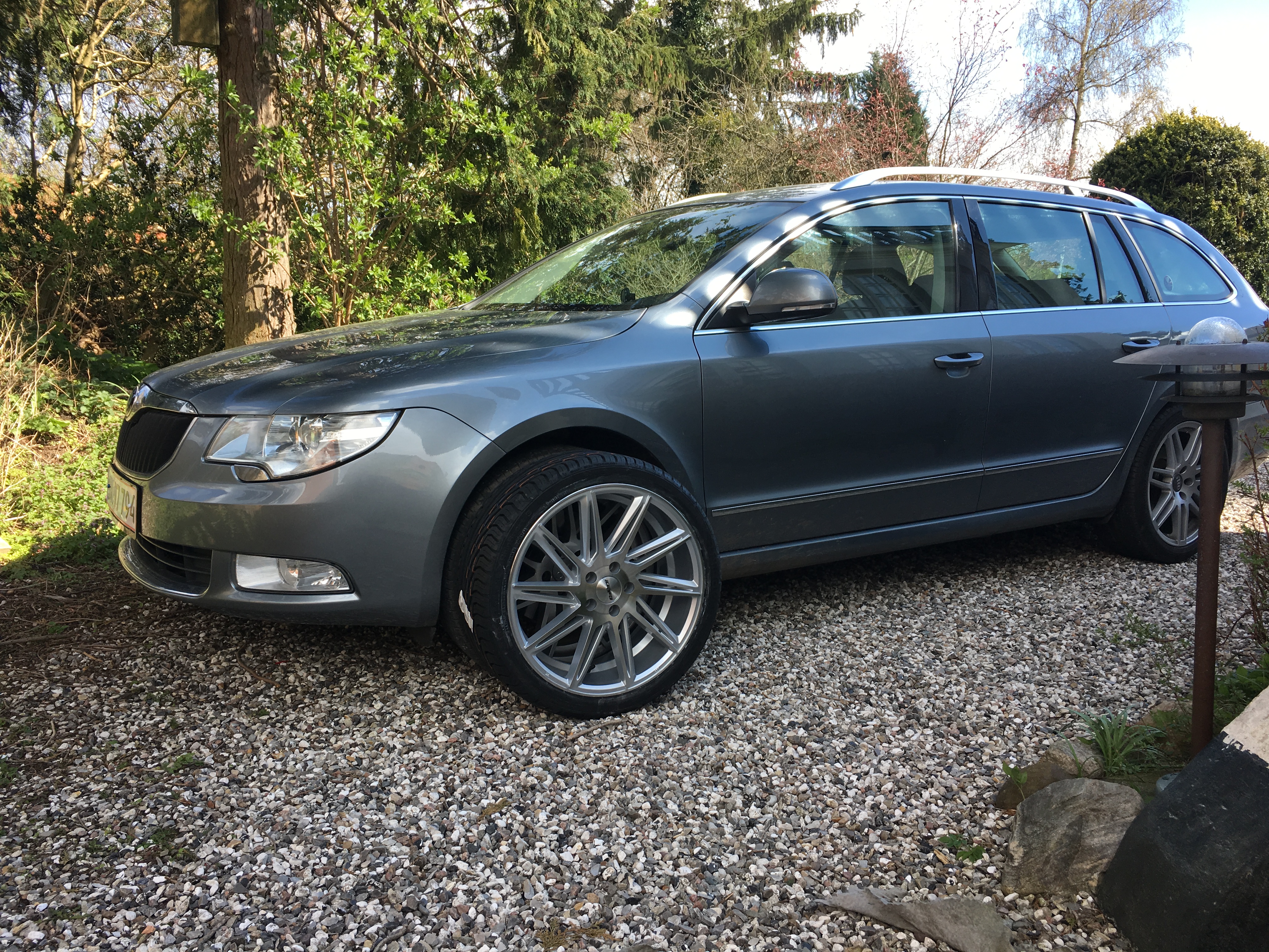

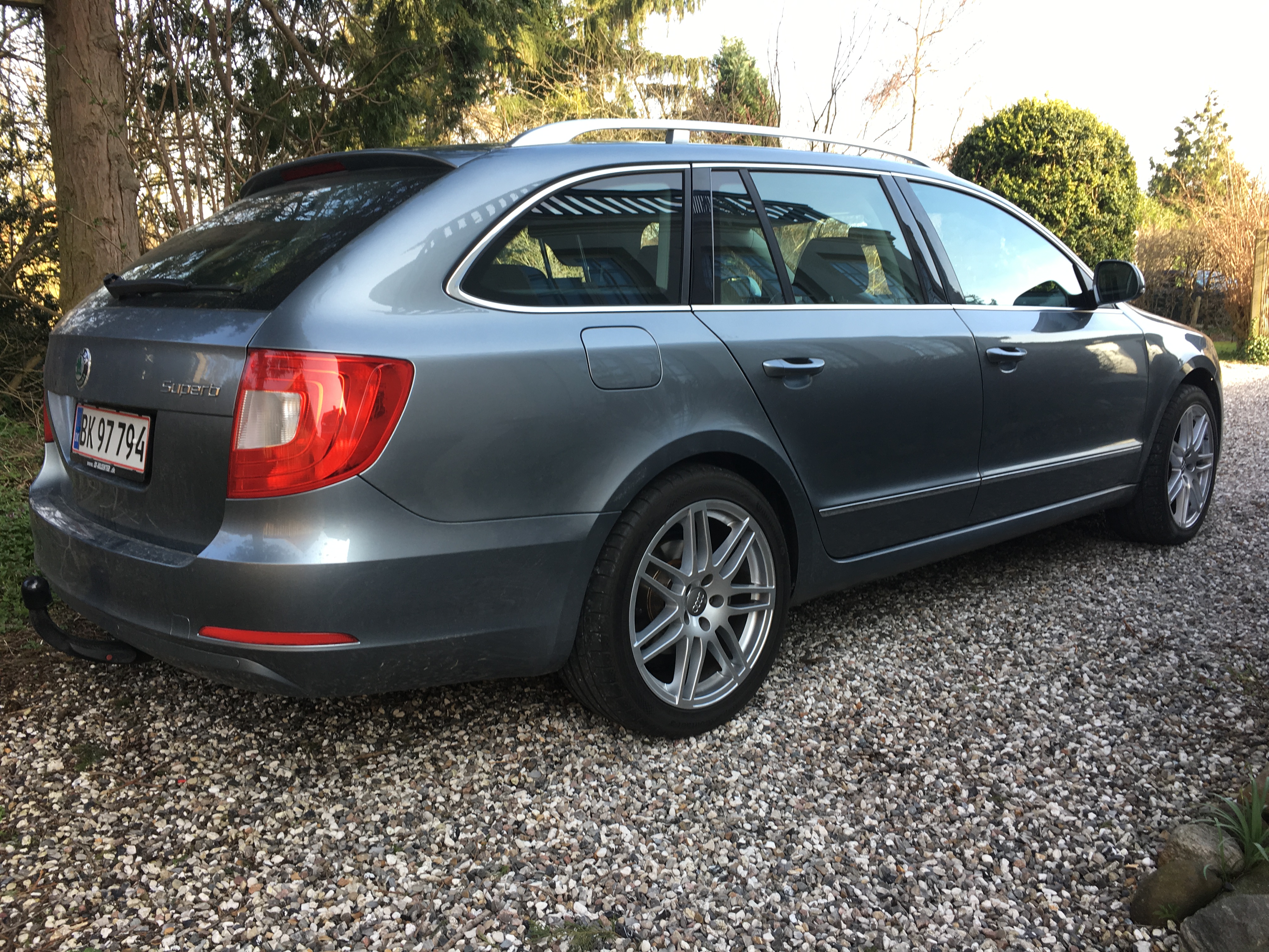

Im alittle unsatisified w the Calibre wheels. They fit fine and drive well. But I put myself out there w the shiny flashy wheels and kind of wish I went w a dark 5 spoke or something like I've done on the past 2 cars I've driven. Something more sport oriented instead of shiny luxury looking. Lol. But I'm in them for some decent pile of cash so I'm running them. IMG_1177.thumb.JPG.c7914d4b6bac298d80135e245792c653.JPGIMG_1186.thumb.JPG.7e6854ffeea04281a8dd5d0e98f67500.JPG
