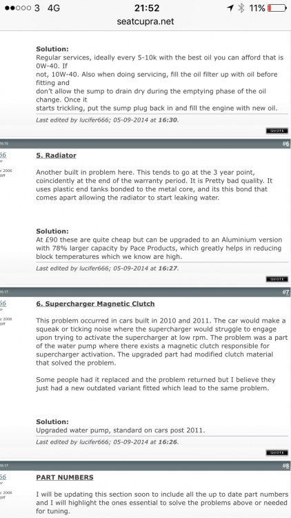

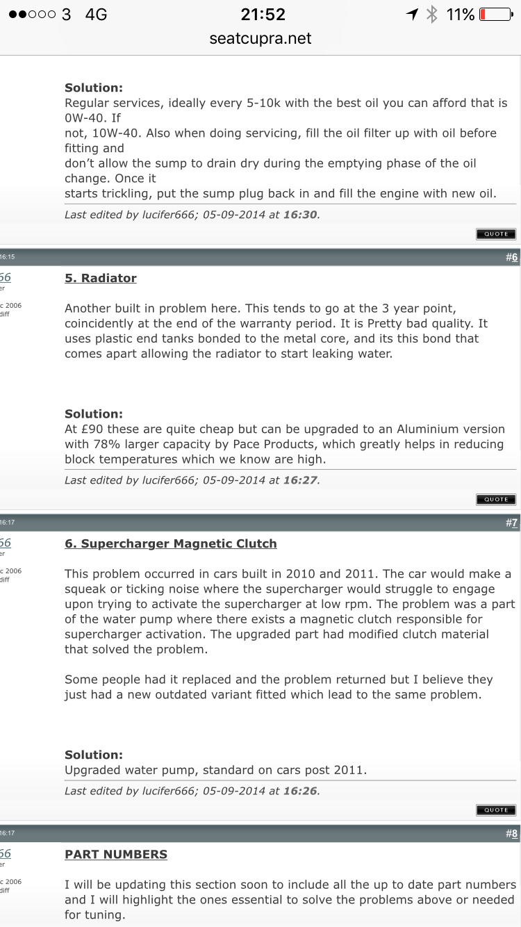

I've read somewhere I think it's lucifers fundamental 1.4 twincharger design flaw that the radiators fail after around 2 years because they are made of cheap plastic he said something about a upgraded one available for around 50-100 pounds

1,800 CAVE Fabia in the UK from 2010-2012 and another 1,100 plus 2012 on without many radiators failing, or reported as so.
Tomorrow garage time to check it out .
1 hour ago, Awayoffski said:
He was talking SEAT but the same difference.
Why just because no one has posted about it ? Like you said you own one car not the whole fleet of twinchargers
Thomas he posted in  2014 about radiators that need replacing after 3 years, the SEAT Twinchargers were introduced in 2009,
the Fabia in 2010, there are people here with 7,6,5 & 4 year old ones, and plenty post on every other issue so maybe ask James on the radiator failures,
or any other Tech you know or any one in the parts department, there is no common issue, but there are failures.
