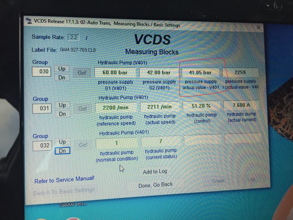

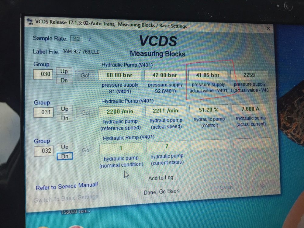

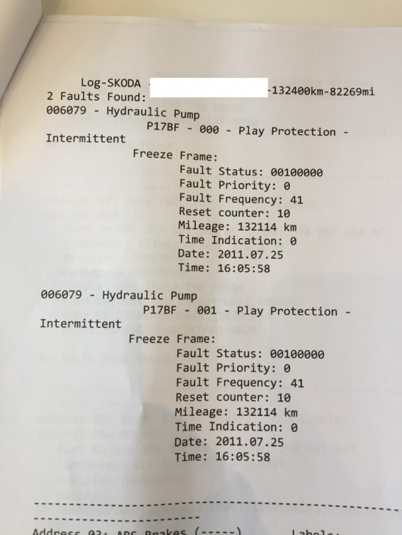

I have a Skoda Octavia MK2 facelift with 1.4 TSFI and 7speed DSG 0AM gearbox.
The gear indictor flashes after 10-15min driving. I think the problem is due to problem With low pressure on the Hydraulic Pump (v401)
I get 41bar but i think it should be a lot higher. Can someone With DSG please readout their value on the V401 pump?
gearbox: 0AM 300 050 G HW: 0AM 927 769 D
