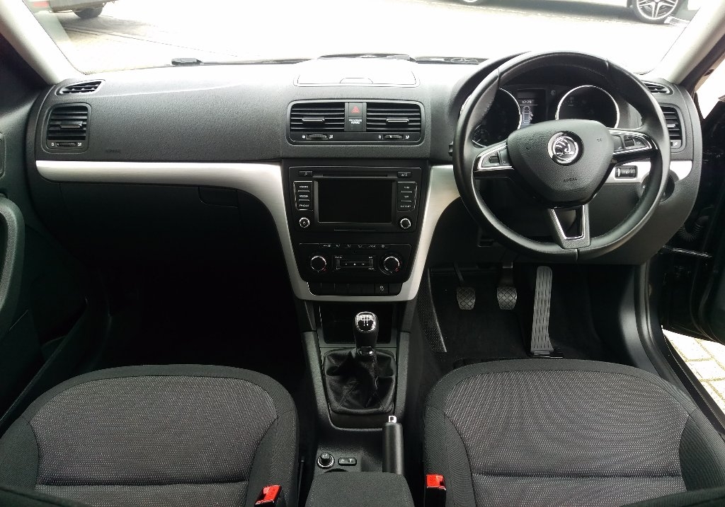

2010 MFSW:
2014 MFSW:
Edited by langers2k
3 minutes ago, langers2k said:
2010 MFSW:
2014 MFSW:
Exactly.
The top is what I have, the bottom is what I want to have :)
