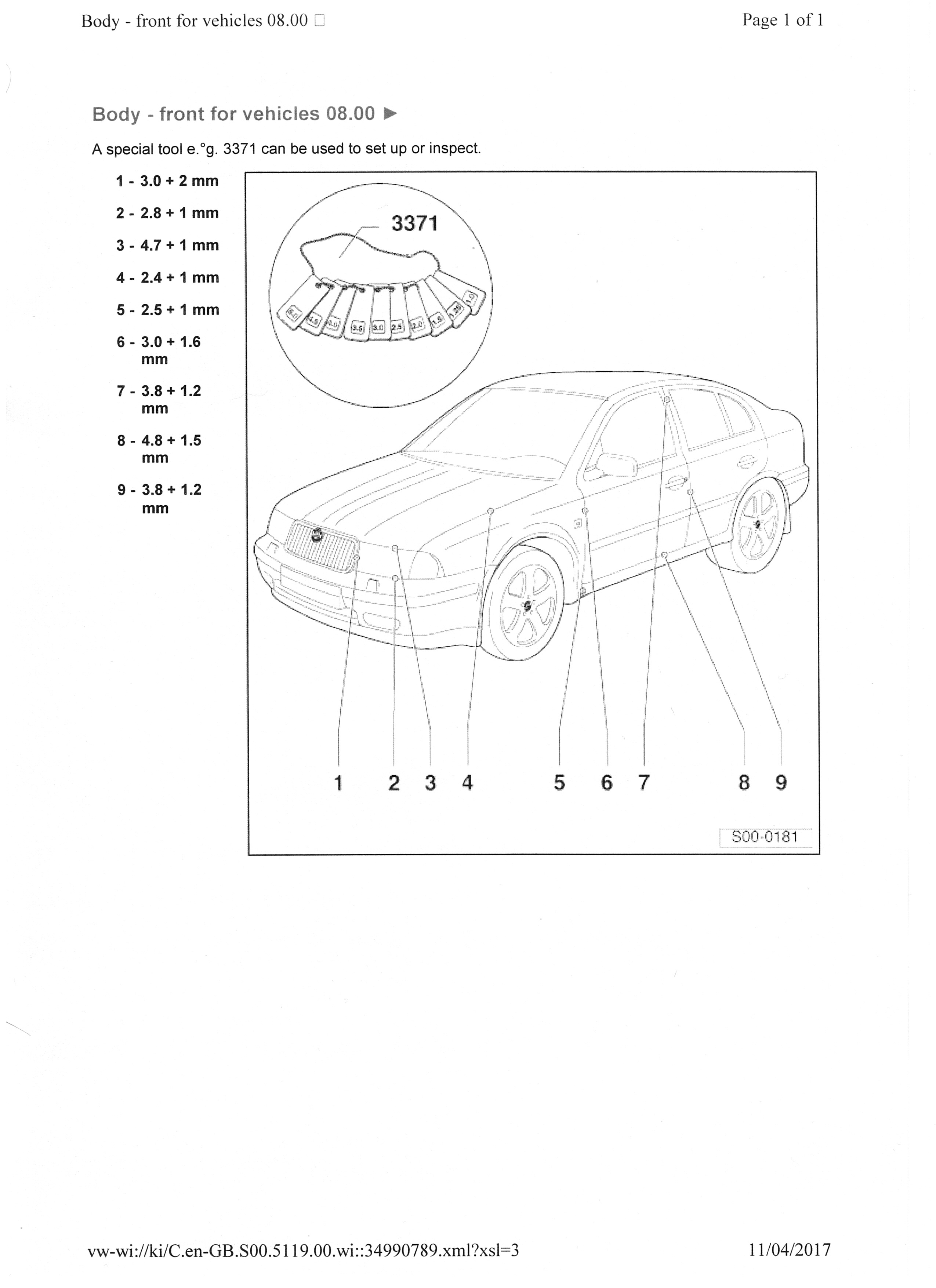

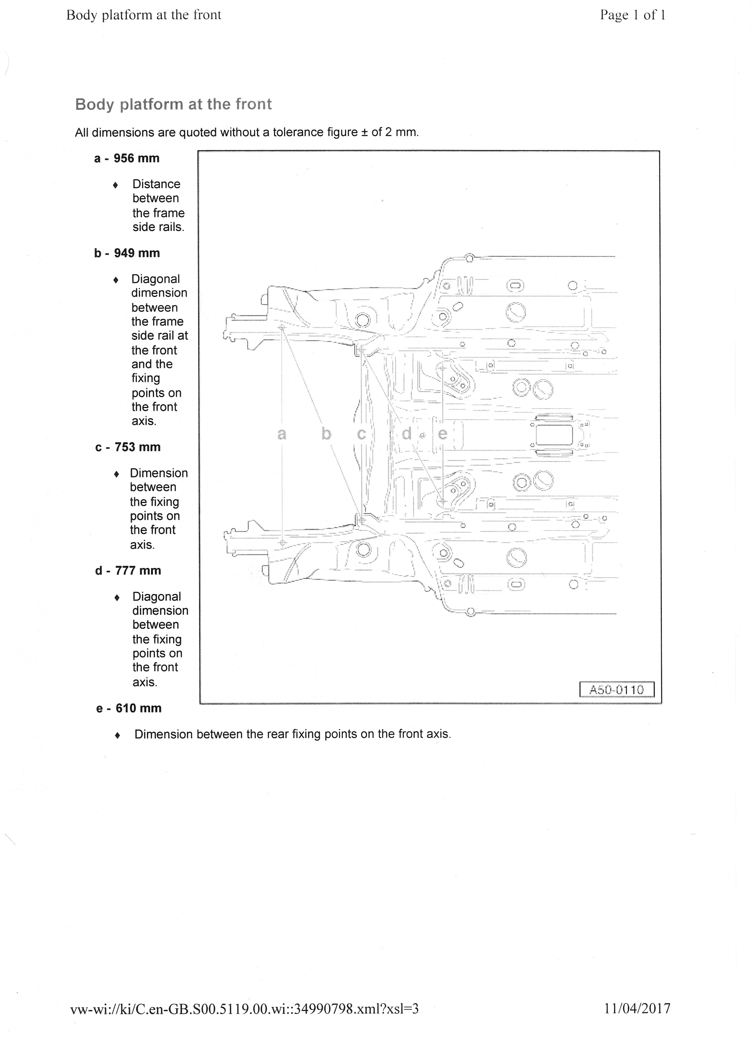

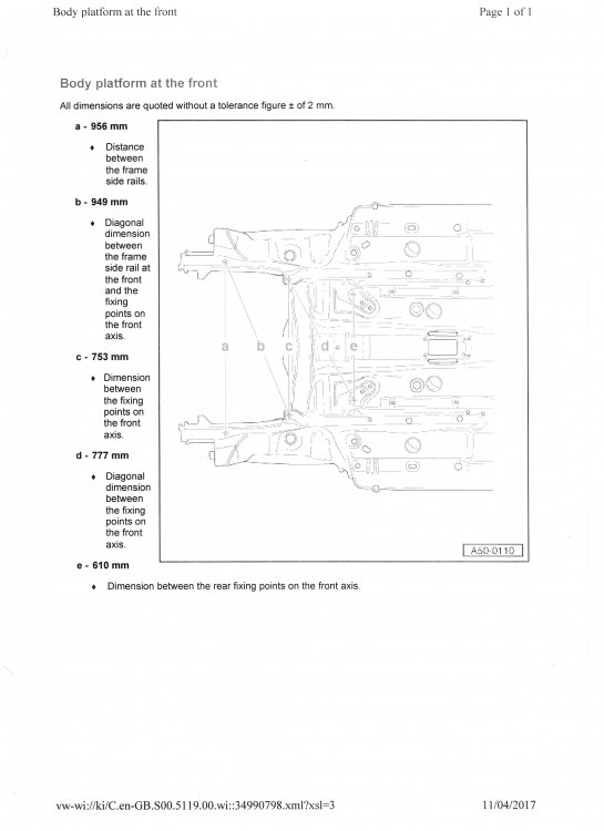

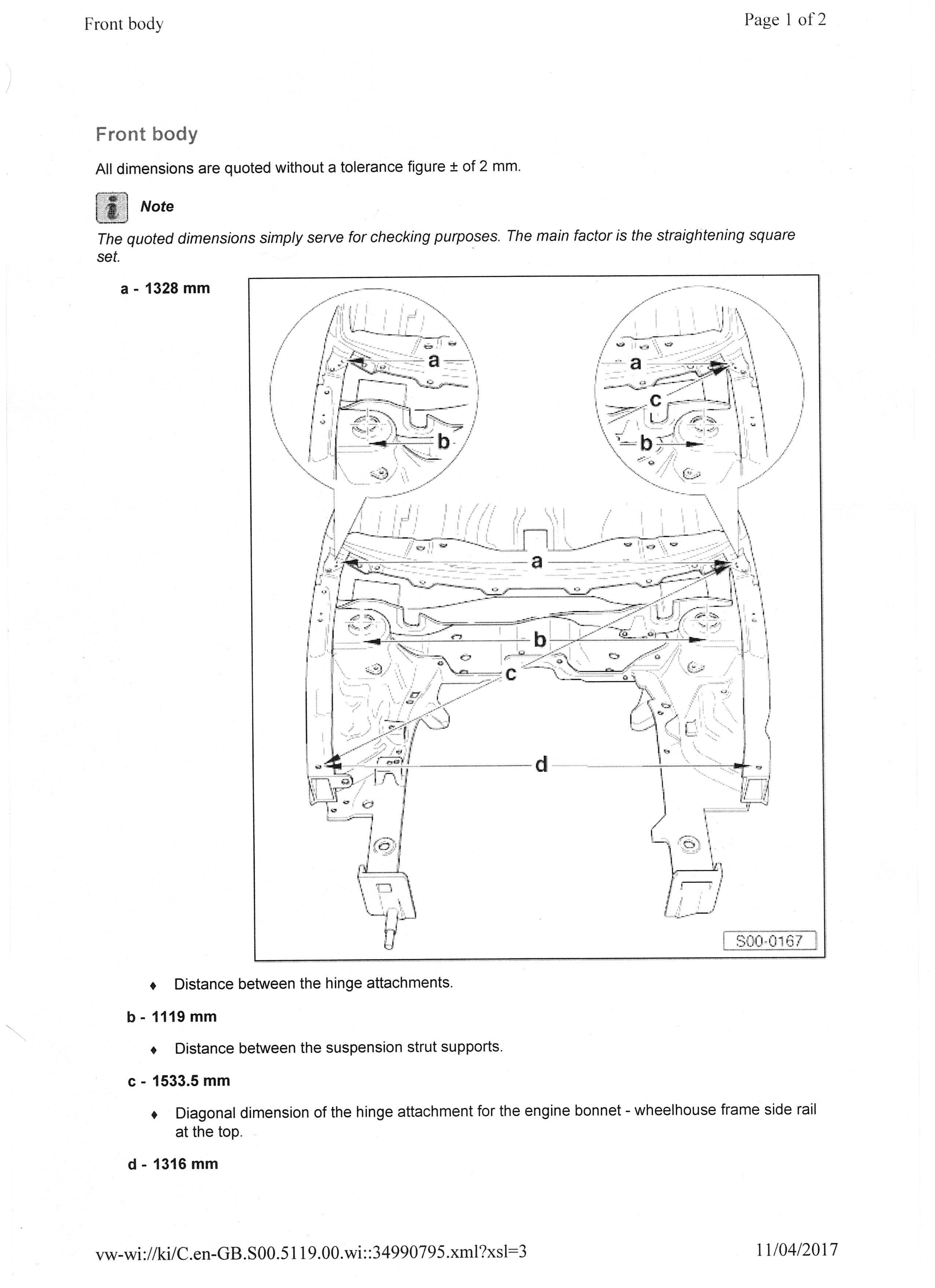

Find a similar model and take measurements across fixed reference points on the actual chassis itself, such as the strut tops, captive bolt holes for coolant bottle etc - very important they are fixed, as they should be constant across vehicles, this will give you a reference to work against (there will be an allowable tolerance that the manufacturer allows, you may even be able to get this data from an accident repair specialist as well)
My panel gaps are uneven. Left side is normal, nice and tight, while right side has an increased gap. The bonnet closes properly. My right headlight did get the plastic smashed (the one around the headlight itself) and the indicator smashed.
By strut tops, you mean to measure where the suspension is? Is there possibly to find these measurements online, so I don't have to measure on someone else's car?

58ed196288141_OctyFrontDimensionsTopside1.thumb.jpg.13af99d21b1200d9ec1eb96c273751ba.jpg

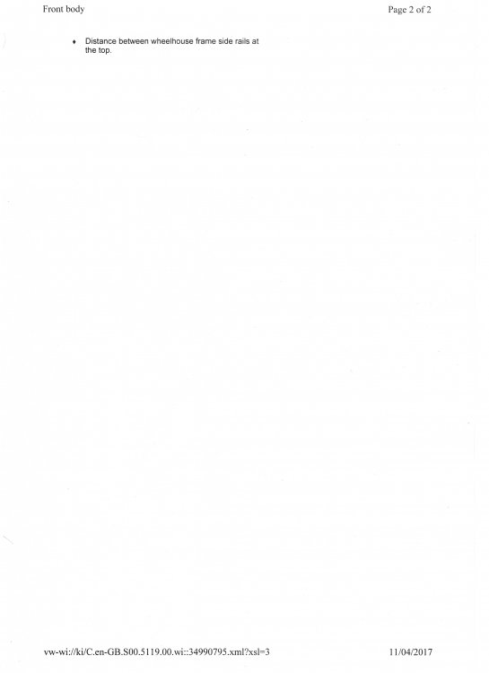

58ed196f255eb_OctyFrontDimensionsTopside2.thumb.jpg.a771664ade82c61a80ad87fa42a2542f.jpg
58ed198e3924b_OctyFrontDimensionsUnderside.thumb.jpg.aae11236b203e222e6d3732536193cbb.jpg

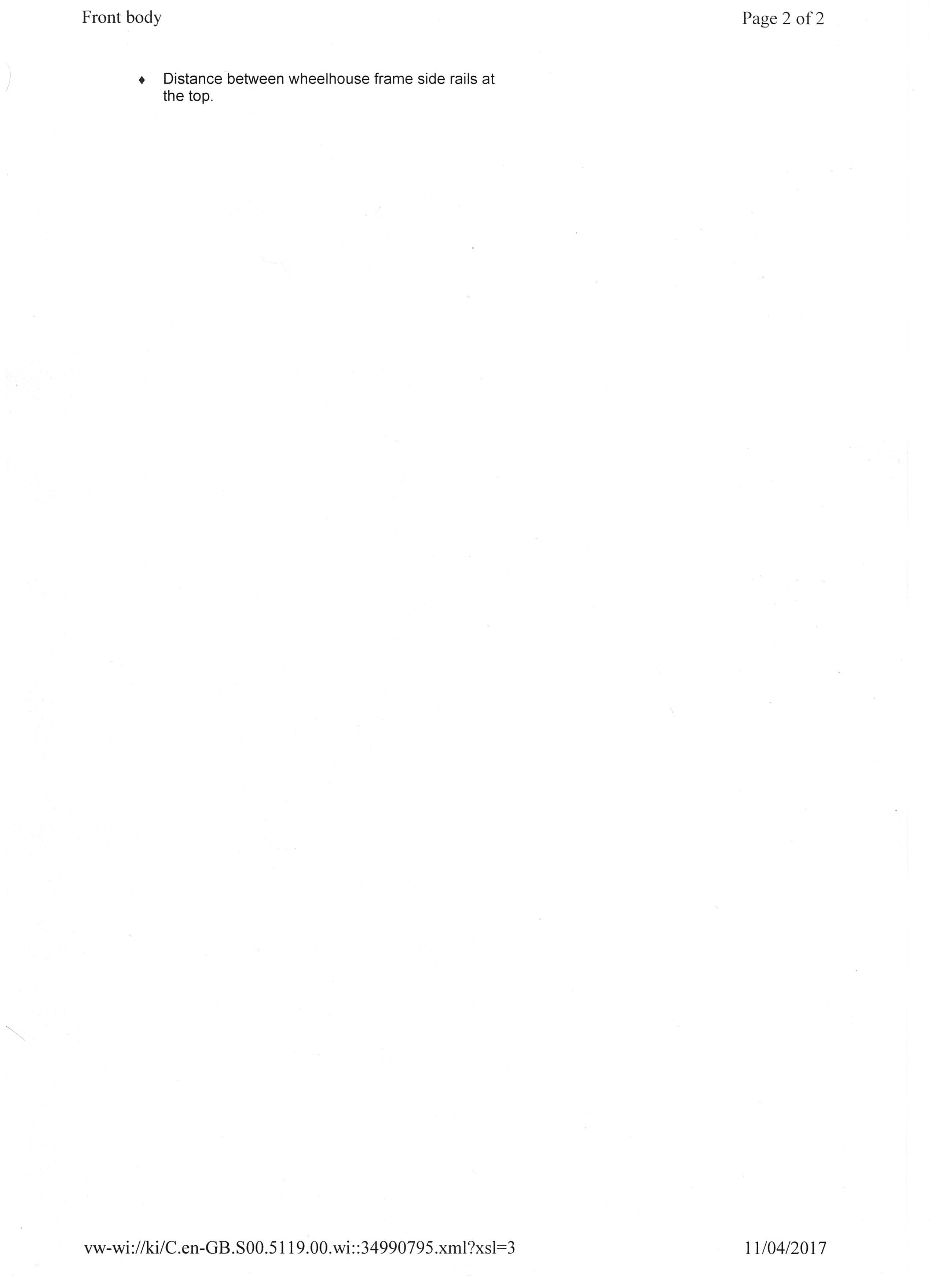

Thanks for the official dimensions, that'll come in handy! :D

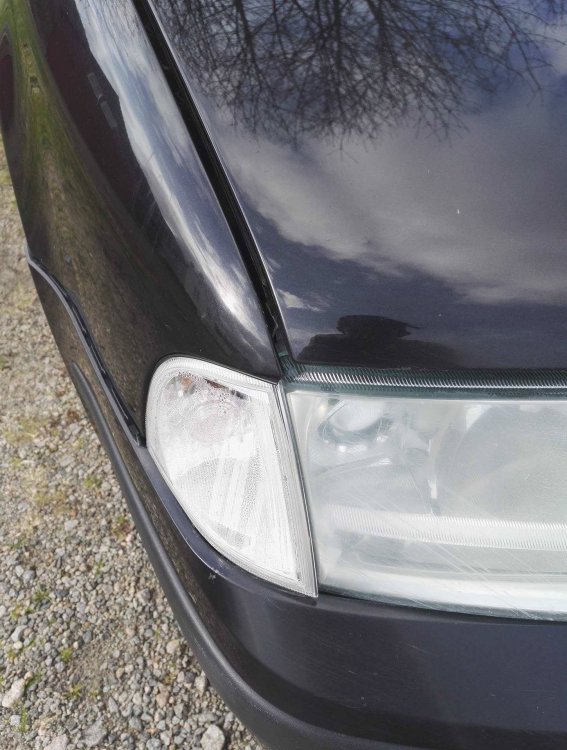

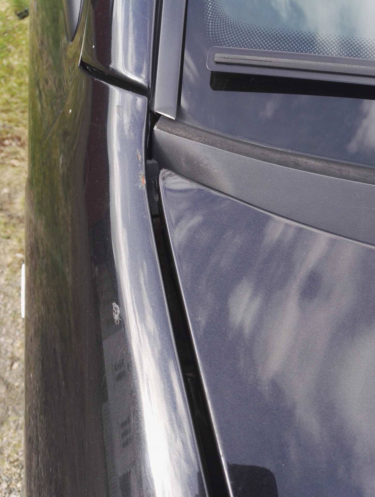

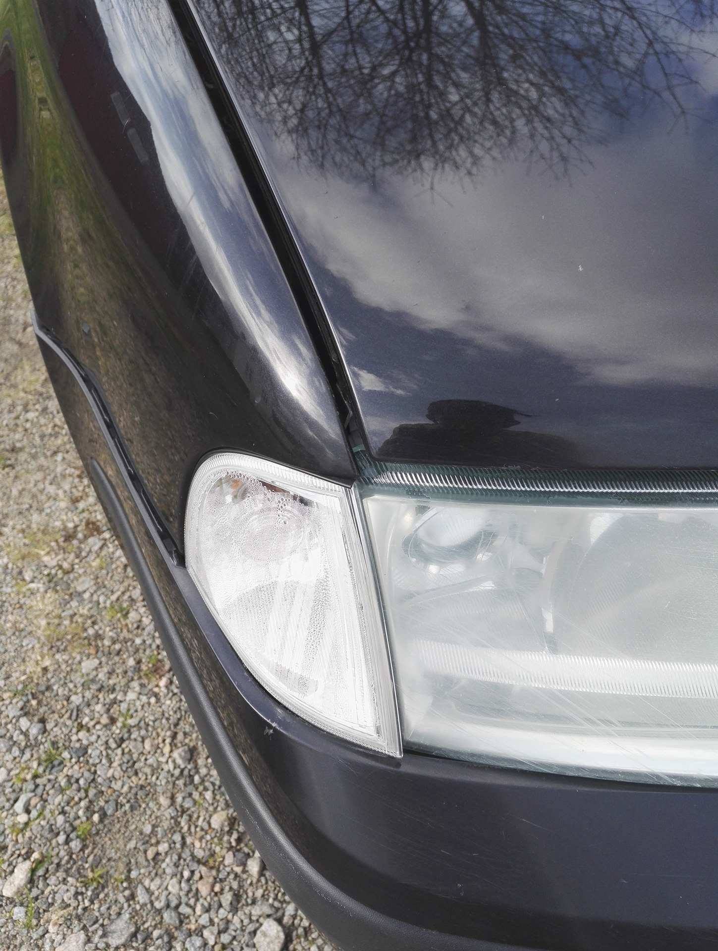

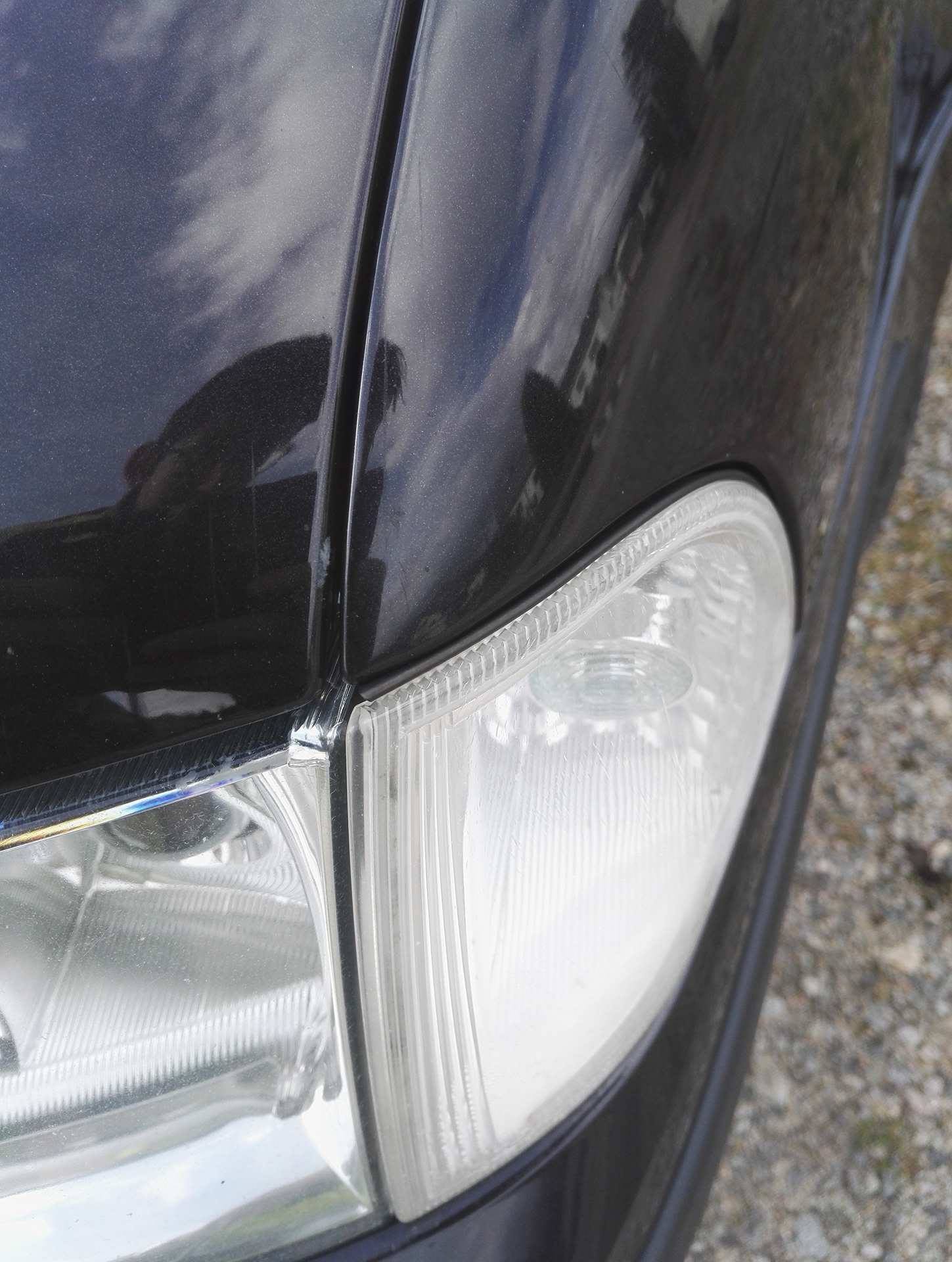

Also, I included some pictures, you can see how the left side aligns compared to how the right side aligns.
@MujoBijeli That looks like your RHF wing has shifted right, based on how the panel gap isn't constant width any more.
So in other words, if I change the RHF wing, it'll be okay again (granted if I switch out the bumper as well, since as you can see it is bent a bit too)?
@MujoBijeli Maybe. I don't know if the outer wing is bent or if the inner wing is too, which is where @nige8021 chassis alignment diagrams come in.
