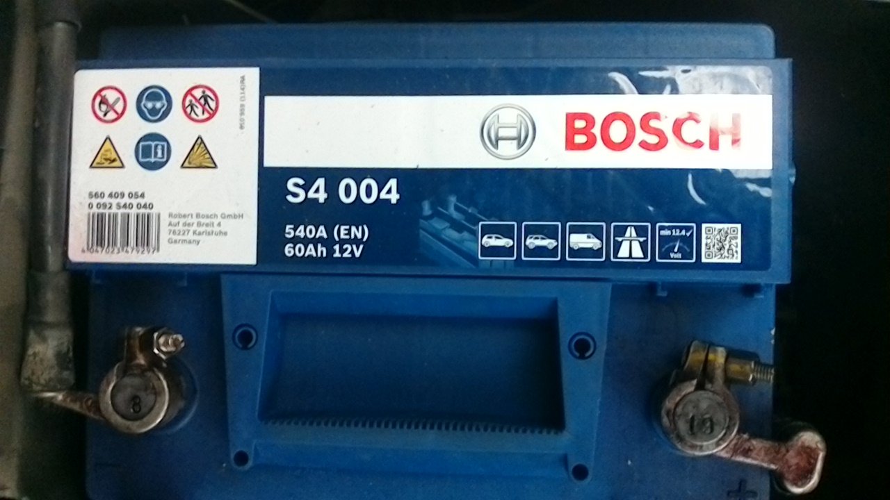

Also after deeper research , I found that the recommended battery for  Skoda Octavia mk3 iz3 1.4 tsi is type 027
As I said  previously  the problem occurred after battery change, today I checked the battery placed at the car , this is this at the photo, but as I checked this is not type 027 battery type, can it be the cause of the problem,

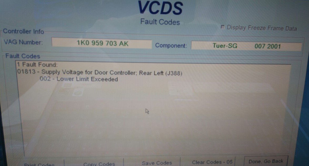

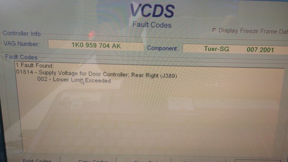

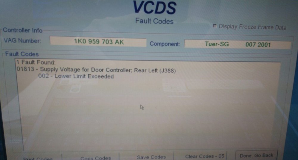

Cannot open both rear windows, Skoda Octavia iz3 1.4 tsi.
Vcds scan gives faults as in attached photos.
I will appreciate any recommendations

What happens if you clear the codes?
The battery isn't as powerful nor does it have the capacity of a 027 battery but it shouldn't cause any damage, it might just struggle to start when it's cold (may not apply to Greece).

The fault won't clear if the supply voltage is still low.
You need to find a wiring diagram and start tracing the power and ground connections for the rear door controllers. Probably worth replacing the fuse if it's common to both controllers and checking the contacts are both clean and in good condition.

The car has one fuse for the front and another one for rear windows, yes fuse for rear windows is common for both left and right.
So I replaced the fuse for rear windows with that for the front windows  but problem still exist, also with the fuse from the rear windows placed to control front windows ,no problem to open and close front windows , so I think that the problem is not the fuse
In which case you need to start checking voltages to see how much voltage drop there is between the battery and rear door controllers.
