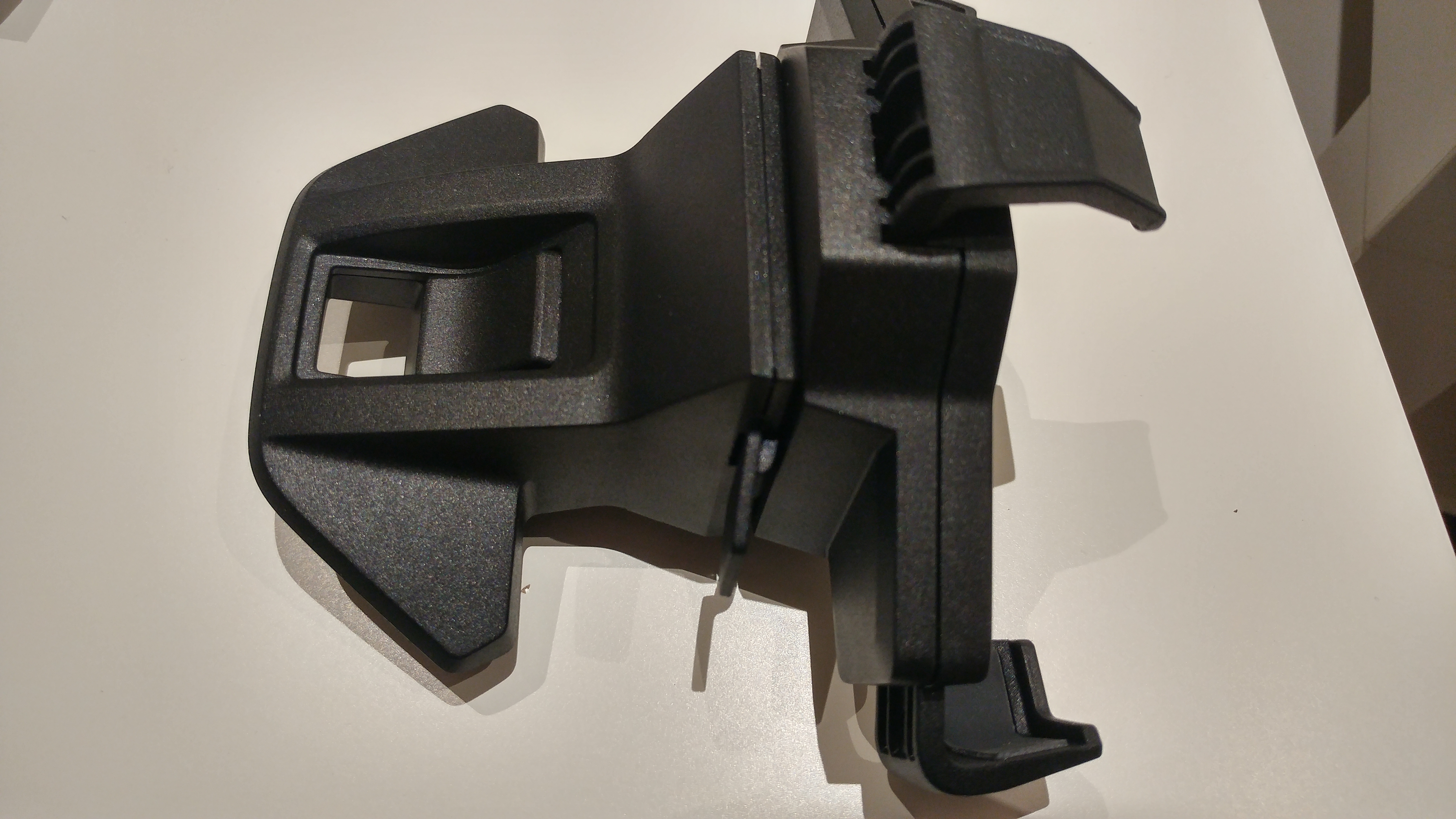

The phone holder should seperate from the main body im thinking of making a wedge so that when the phone is back in place its more towards me However despite seperating it to have the clip at the top it wont come undone im trying the little tab but to NO avail OH drats just read Ive posted on original non related thread
