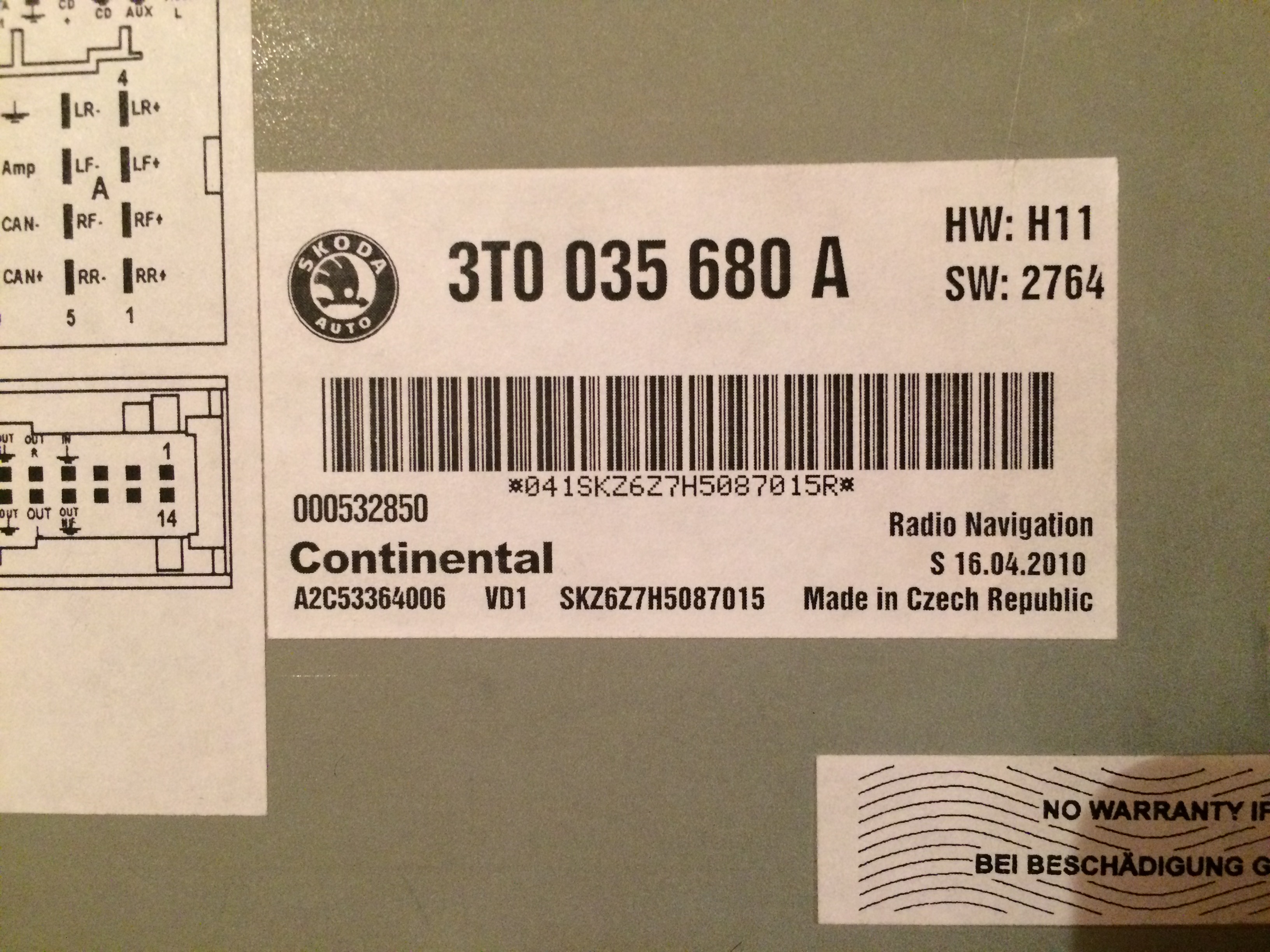

Now i’ve bought Skoda Columbus RNS 510 (3T0 035 680 A HW: H11 SW: 2764) from eBay, 2010 model with green lights in buttons. I successfully installed it, done coding with vcds too.

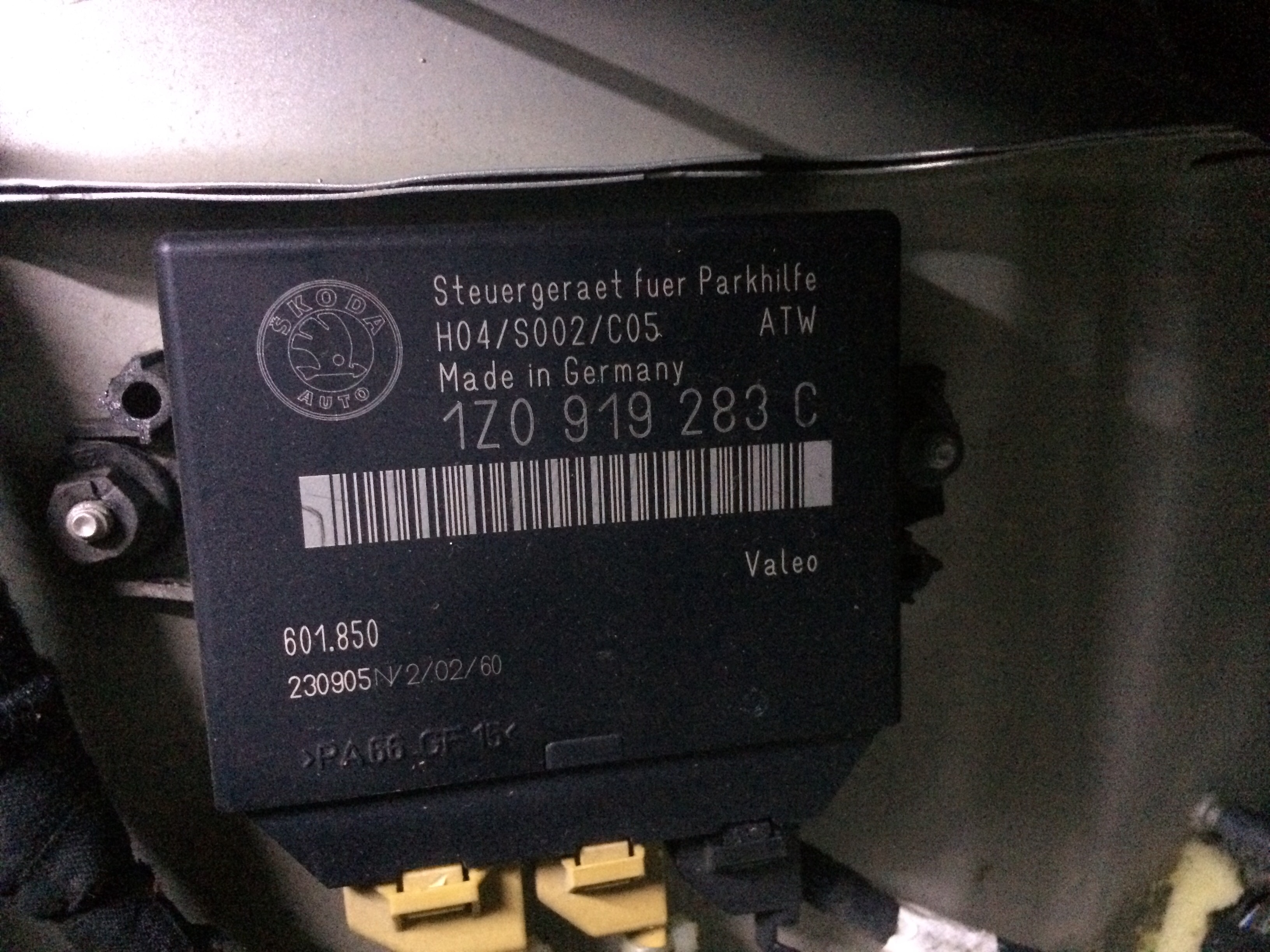

  1. The parking sensors are not displaying the data on Columbus. But the parking unit is working as I’m able to hear the beeps.

I'm Attaching herewith the pictures of parkatronic module and radio details...
Please help me in this regard. I’ll be grateful you.  Is there any need to upgrade/downgrade the firmware of Columbus.
The three major consequences you list are all standard consequences of fitting Columbus in an early Octy ( or Laura). Off the top of my head I can't remember all the details but 1 and 2 cannot be fixed through the head unit, if that can be sorted at all. But their absence seems a small price to pay for the much better head unit. The buttons issue may be fixable with a firmware fix/ change. It's definitely covered in previous threads on here because I had these same symptoms when I put a Columbus in my 2008 Octy a few years ago.
You won't get the display working for parking or climate unless you upgrade those modules and make some minor wiring changes or unless you fit a polar FIS unit.

Don't update your columbus beyond 4xxx! Mine is a newer dab columbus, and the 6xxx firmware is different and not applicable to your unit. To be honest there is not much value in changing fimware beyond your 2764, all the subsequent benefits are marginal. The link I sent was to provide the mini upgrade which takes care of the button issue.
