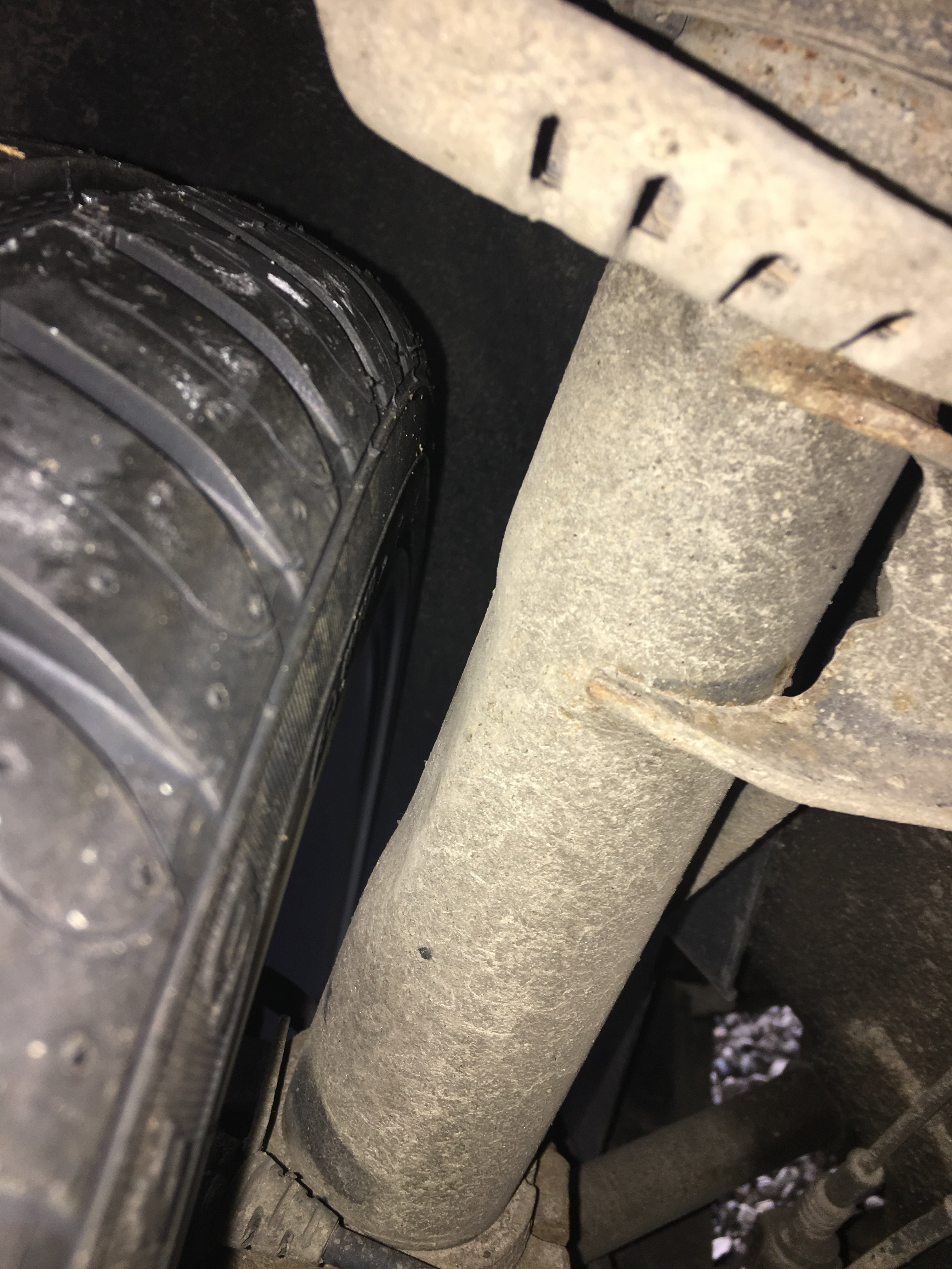

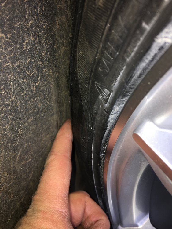

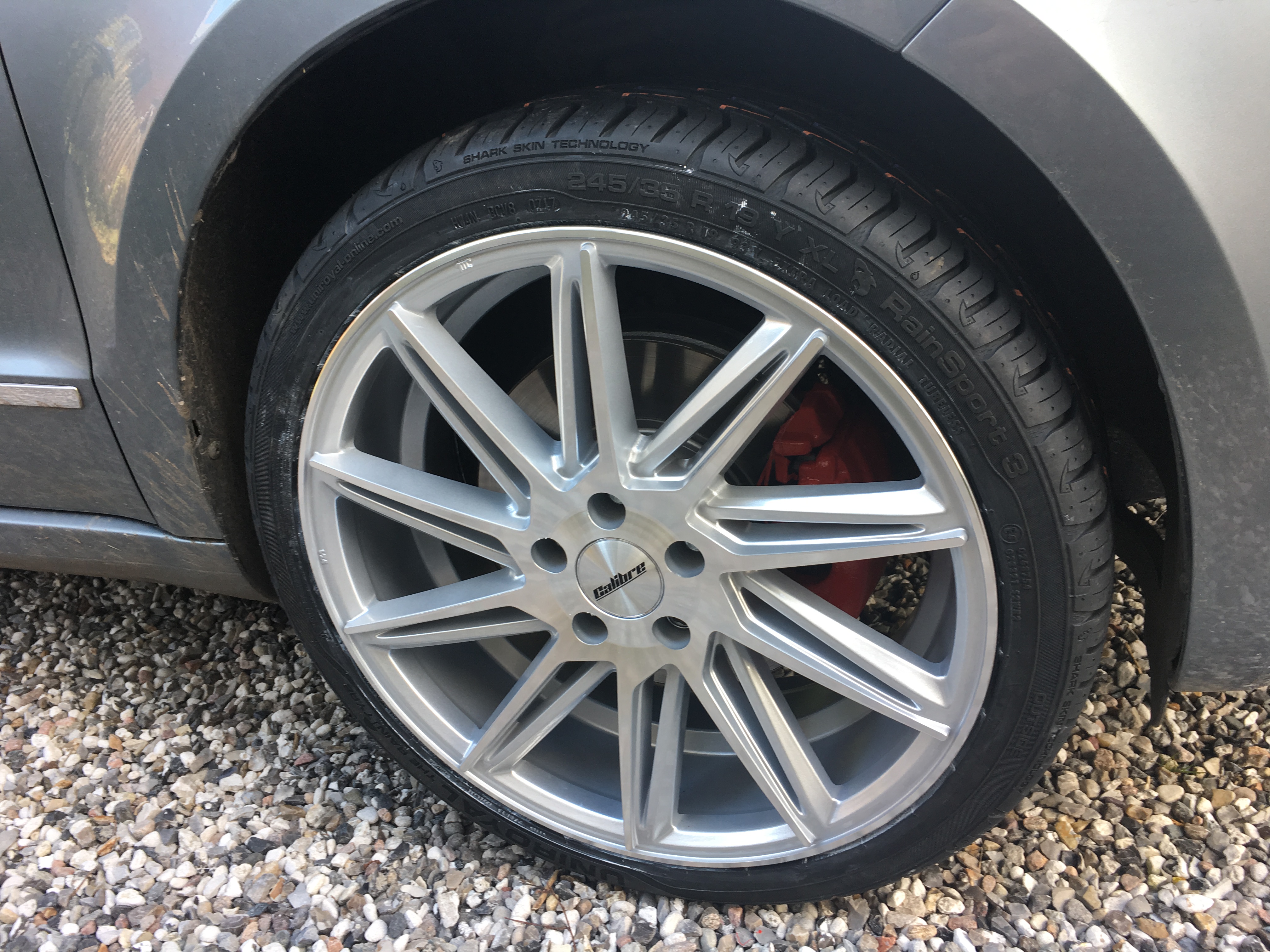

I finally received the Calibre CCA wheels I ordered before Easter. They are 19x8 et 45. Polished and silver color. Tires are Uniroyal Rainsport 3 in 245/35/19 size. I'm not super excited about the fitment of the tire on the wheel. It seems almost stretched on the 8" wheel which wasn't the case w the Audi wheels and 245/40s I had on before. But it's a different look and it's growing on me.
Fitment is nearly identical to the 18x8 et 42 Audi wheels and 245/40 tires. ~3mm further under the fenders. No rubbing in the short drive I took this evening. I have some hub centric H&R spacers that are 15mm a piece for the rears. Just need longer bolts so I can mount them. But overall fitment is good however pushed to the max. IMG_1177.thumb.JPG.c7914d4b6bac298d80135e245792c653.JPGIMG_1164.thumb.JPG.c11c2110ba72c386ff5bb0d97dcec804.JPGIMG_1174.thumb.JPG.f98568916439088a716dcc51978f39cf.JPG

Few more Picts of the fitment. Back wheels definitely need the 15mm spacers.

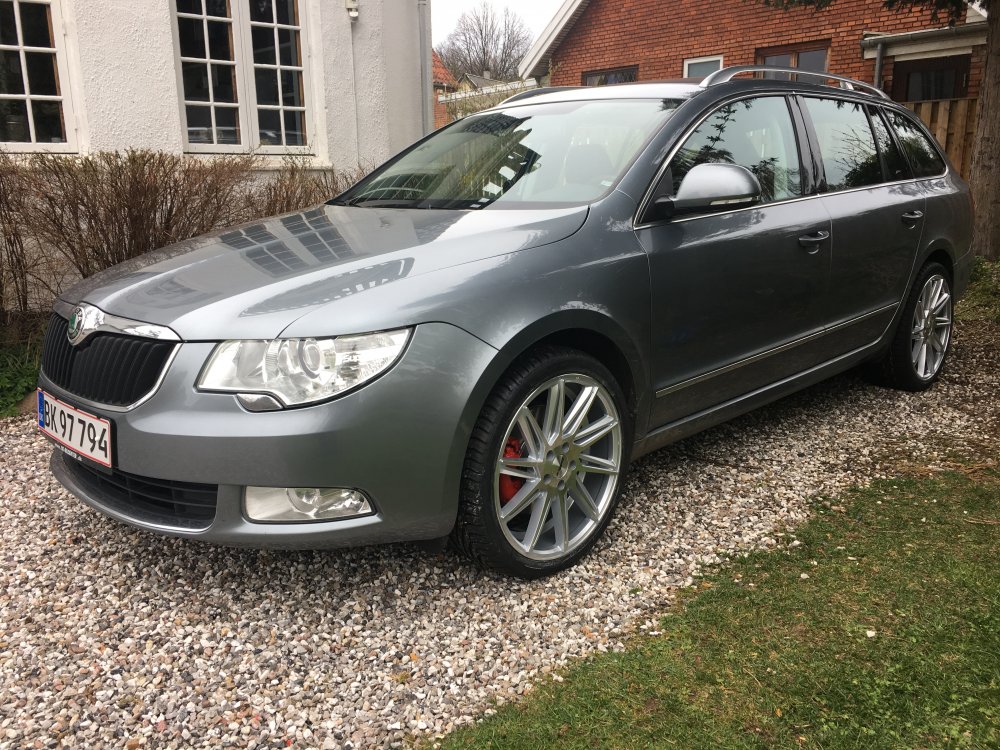

nice, love seeing different wheels on a superb estate.
i keep thinking some bentley 20" rims would looks good :)
Yeah Bentley would be cool. Lol. These wheels are growing on me. I'm liking the color on the grey Superb. And the red calipers help too.

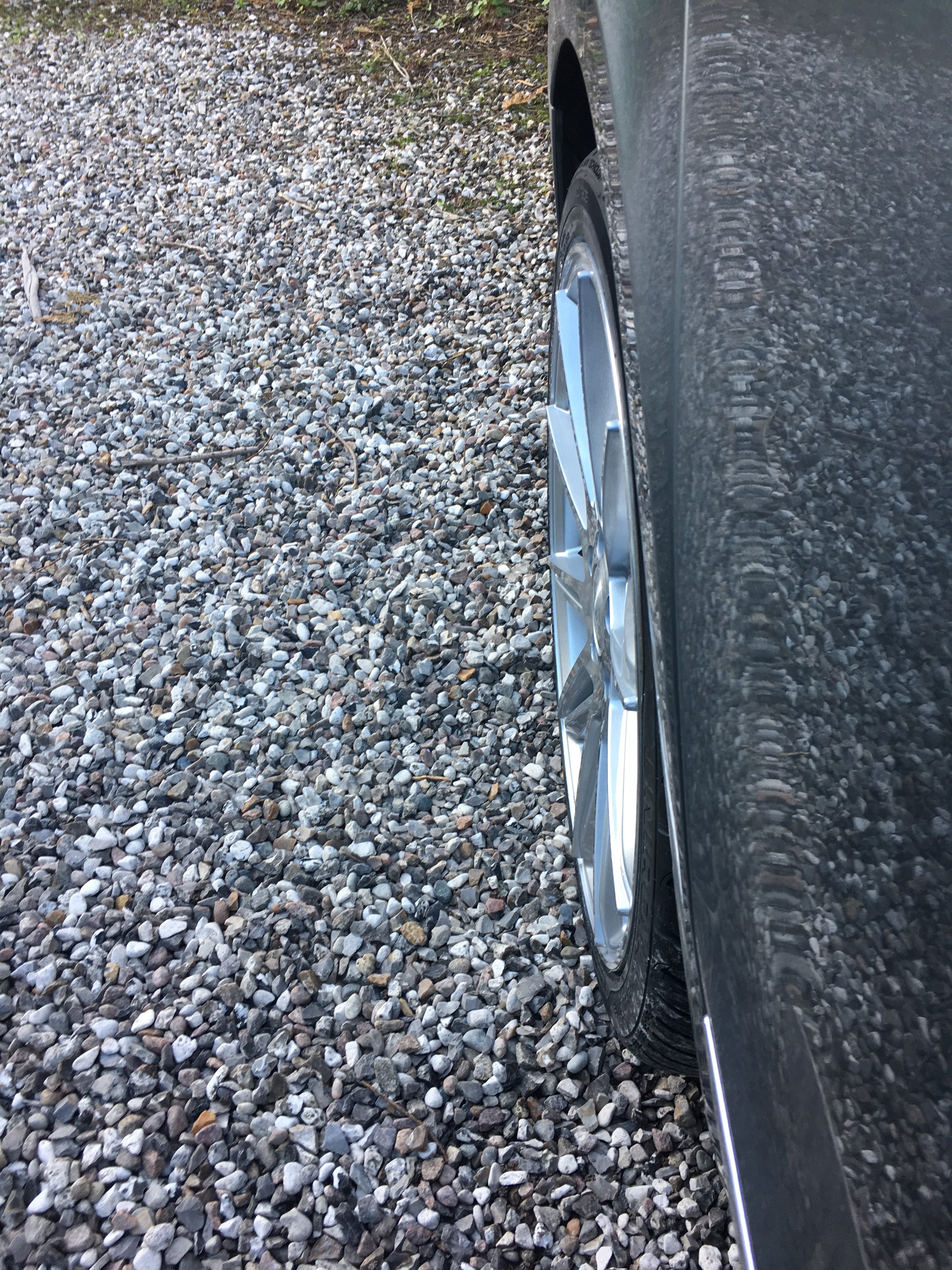

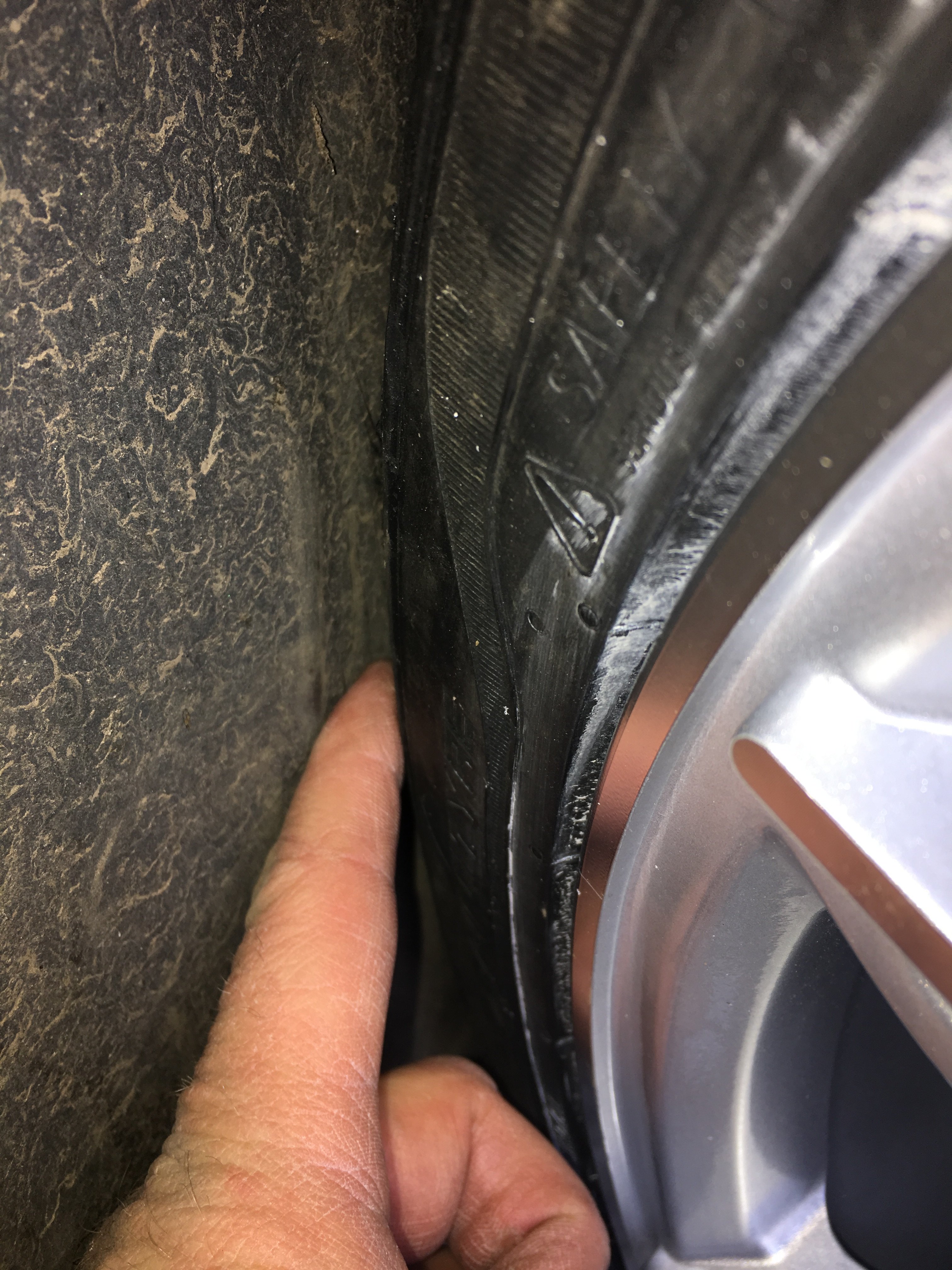

I mounted the 15mm spacers on the rear today. Had to buy some wheel bolts that were 50mm long instead of the standard 28mm. It really helped the look of the rear wheels.
