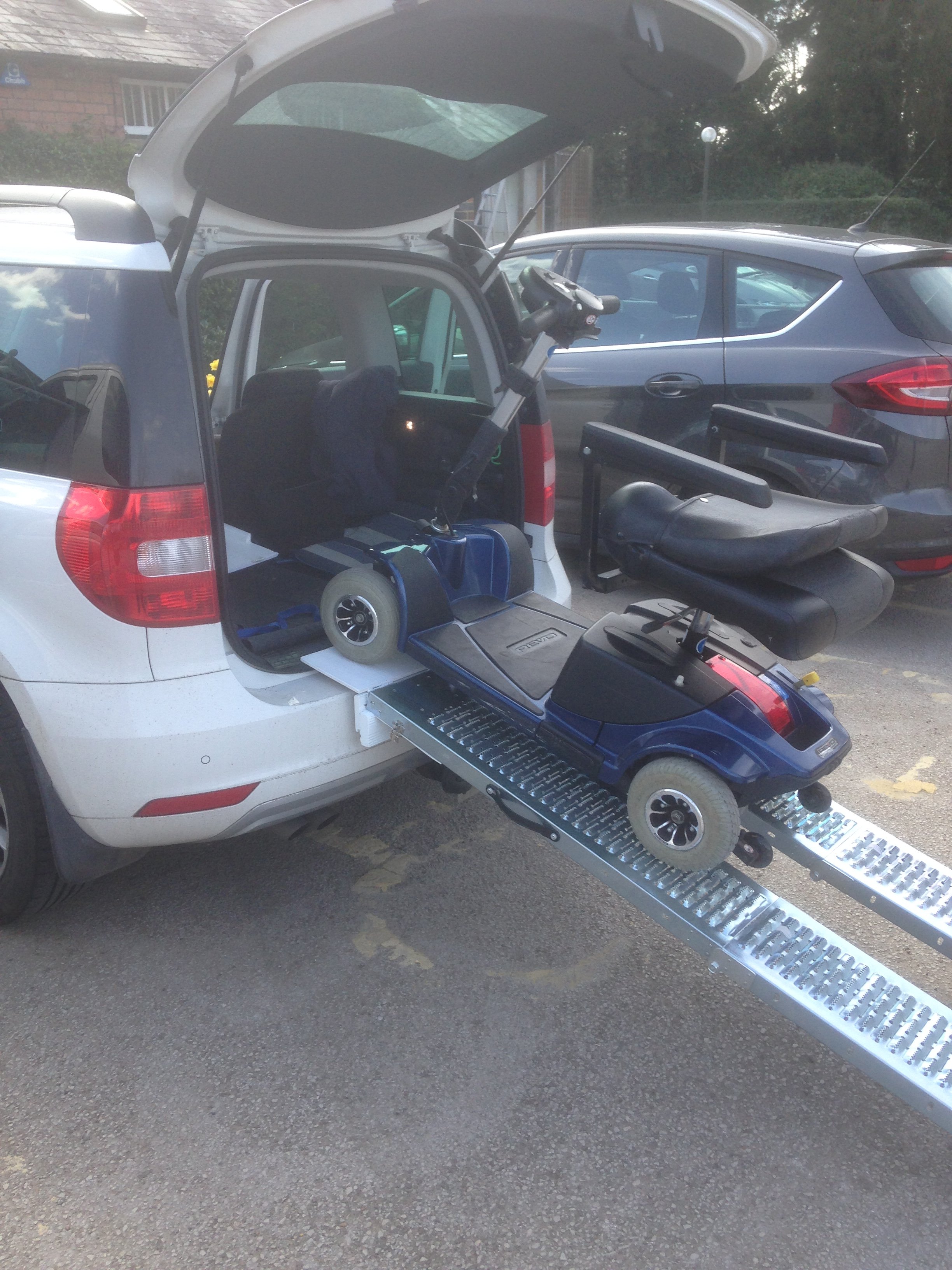

Very neat! Excellent job.

Thank you.
I took a sheet of 9 mm ply, 4'x2' sorry about mixed dimensions, shortened the 4' by a few inches so it would fit across the width of the boot when not in use.
I put an upstand on three sides, about 40 x20 mm on both sides and across the 2' top.
This sheet/tray sat above the two folded seats, so when the scooter was powered in, the weight of the scooter was on the ply and not on the rear springs on the seats. If you look at the pic, you can just see the start of the white painted ply.
I have a bike rack that clamps to a plate on the towbar, and the unused plate forms the base for the ramp support.
I have a hinged flap that goes across the bumper that protects the bumper.
I can post more pics if required.
Richard

I'm very tempted to have a go at a version of Rustic's idea once I'm able to stand on two feet again. The idea of being able just drive it in is very appealing. Dismantling and assembling isn't too difficult, but it takes time. I don't have a tow bar, but there's probably a way of securing a ramp. How long are the ramps in the picture?
The Scooter is 550 mm wide 1050 mm long and 430 mm high (seat removed, tiller folded), so hopefully, with one seat rolled forward or removed, and a plywood floor in place it might be possible to use only one half.
