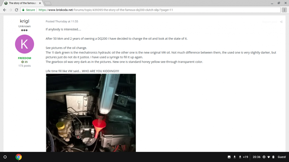

This is from the DQ200 DSG thread, posted at the weekend by the OP.  He has done an oil change of his DSG.
There is another thread by a Member in the General Servicing section.
