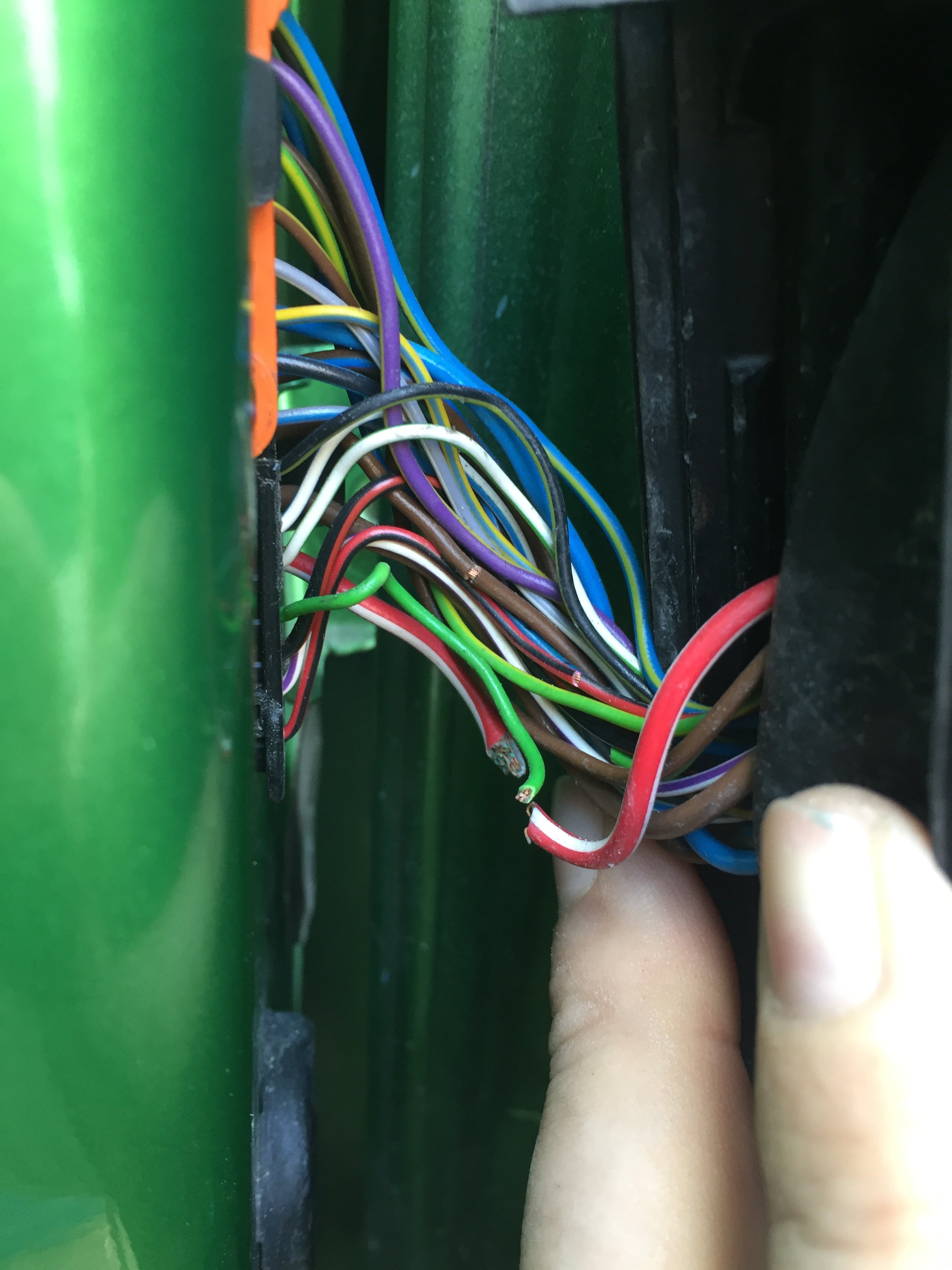

Yeah defo a door loom issue....!

Here is a prime example of the door loom issue too....getting fixed on Saturday.
