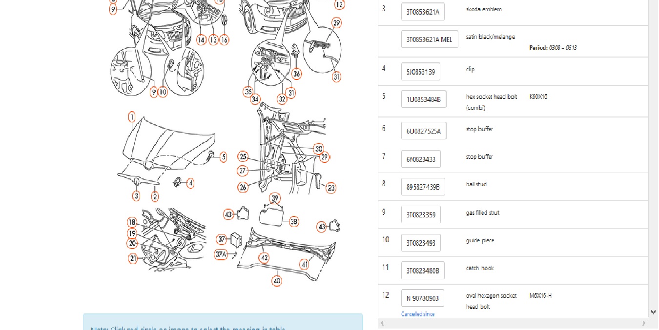

Hi,
anyone removed the chrome lip from the leading edge bonnet?
It seems to have a white clip and a dark clip, one of which looks to be attached to the trim piece itself and the dark gray/black appears to be a separate bracket of some kind the chrome trim
is attached to. Do I need to remove all of these?
Any advice greatly appreciated!
Cheers,
steve
Hi I did this a while ago, from what I can remember there is a nut / bolt to undo somewhere in the vacinity of the badge. all clips pop out and need to be transferred to the ned chrome part if replacing. IIRC they slide in and out of the removed chrome housing. Below is the best image that I can find for the assembly, easy job less than 5 minutes, I used a bit of vaseline on the clips on reassembly, they do need a firm push, I'm a bit paranoid about rust, too many Mini's and Metro's in the past!!! Hope this helps.

image added
