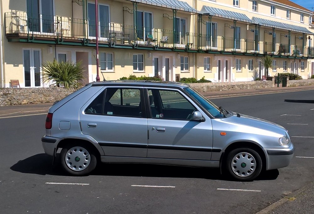

In comparison to the quantity of engine oil that the lazy 1.6 engine 'eats' by default (thank you, VW), the leak you are talking about is nothing. Judging by the size of the photo of your car, I can fully understand that you are in a prolonged honeymoon with your car and that you polish it daily :) outside, inside and in the engine bay, but you should concentrate on major things. A third party rocker cover gasket could be leaky by default or the torque you applied was not by the book. Check the flatness of both mating surfaces too.

is it that obvious that I'm still honeymooning haha :).
Let me see... ummm... YEAH! :D
Washed car (wheels too!), shiny paint, car perfectly parked, good sun, good background aso. This means LOVE. Not to mention the pretext with that drop of leaking oil, in fact just for showing us your car :) I know that kind of urge.

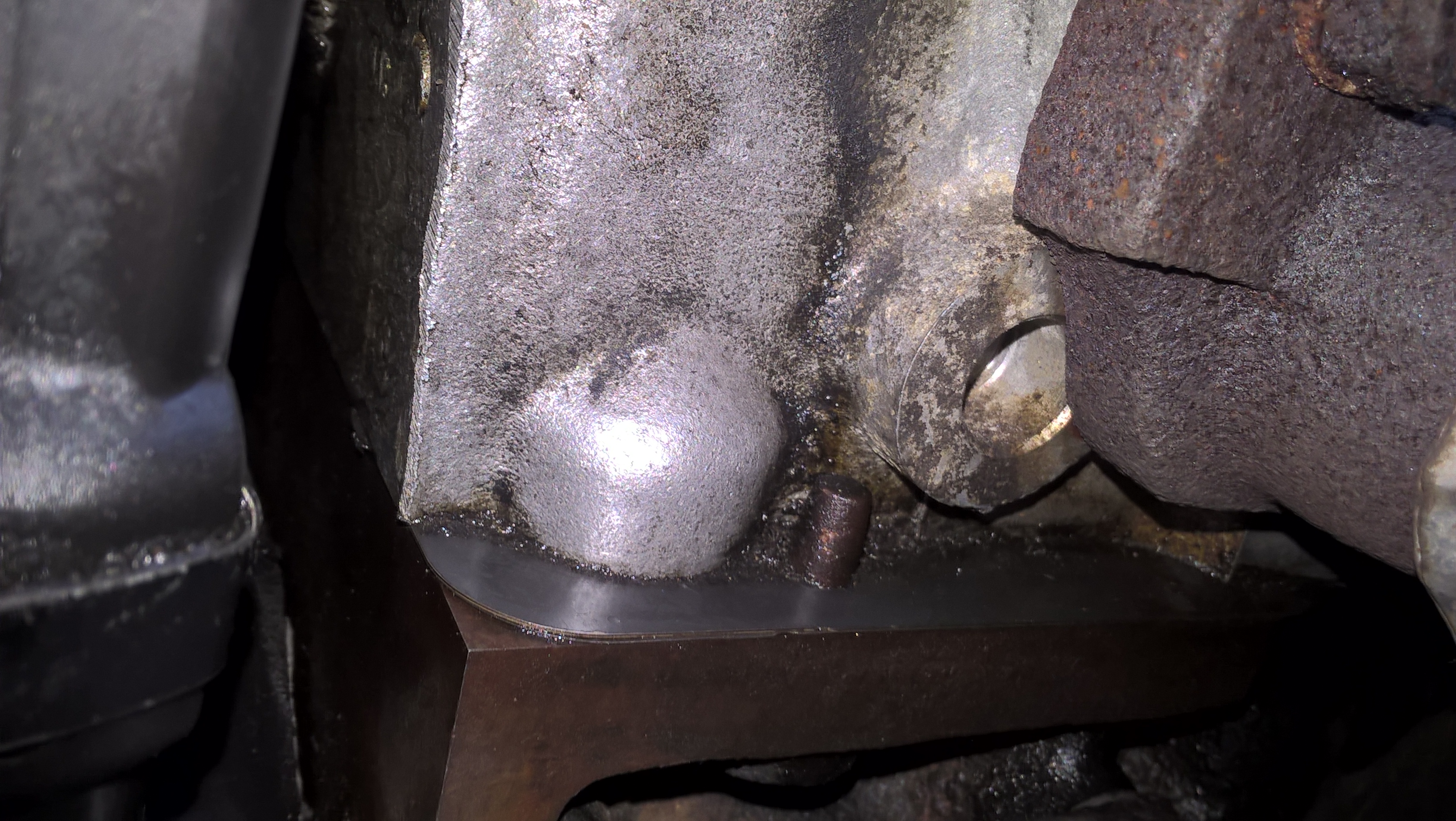

Hi all, bit of an update and questions. I've been keeping a close eye on the external oil leaks on the felly. the rocker cover leak seems unchanged, however I've noticed what looks like another leak from a different area of the engine which has very gradually built up after cleaning it a few months back. Just above where the alternator bolts to the block there is a collection of oil around the head gasket area, front left corner when looking at engine from the front of car, and also a bit collecting on the cambelt cover just to the left of that corner. No loss of coolant, no mayo on dipstick, and oil level hasn't dropped :S also car runs very sweetly. I've seen on another thread that there is an oil gallery internally on that corner of the head gasket which could leak outwards?

Second advice: a failed head gasket can leak oil outside indeed. It is not that often than let's say leaking coolant into combustion chamber but it happens. So keep an eye on it.
Thanks, here's a pic of the offending area, weirdly now I've taken the photo, it looks like the oil is trailing from above the head and collecting there which was difficult to see with just a torch.. Maybe the cam seal at the top, or just the same rocker leak from before :s.

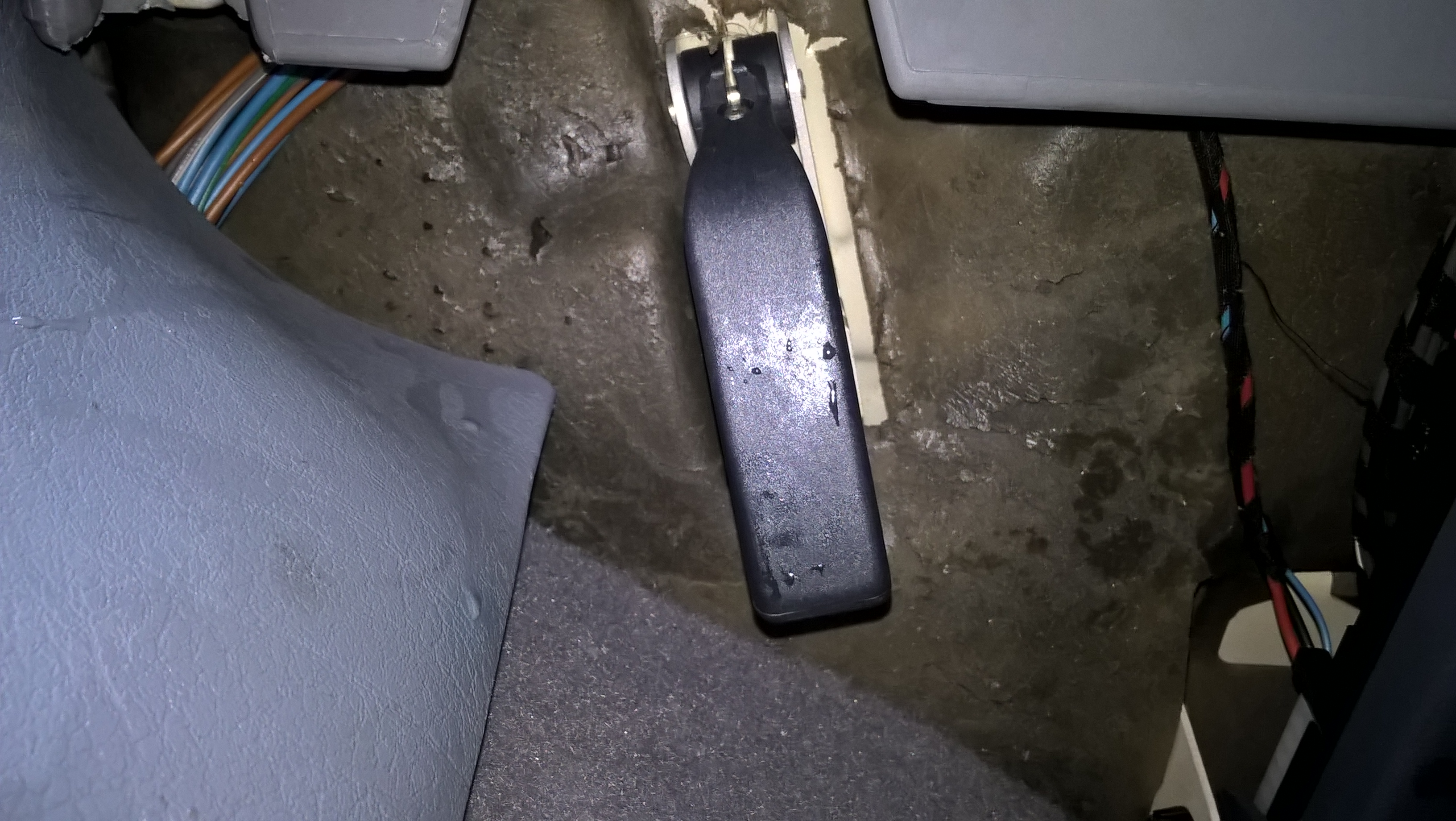

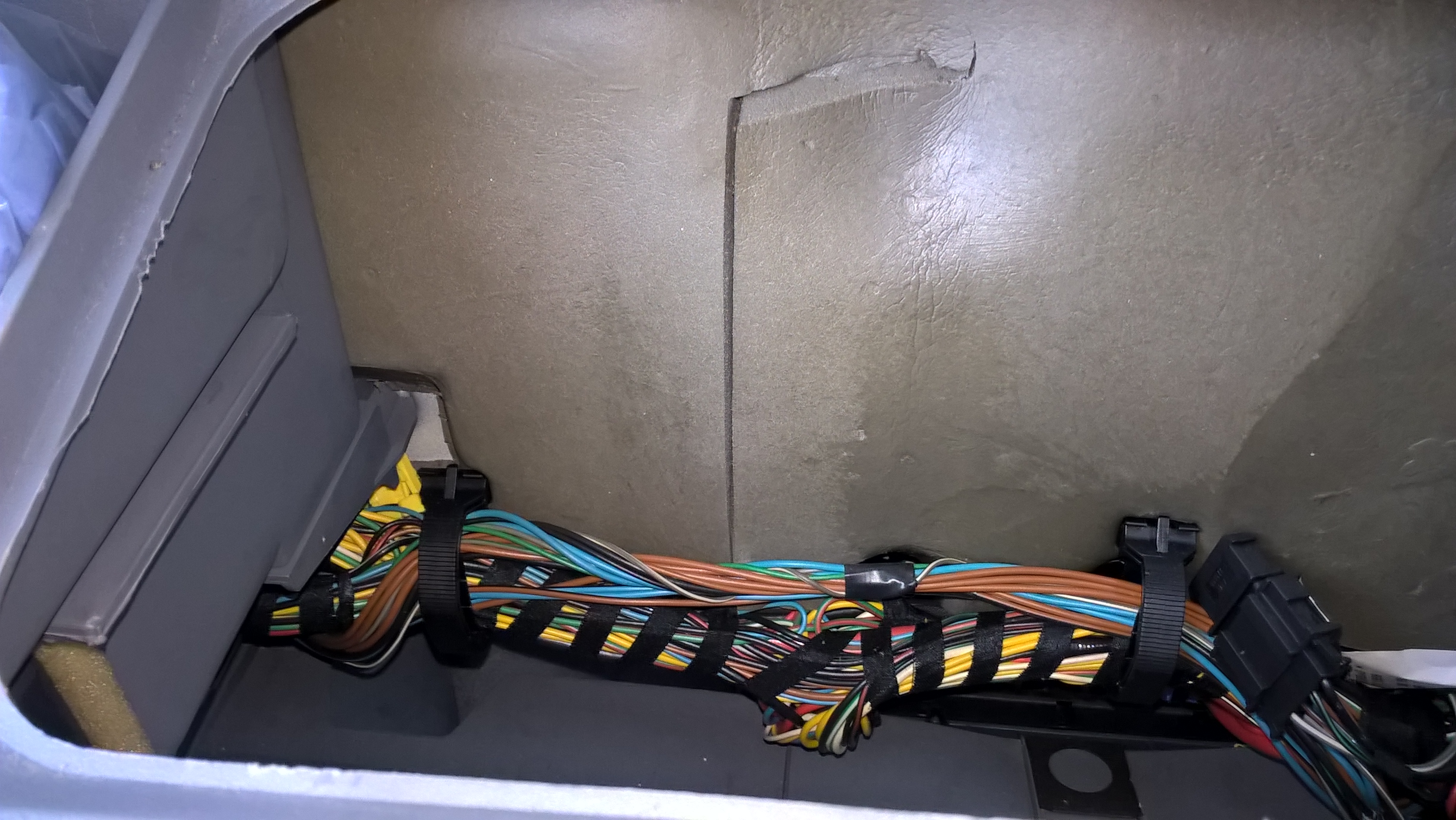

Ok! Here is a photo of the bonnet lever, and also inside the removed glove box compartment. No water in glove box area/wires, only just below to the left, which is where the bonnet lever is. All around the bonnet lever is sopping, I've squeezed most of the water out but there are multiple wires etc in that area.. Had a look in engine bay directly opposite this area but its dry on that side but I may be missing something. Also its ****ing down so I'm soaked too :crying:
looked in wheel arch and no sign of holes, no water directly behind windscreen either, which is what some other threads suggest. A bit stumped. I'll keep looking though, I'm hoping its something obvious. Only noticed it today but I'm guessing the spongey material has been soaking it up for some time because the weather is generally wet!

Umm... I'd say there wasn't a big enough, long enough rain. Anyway it's the windscreen seal and corrosion indeed. It is common to cars with not resin bonded windows.

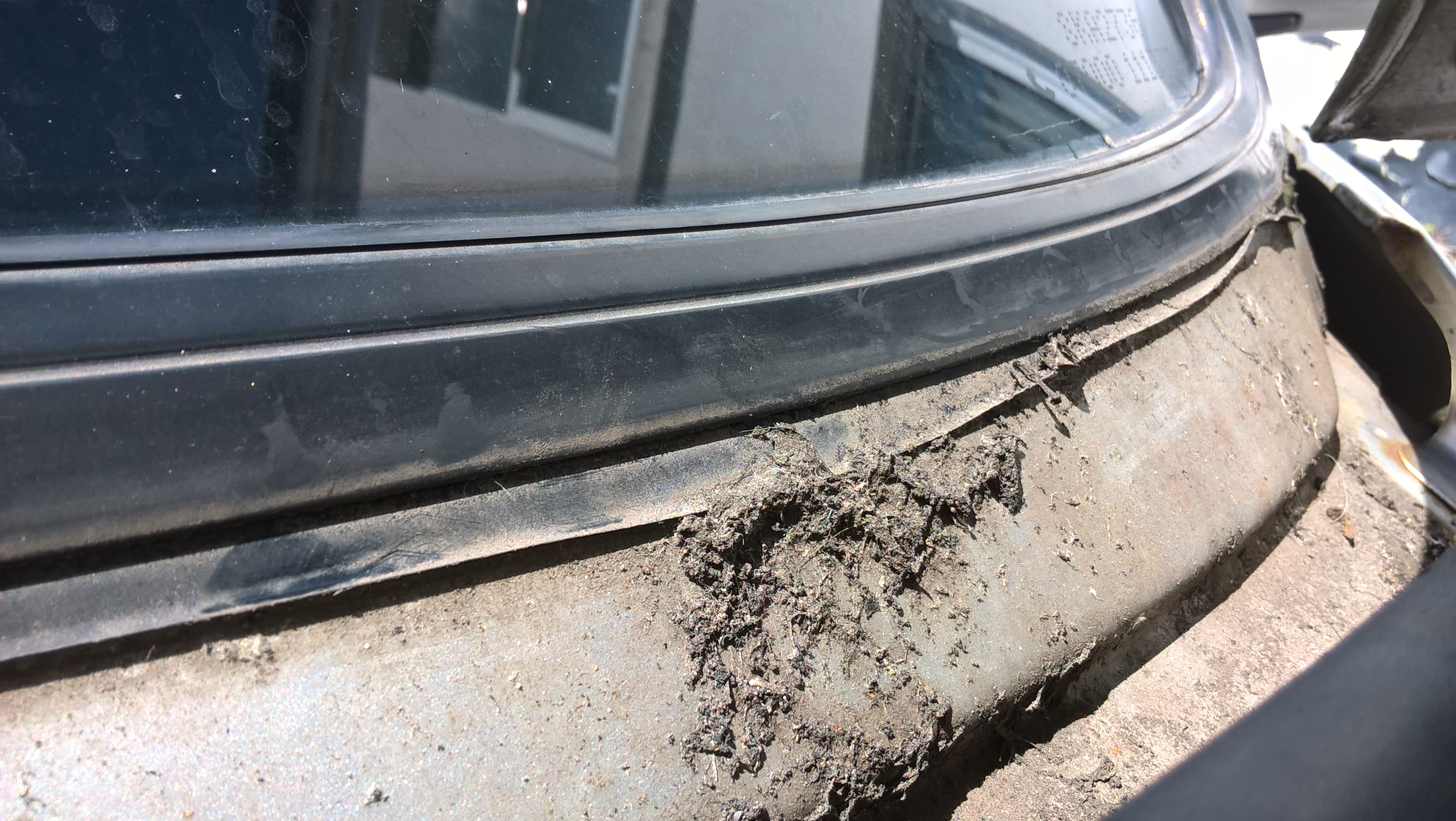

Here is a photo of the condition underneath the scuttle panel. I did this a few weeks ago to try and find the windscreen leak. The weatherproof tape was all dried out and useless looking, and also there was loads if dry crispy old sealant under the rubber seal. Also a rust bubble in one area which I have yet to scrape off and treat.. I filled the bottom corners and lower edge with silicone sealant, but only used a tube, not a sealant gun. This meant that when applying the sealant my thumb broke the tube and it became very difficult to get a good flow of sealant from the tube so avoid that! I've since bought a sealant gun and will try and make a better job of it when I get the time. Thanks again.
