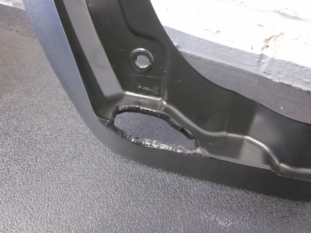

First of ... cutting a part of the plastic trim away (I really fail to see why Skoda could not have made the part the right shape in the first place, or moulded the mudflaps to suit).

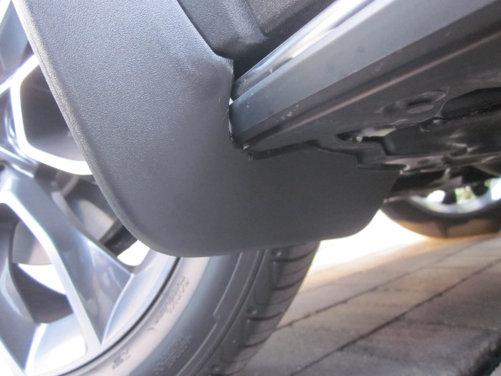

Offer up the mudflap, making sure to push the tabs over the rail on the underside:

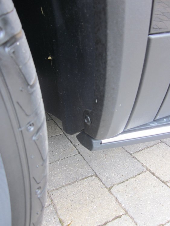

Now the next part requires drilling a hole. The instructions say to use the push fit buttons included, but I used one of the torx screws I removed from the liner trim:
And use the screw (or button if you prefer) and tighten:
Then you can use the clamp provided to fix the flaps to the rail (a bit overkill I thought, already the flap is solid and not going anywere):

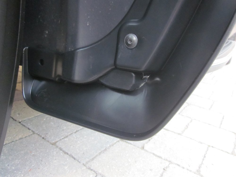

The rears are just a case of removing 4 torx screws from the liner, offering up mudflap and fixing with replacement torx screws.
