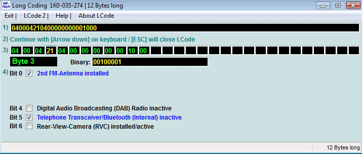

Because I have an Amundsen+ radio I wanted to enable the built in bluetooth, which my device has. I connected to the car with VCDS to find out that the internal Amundsen+ module has allready been enabled and I can't disable it. Coding is accepted but when you reopen the long coding the tick is removed from the bit where it says that the internal bluetooth module inactive. You can see which bit I mean on the picture below (VCDS screenshoot, but not from my car).

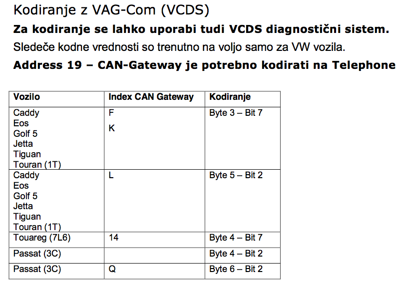

This is from the Fiscon installation manual:
Coding with VAG-Com (VCDS) VCDS can also be used for coding. The following coding values are available for VW vehicles so far. Address 19 – CAN-Gateway needs to be coded to Telephone. More is visible on the picture below. What do I have to do to remove the coding for Fiscon? I went to address 19 CAN Gateway -> Install list (drop down) and removed the tick at option 77 Telephone. Is this it or do I have to do anything else? What are the bytes and bits in the table. In CAN Gateway long coding I only have bytes 0, 1 and 2. No bytes 3 and 5

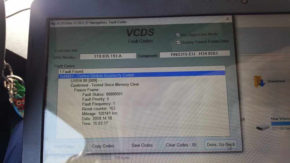

I've also attached a photo of a fault, when the Fiscon has still been connected to the CAN network in the car. Later I've disconected it and the fault went away so there has also been a problem with coding.

Do the installation instructions for the Fiscon module contain coding instructions? If they do, then following them in reverse should work. Alternatively, if you can find someone with a standard Amundsen setup like yours and copy their coding, it should work.
A current version of VCDS will have the long-coding helper too which should provide information on each part of the coding block and make it easier to figure out what's going on.
