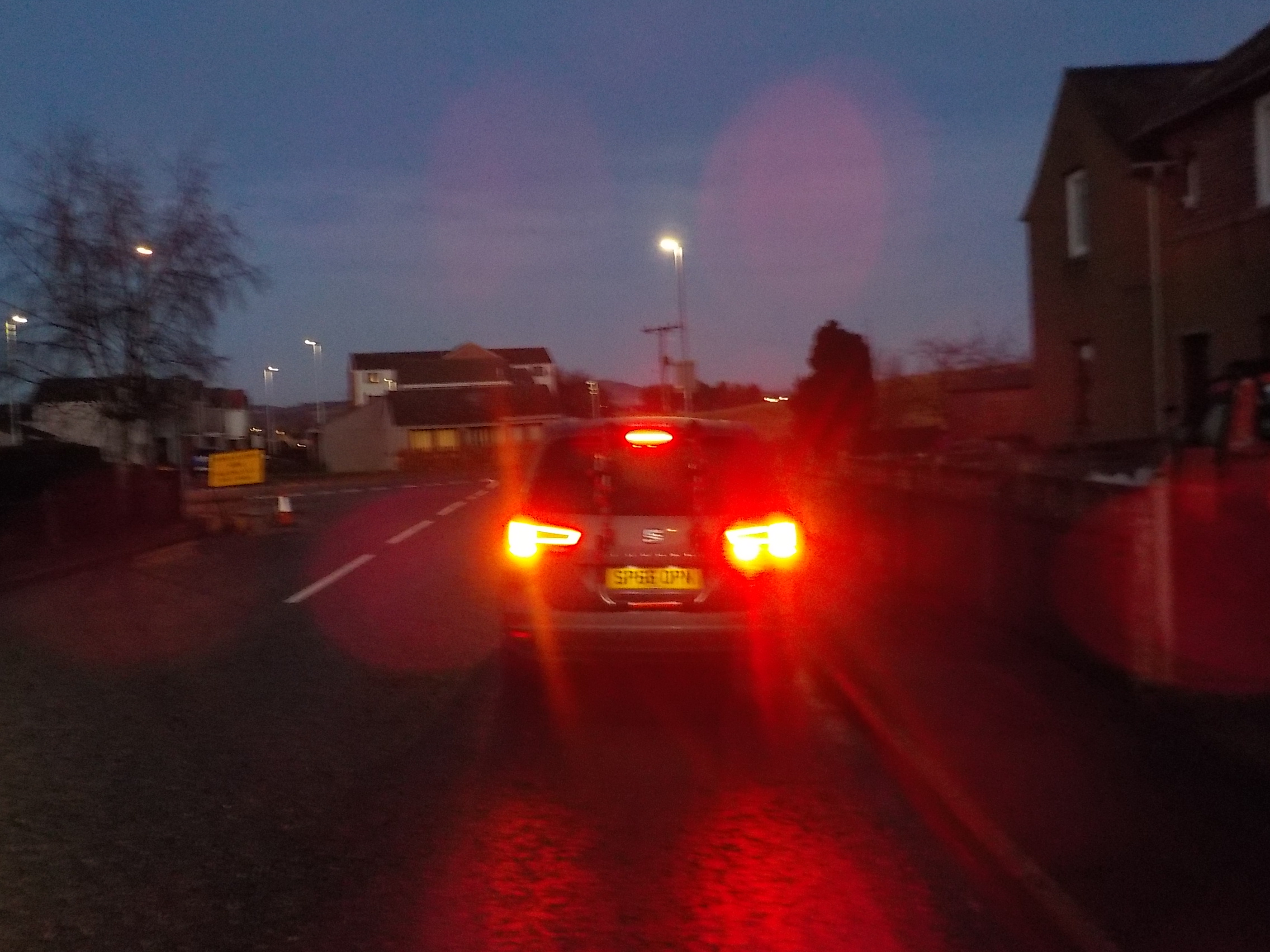

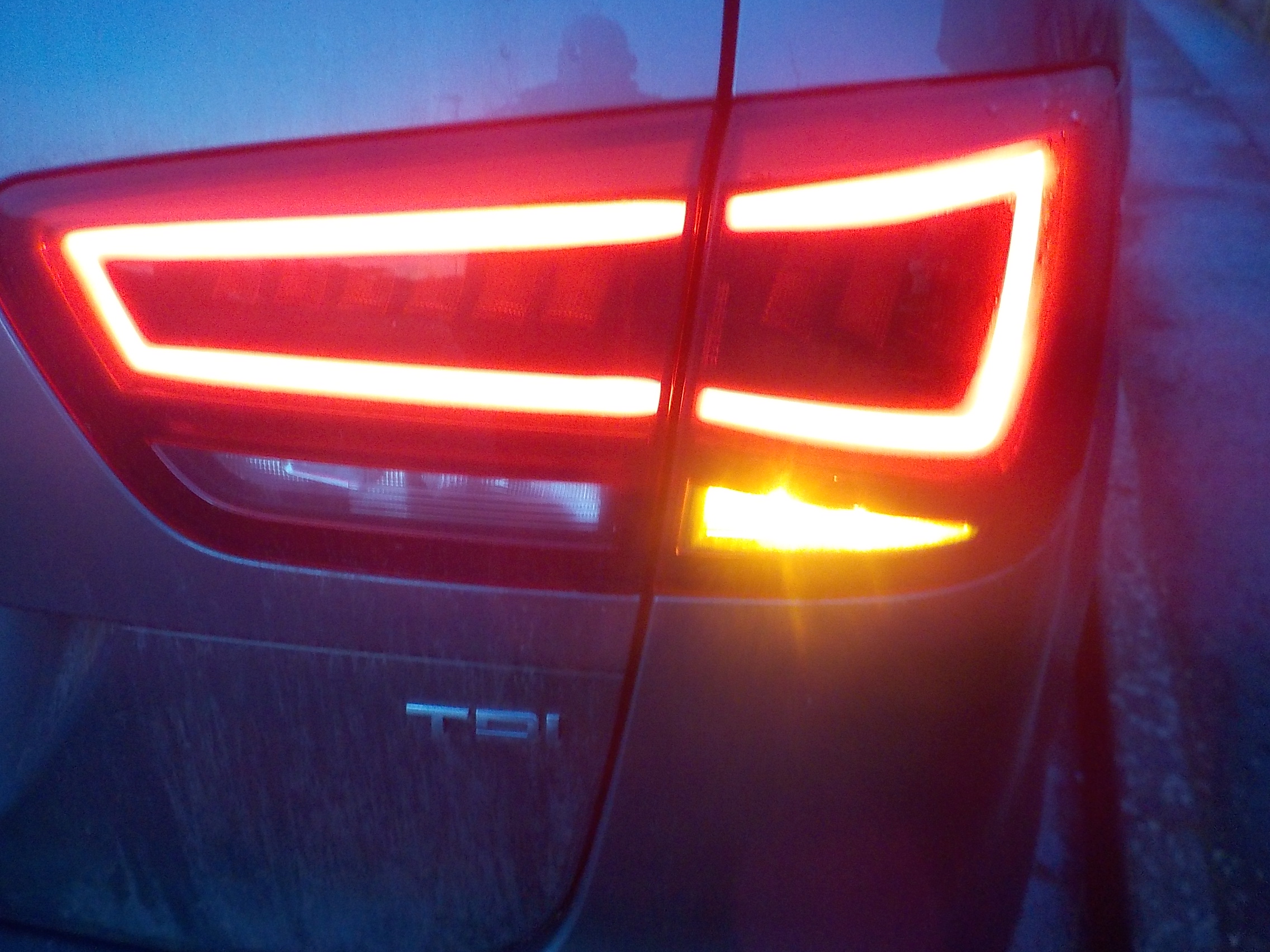

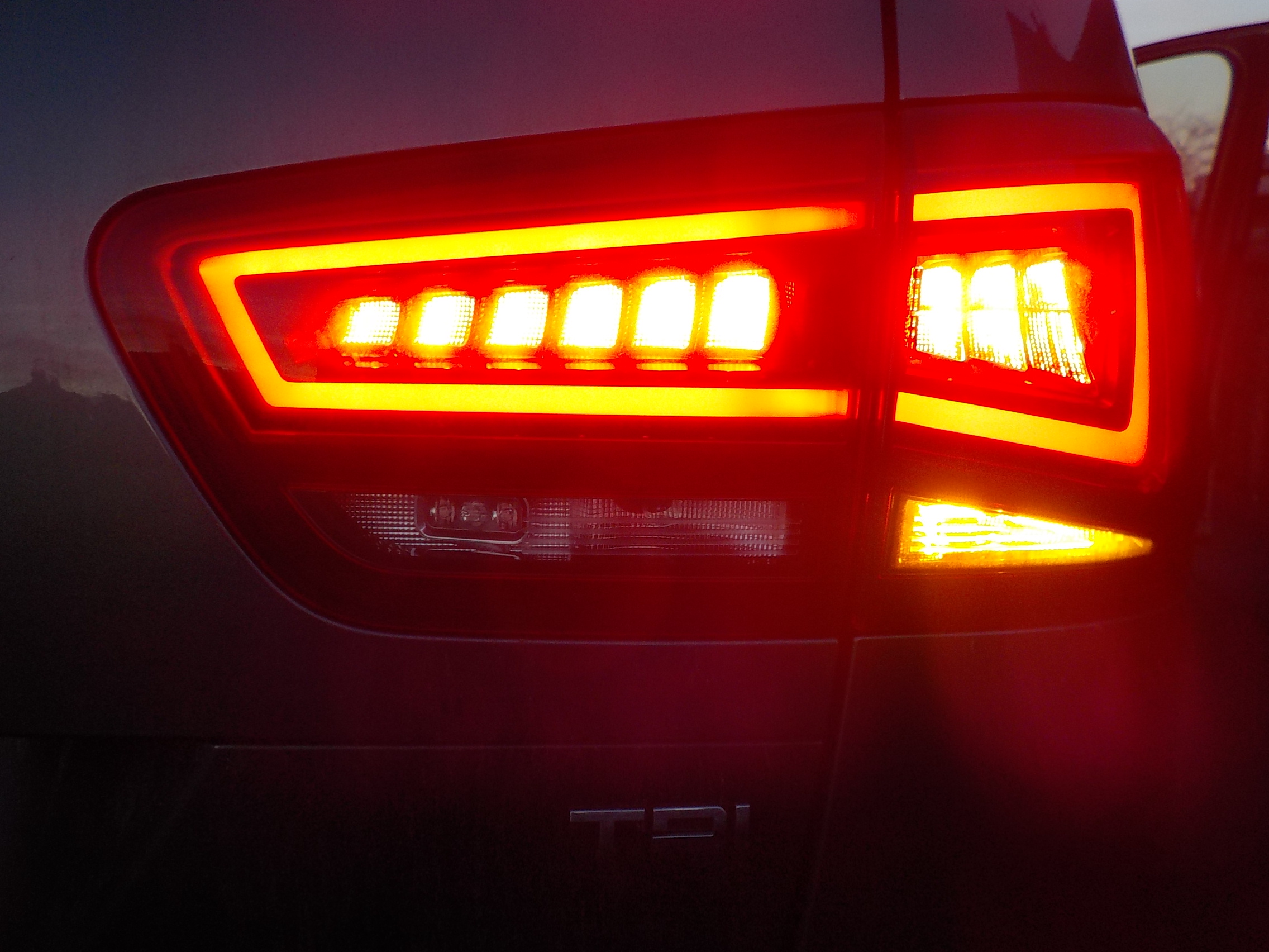

My Alhambra was built October 2016 so a current VW Group car and the brake lights do not illuminate with 'Auto Hold'.
If they did i would not use Auto Hold because the rear lights are terrible to road users sitting behind, i know i have followed my car and others.
(Bottom fog light on as well as brakes.)

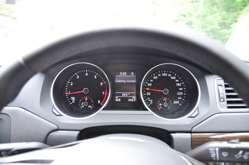

AFAIK the coast mode only operates if the drive mode is ECO, it doesn't work in normal or sport modes. Shame it doesn't work in normal mode as the throttle seems a bit more responsive than in the eco mode.
The one in my edited post does.
