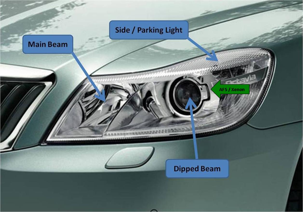

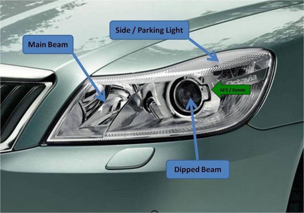

Whilst is isn't possible to differentiate the pre-FL headlights it is possible on the facelift (FL)...
Pre-FL vRS with xenon's (equipped with headlight washers)...
Image result for silver1011 octavia xenon headlights
