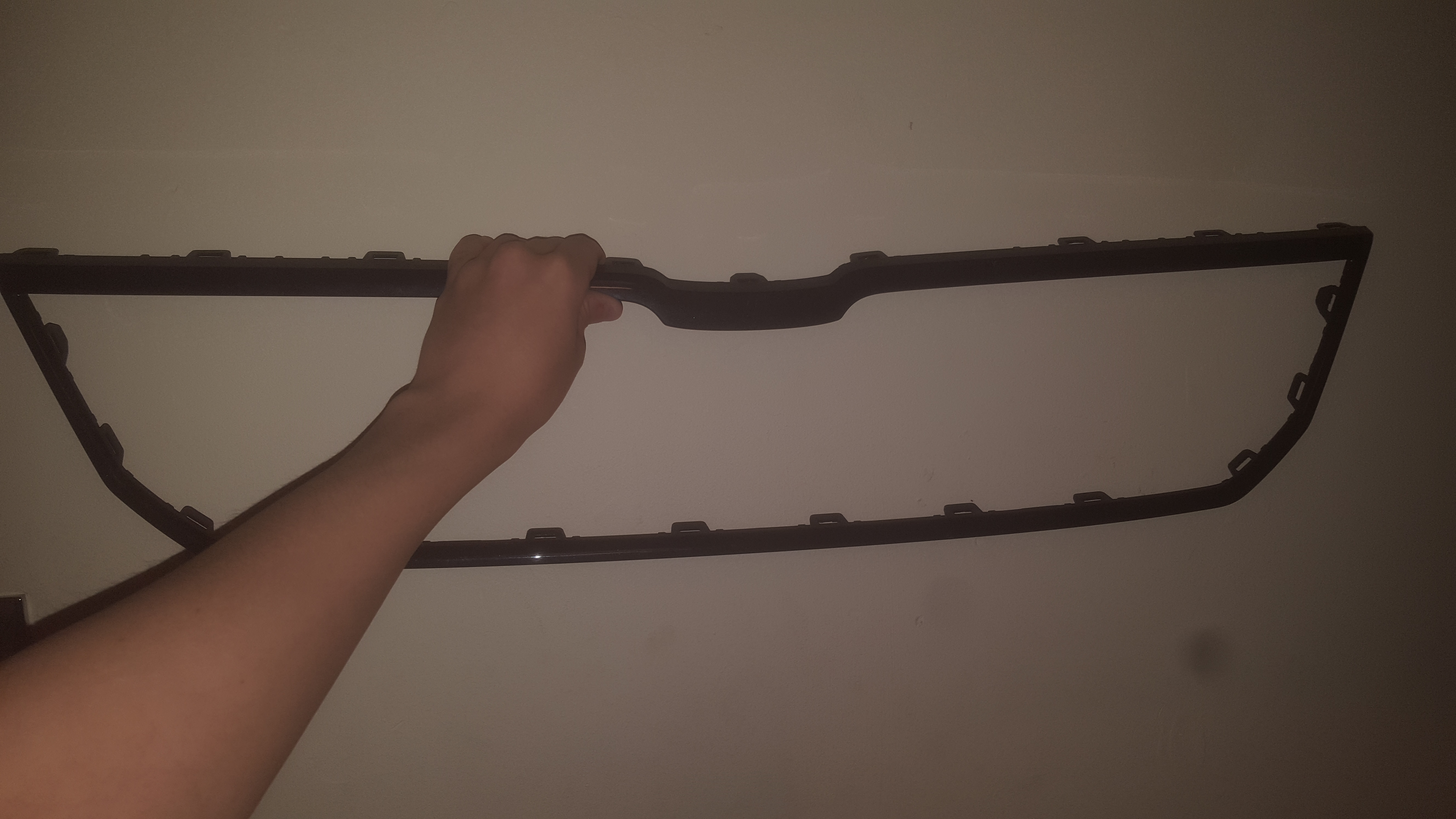

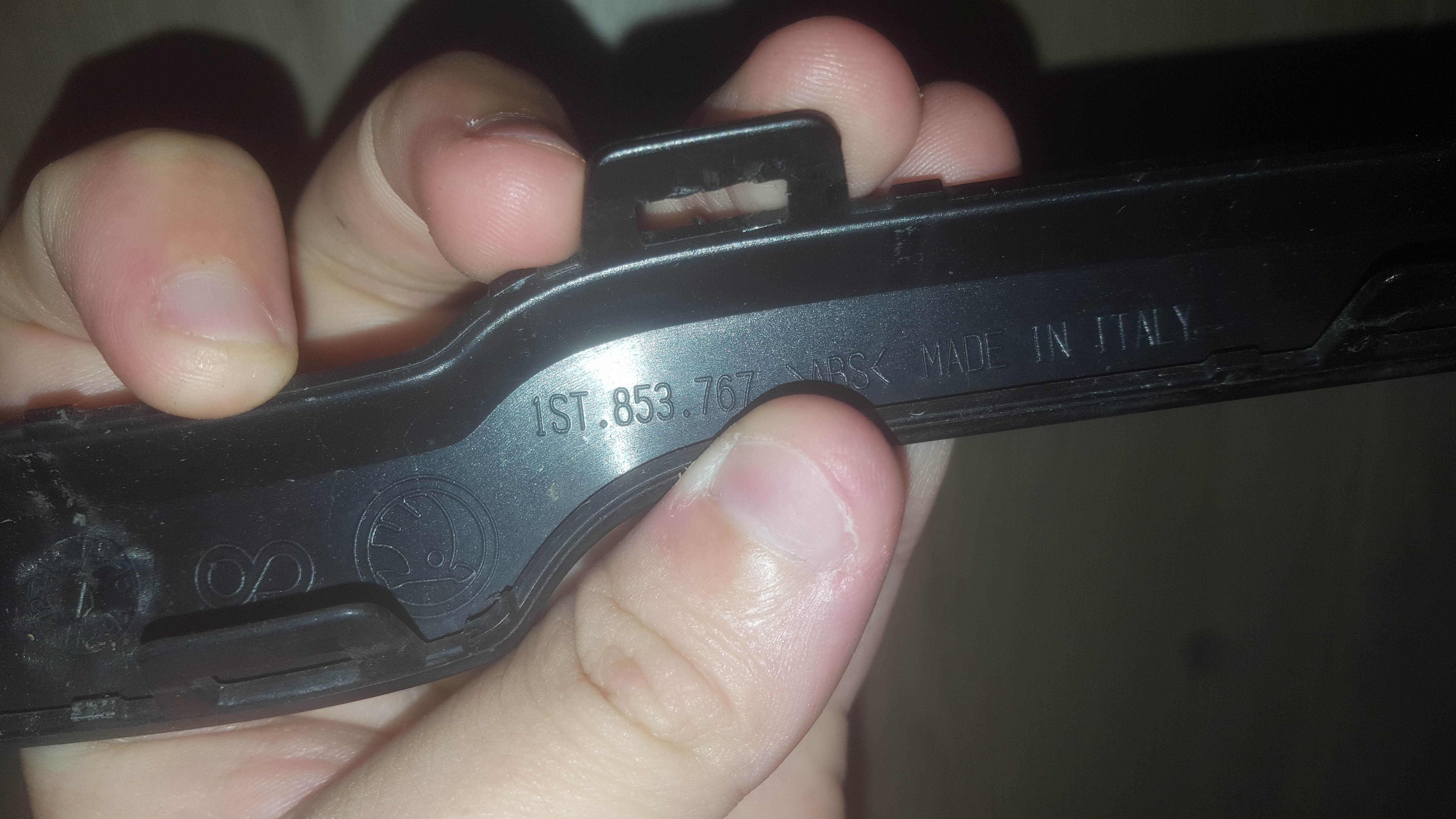

You don't need a whole grille chap, the part number for the black & chrome grille surround is 1ST 853 767 (yes they are the same! From what I can gather one part number has a "A" after and the other a "B" but this isn't given on the actual part), the silver surround will unclip out, allowing you to clip the black one in, if I'm not mistaken the link about gives a guide to removing the surround too.
