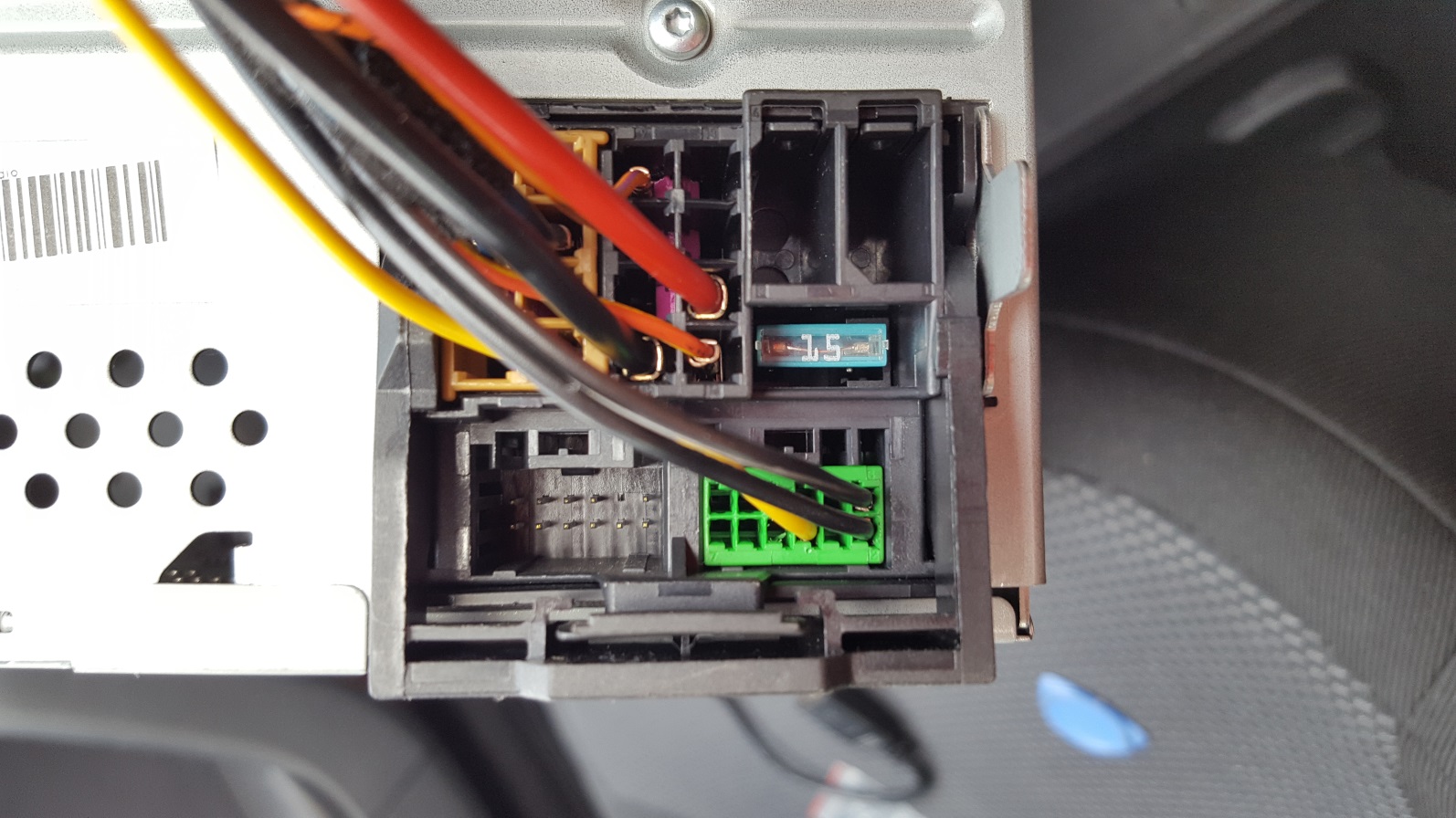

I've also noticed that playing music from the phone through the Bluetooth Car Kit seems to only come out through one speaker. I'm wondering if it has something to do with there only being one 'Mic' connection to the back of the Radio (see attached pic).

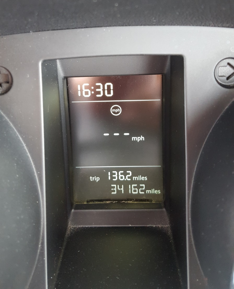

2) MPH Display
While playing with the different display settings I found what appears to be a digital speedo except it doesn't display anything, it just shows
"- - - mph" even when driving (see attached pic). It is not the mandatory km/h display as that replaces the Total Mileage value at the bottom of the display any time the car is moving. So...
Question 3 - If this is a digital speedometer why isn't it working, or if it ISN'T what is it?

The --- mph is a speed warning function. You can set it to 'bong' when you exceed a certain speed.
Large MPH setting needs to be activated, with VCDS.
Thanks for the reply Wardy. The --- MPH Display is indeed a Speed Warning mode which I have now set to a useful value. I originally didn't think the UK Models had the Speed Warning mode which is why I ignored that part of the manual.

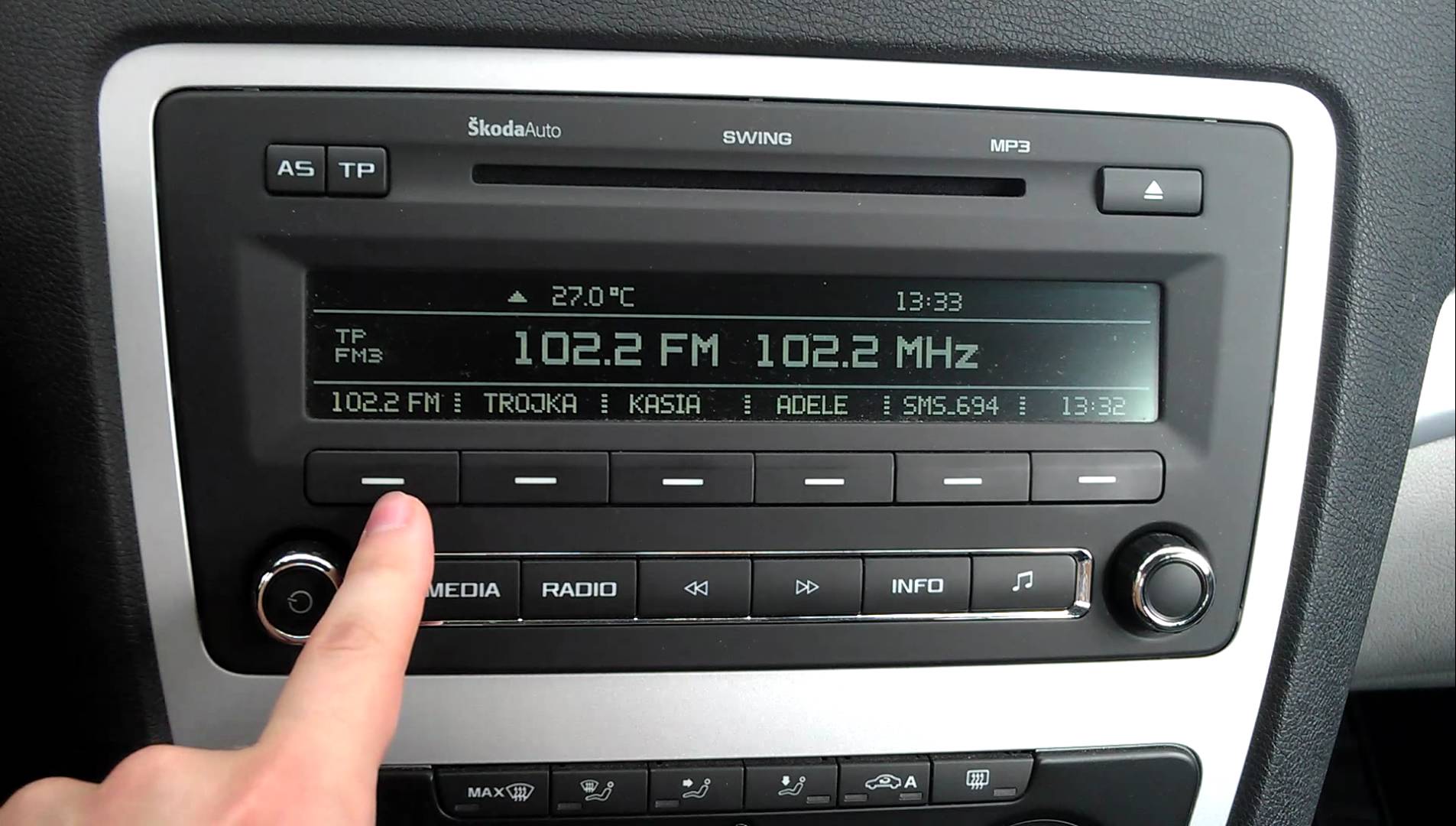

Nice radio but that appears to be a new Swing unit whereas I have the original which looks like this;
Yetis with a SD Card slot in the Glovebox have the optional MDI Kit installed as the big box part of the kit is usually installed behind the Glovebox with the cables sticking out into the Glovebox. I've already checked this so I know I haven't got one, hence my first two questions :-)
OK I see, that's the same version I had in my last Fabia (Mk2 vRS).
That had the MDI kit fitted. So I would say that the only way you're going to be able to use external devices, is to retrofit the MDI kit.
