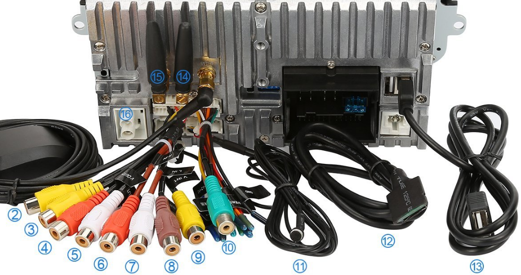

Best way to check what connections you need to plug into the back of the unit is to pull it out and check what's on the back :) I find with the joying and other chinese android HUs the rear connections can vary quite a bit. For example mine has the dual fakra built in along with the can-bus decoder. The other one came with a quadlock extension with the can-bus decoder in the line and a dual fakra to din aerial adaptor
Cheers buddy. As Rustynuts says, the new aerial gives me AM/FM, DAB(+), GPS and GSM. I've had the unit out a number of times to do stuff, and I'm pretty sure it's SMA females, but I'll double check. I also have the built in Quad-lock and dual fakra for FM/AM :) Thinking about buying the Joying amp as well, but afraid there wont be enough space behind the head unit..

If that's what the back of your unit looks like. Then yes it will be SMA males you will need.
This is my unit. I was wrong about the quadlock, that was on my previous unit. This one has a cable with quadlock on it, not on the box itself. The dab radio is provided by the Joying USB dab-stick.
GPS connection looks the same.
