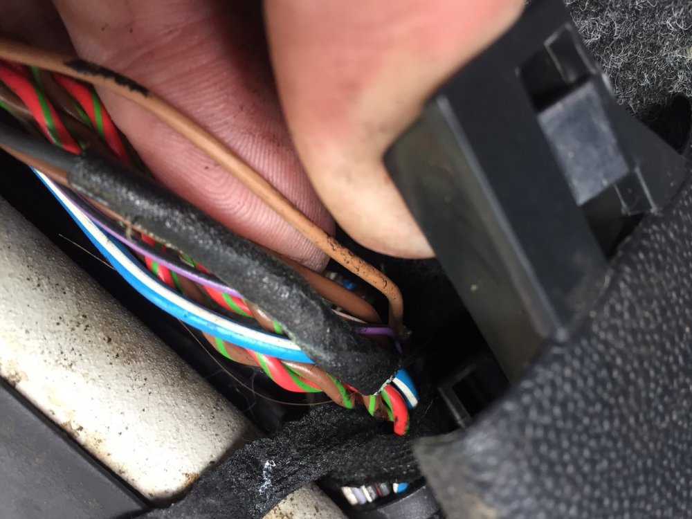

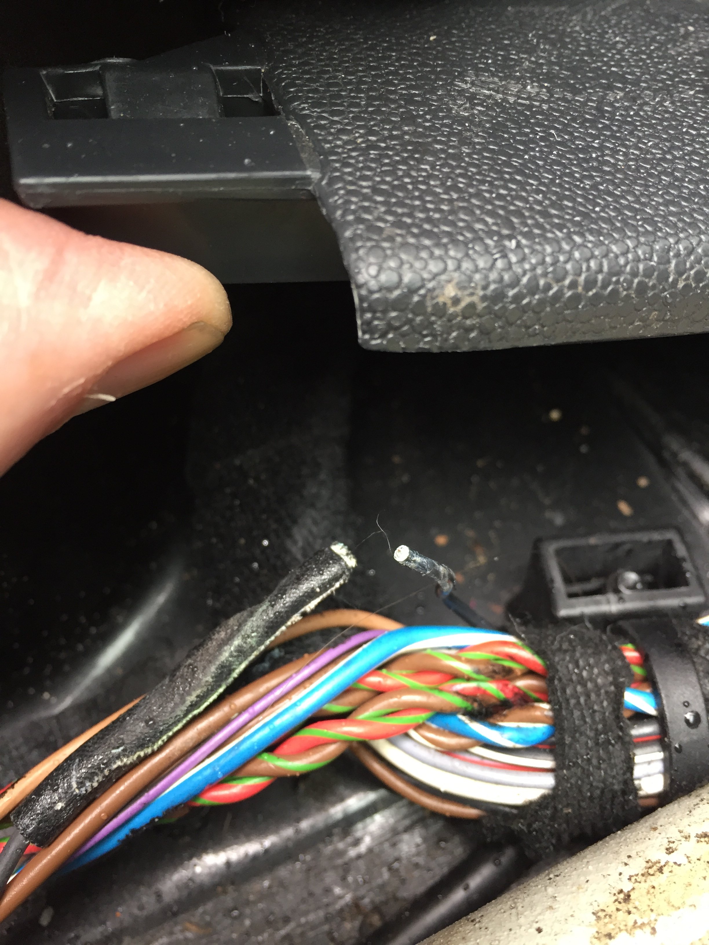

  • Look what happened when I started removing the tape from the black wire......PS I applied very little pressure :-   removed the rest of the tape and look at this mess.....

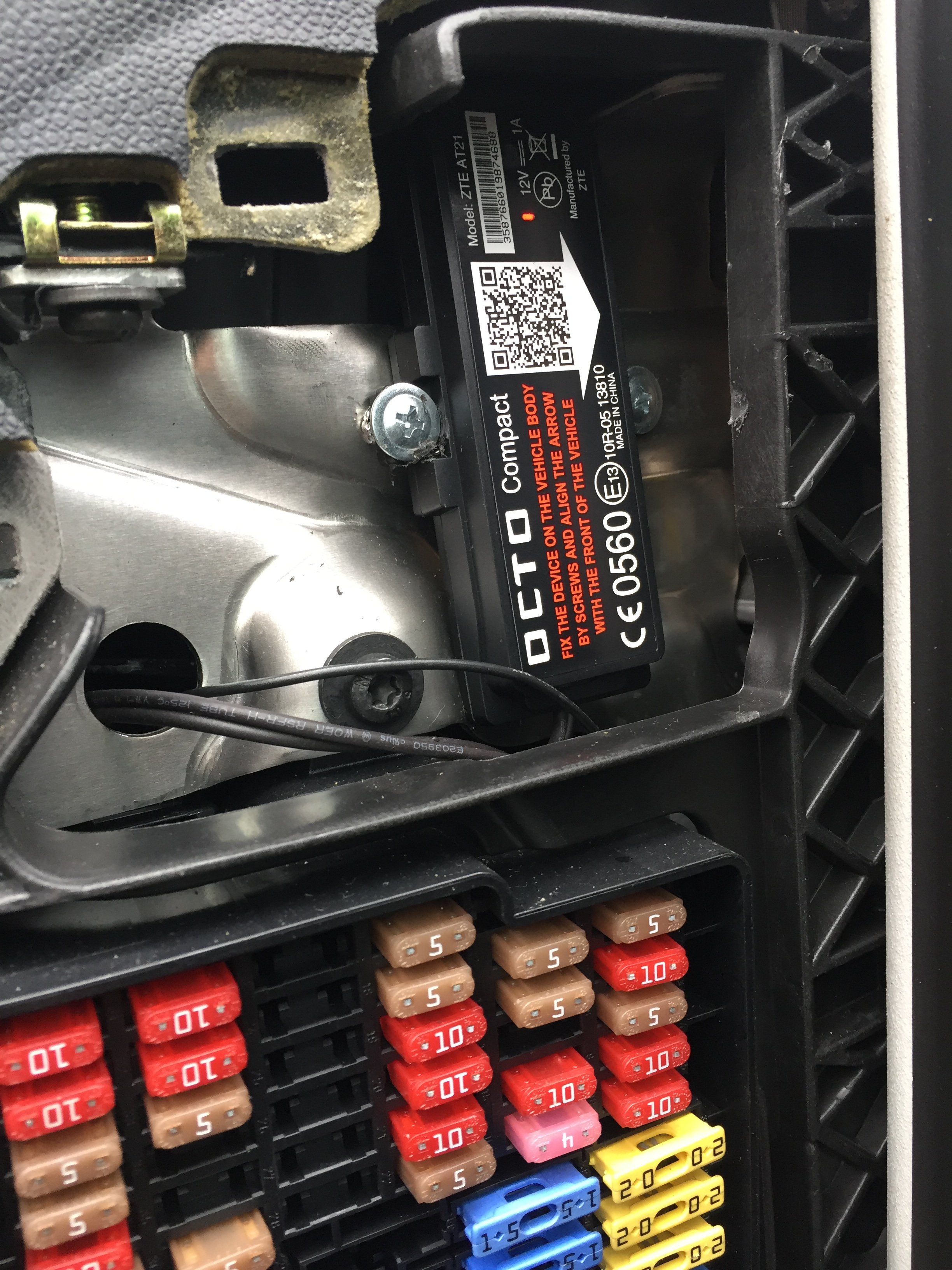

Please tell me if this a co-incidence but is it likely that a telemetry device i.e. black box install could have triggered the ABS electrical circuit problem? I had one installed on the 8th May for my son's insurance policy, which was about 10 days before the warning light lit.
After a rummage I found the device in the fuse compartment area :-
@garibaldy - I wouldn't rule it out given the location.
It's bothering me @KenONeill, almost as much as the ABS sensor cable that wasn't seated properly in the OSR wheel arch.
I don't know enough about the electical systems but wouldn't the ABS light have triggered immediately if the "Black Box" install was the problem? What is important about the location - do you mean the routing of the O/S wiring loom?

@garibaldy - I have very little more idea than you do, but the black box wiring seems to vanish behind the fuse box, which makes me think that something could have been disturbed when fitting it.
It's only taking a live feed, it's not tapping into the cars electronics, we're moving into the realms of superstition here chaps...

I don't think the sensor cable runs into the cabin at all, does it, just along the underside of the shell.  I'd be very surprised if the black box was doing any mischief.

This is pretty much what a friend of mine said. Is it possible that the black & brown ABS sensor wires could have been damaged during the install? A long shot probably.

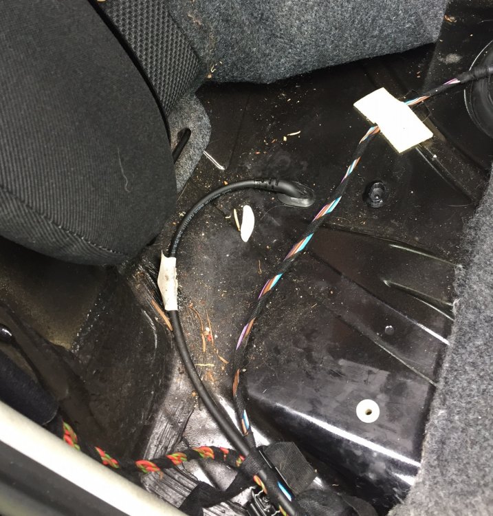

Hi Win - I've found the ABS sensor cable :) , black cable below stamped with code FLR31Y11Y which gives a couple of 'ABS cable' hits on the web. It has black and brown wires that splice into the main wiring halfway along the rear door entrance.
You can see below the taped black wire, then the brown wire is taped in just below my thumb. My thought process is to remove the tape (see what is inside) and check continuity between the sensor and here.
Edited by garibaldy
When I first saw the black wire taped up I got excited as it looked like a repair, although the brown wire is the same so I'm assuming it left the factory like that.
Was expecting something more professional, although removing the tape should show more.
Edited by garibaldy

OK so they do go through the cabin. VW/Skoda seem to have some crimping system for joining wires within looms, I think you will find a neat clean join under each taped bit, unless they've been done post-manufacture.
At least it makes it easy to buzz out the rear section of the wiring, from those joins.

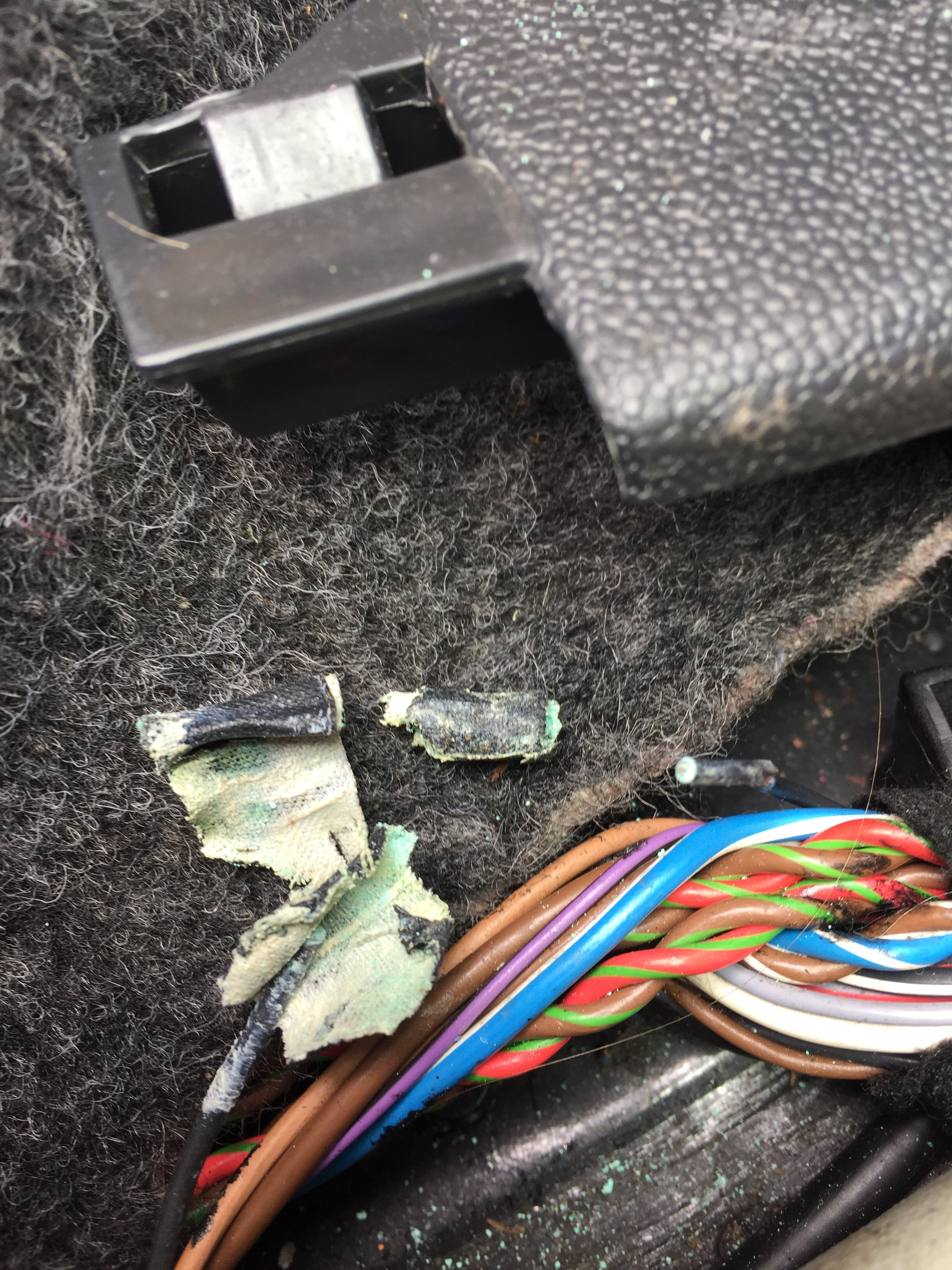

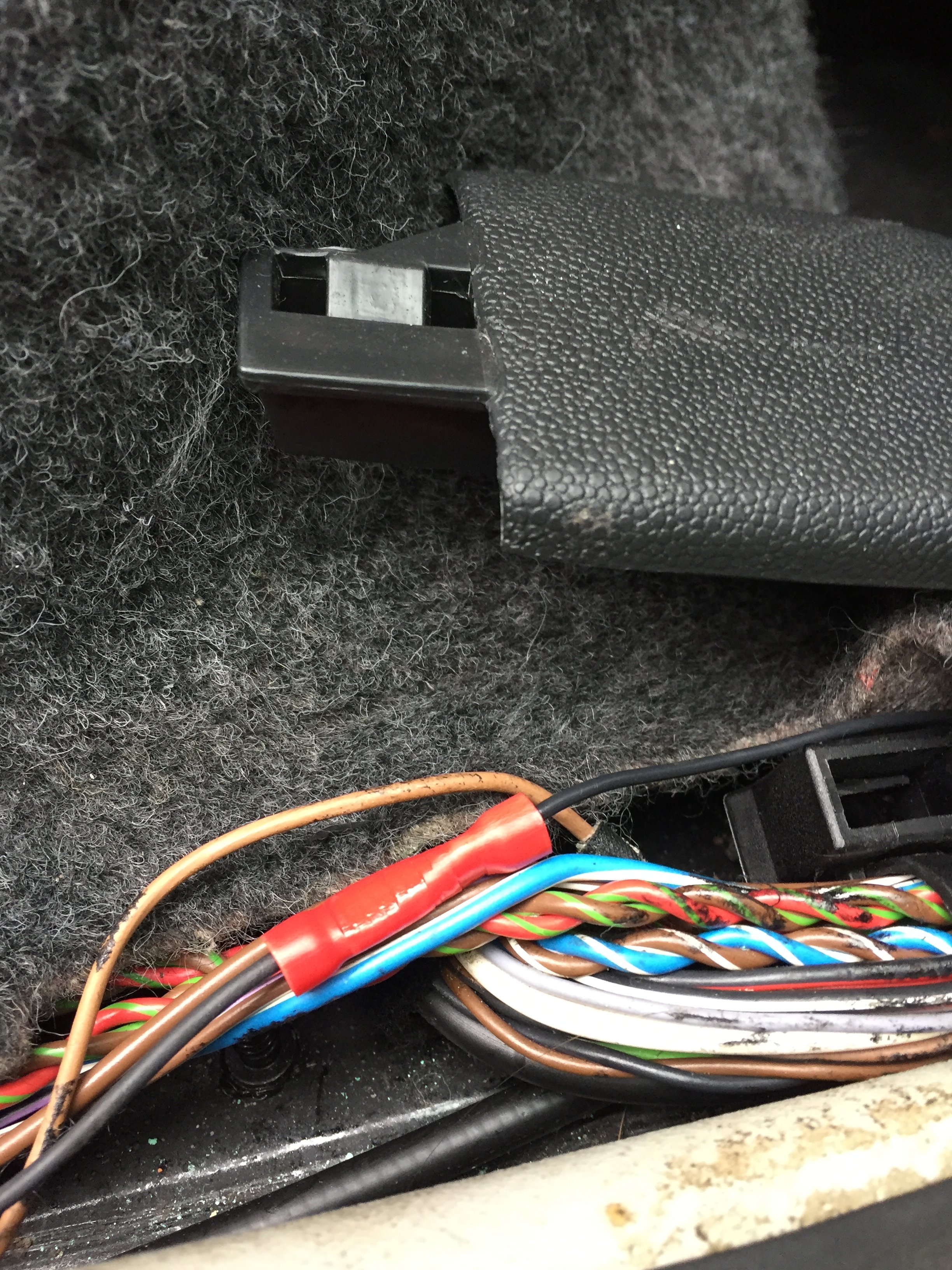

cut back to clean copper, twisted together the wire ends, and the ABS light cleared! Finished off the job with amatuerish crimping effort :-
No more ABS warning light :)

Good job fella, hope you've found the root of the problem, cable damage must have occurred for a reason or more to the point due to a reason, it might be prudent to splice in length of cable with either end joint away from where your crimp is and then protect the cable loom as safely as possible, otherwise...........

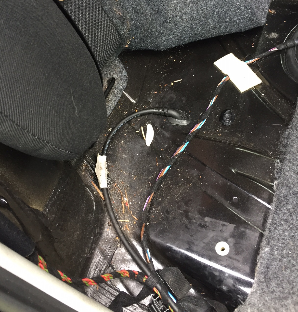

I reckon i've just found the root of the problem. Was going to save it for another thread, but your post is timely David. Went outside in the rain to admire the repair :cool: and noticed a pool of water bridging the seal!!! Near side rear is dry as a bone, but rainwater ingress is the problem on offside rear :-
Think this is a known problem so will have to search the forum, but for now I'm putting my feet up with a smile on my face!
