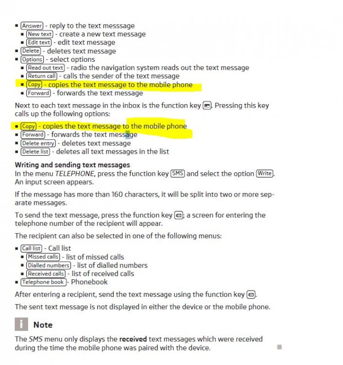

I know with the Columbus unit as fitted to mine you can copy the text to the phone if you want to keep it.... This is in the Columbus manual..
that's a bit of  a palaver mind as you have to do each text
Doesn`t work, at least for me.
