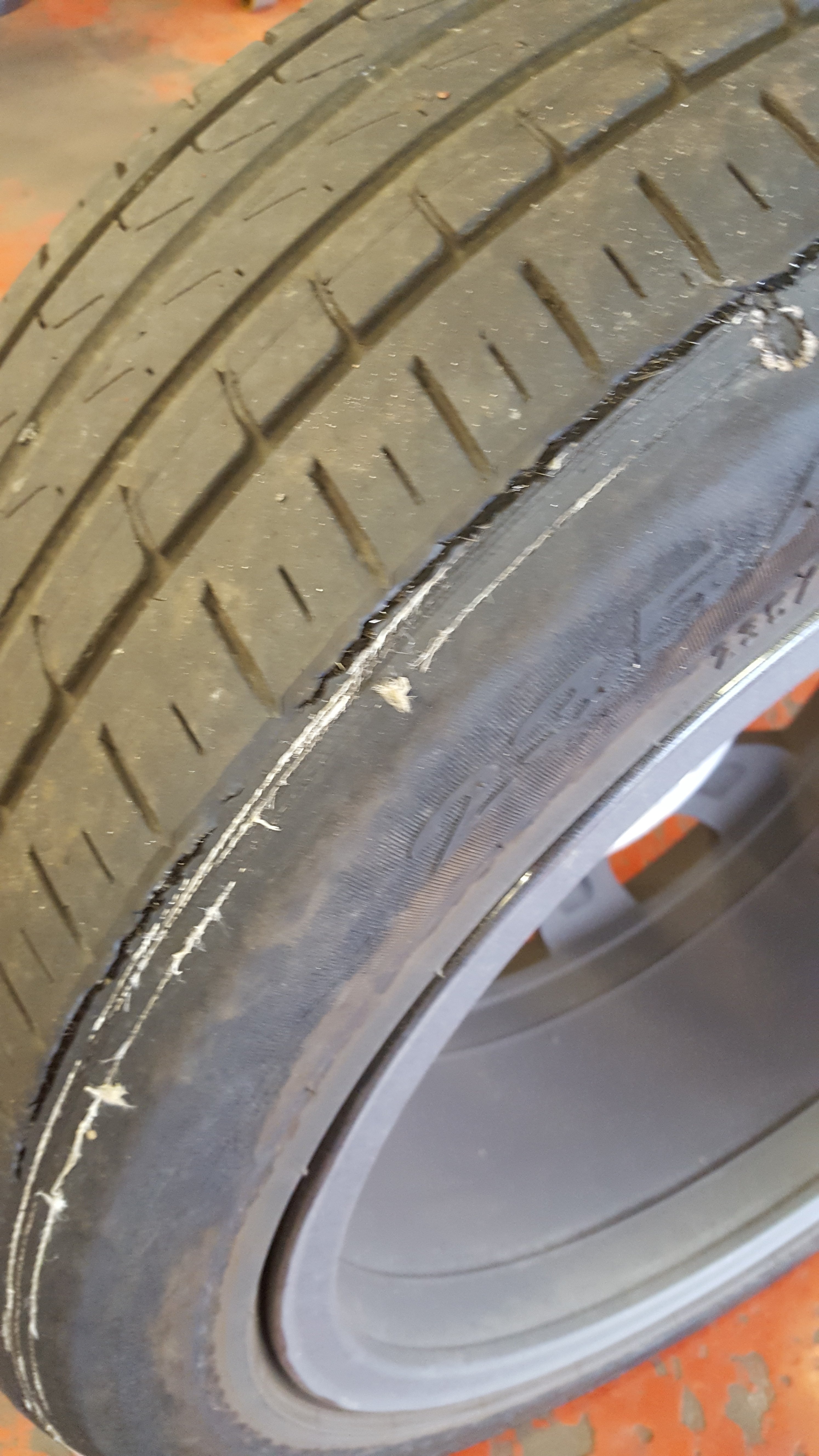

This is my front O/S tyre this morning, which suddenly deflated on me. Thankfully I had just stopped, the front n/s went about 2000 miles ago, big nail through it, but i noticed then that it appeared very worn on the inside edge. This one is a real mess and could have been a lot worse had i been on a motorway or something. The fitter checked to see if it had been scraping against anything on the car suspension and no it hadn't. So I think the car needs looking at as the tracking or wheel caster/camber must be out. Anyone else had problems mine is on 18" wheels not 19". I suggest very strongly you check your tyres on full lock the wires and canvas were sticking out, don't run your hand over it as you will cut your hand to bits. I am more than a bit shocked as the tyres still have a good tread 4mm at least.
With regard to the above,I have just spoken to a mechanic friend and shown him the photo his opinion is that the cars wheels are towing out and it needs tracking and wheel alinement checking. Tow out is apparently when the front wheels point slightly outwards and tow in the opposite pointing slightly inwards at the front.
Edited by russ1610

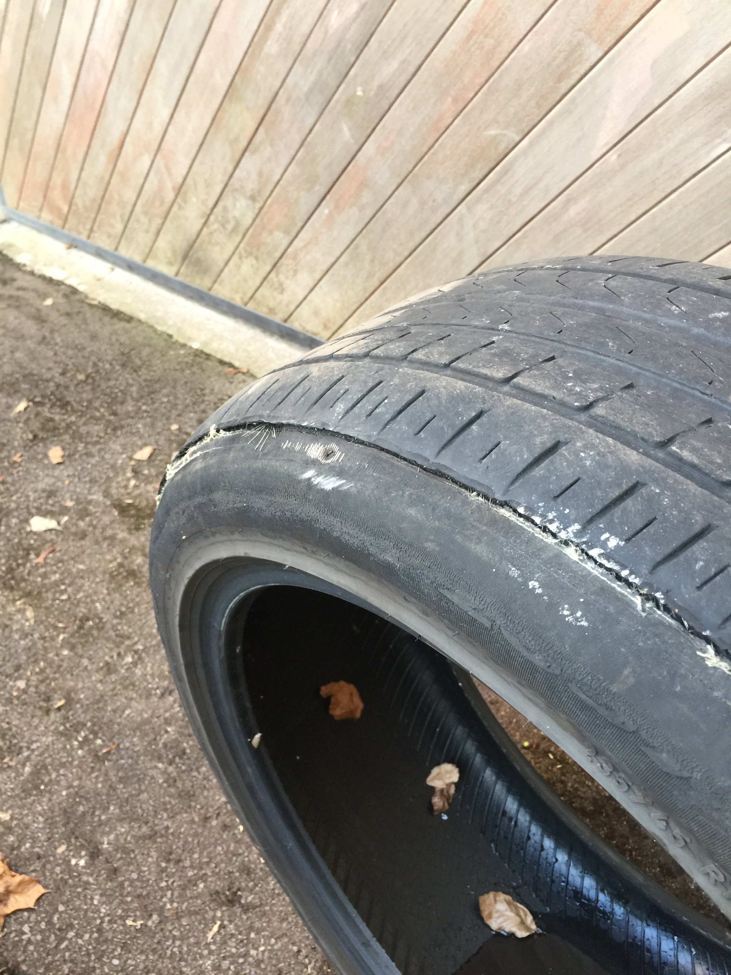

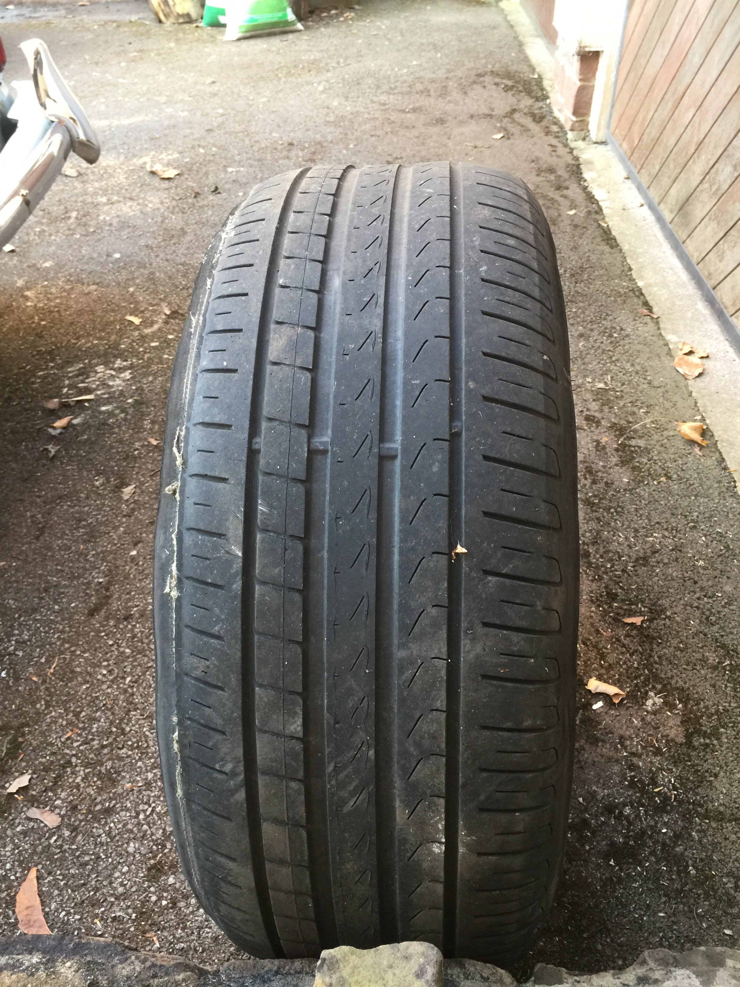

Thanks for your thought AGFalco.  I’m hoping the tyres (at 2,2 bar - 32psi recommended by Skoda) were correctly inflated. This is what the tyre looked like
I run my Fabia at the Eco pressures which are 2.4 Bar all round.
The wider and or lower profile the tyre the higher the pressure wanted.
The Eco pressures for 19'' would be higher than this.
Maybe at least  2.7-3.0 Bar. Look behind the fuel filler cap.
