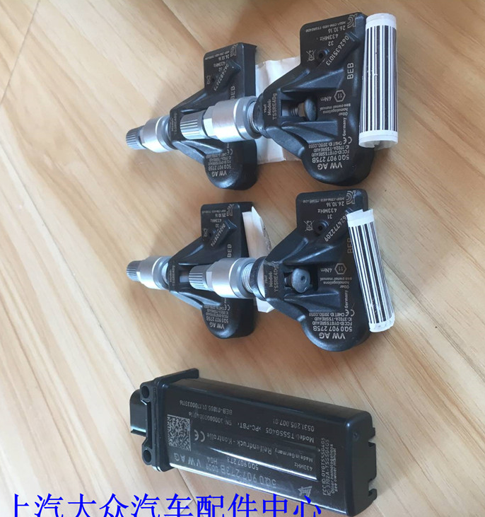

Tire Pressure Monitoring System
6. tire's pressure system TMPS: £173.2, the 2nd generation for MQB platform or passat B8, need support by hi-end gateway controllor
https://item.taobao.com/item.htm?spm=a230r.1.14.16.CGNl6x&id=545311745705&ns=1&abbucket=11#detail
the controllor cost an extra £23~£35
and here is the whole system: £190.54
https://item.taobao.com/item.htm?spm=a230r.1.14.11.X4KGbt&id=540282493330&ns=1&abbucket=11#detail
Controler:  5Q0907530AC/AF /AJ
Sensor: 5Q0907275B
Ventils: 3AA907273H

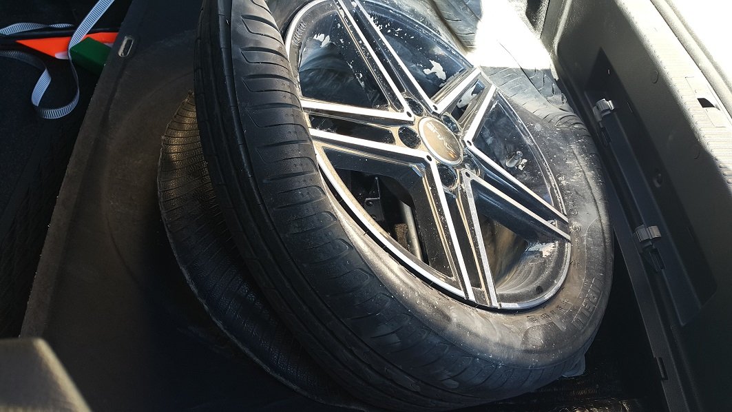

nothing unusual, i started ~180km trip back to home(the same day if midnight not counted)
after ~30km got warning light on Maxdot,
didn't stop cause no gas station on that route
next ~25km gave me blew up tire :(
2.
sorry, my english is too short :(
i mean't when you drive in the city you can visit gas station and check pressure immediately after warning is shown.
on the highway only ACTIVE TPMS can give full picture of situation

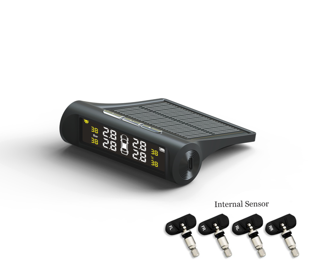

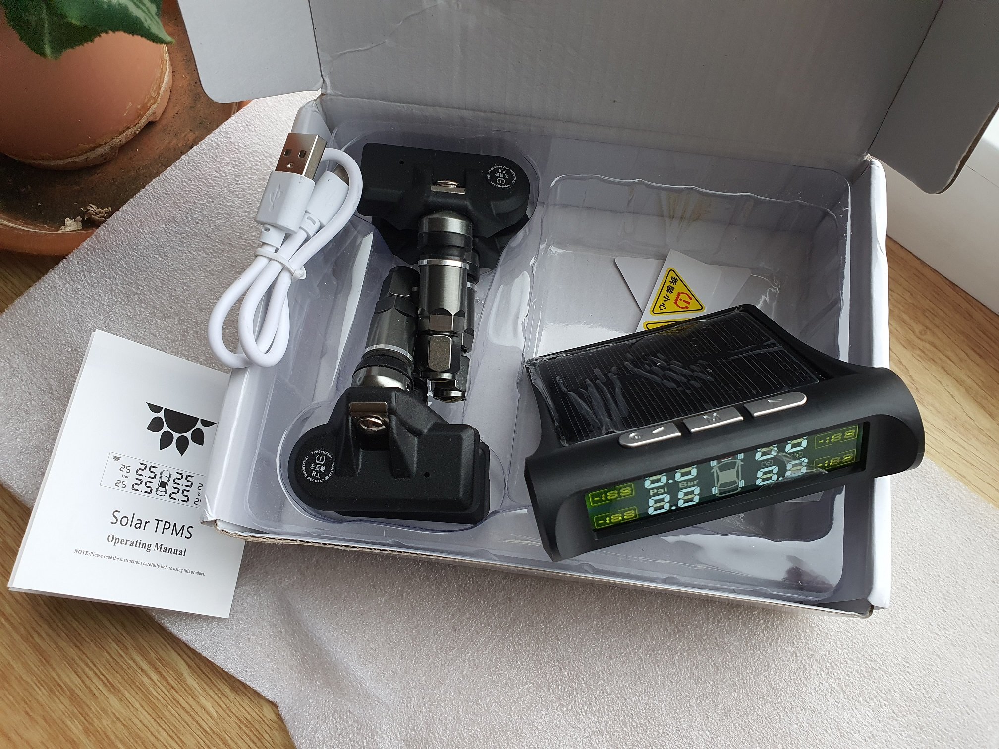

extreme high prices 500+ were the reason why i chose alternative way from Ali
have ordered full set ~53e and additional 4 sensors ~37e for winter wheels
about result in this lottery game i'll report later :)
https://www.aliexpress.com/item/TPMS-Car-Detector-Tire-Pressure-Monitoring-System-TY04-Solar-Energy-Display-4-Internal-Sensor-Auto-Alarm/32801389832.html
https://www.aliexpress.com/item/TPMS-Car-detector-Tire-Pressure-Monitoring-System-TY03-Solar-Energy-Display-4-x-Interna-Sensor-alone/32813227063.html
crossing fingers they will come until 14.jul when i starting Riga(LV)<->Burgas(BG) trip

arrived just in 15 days :)

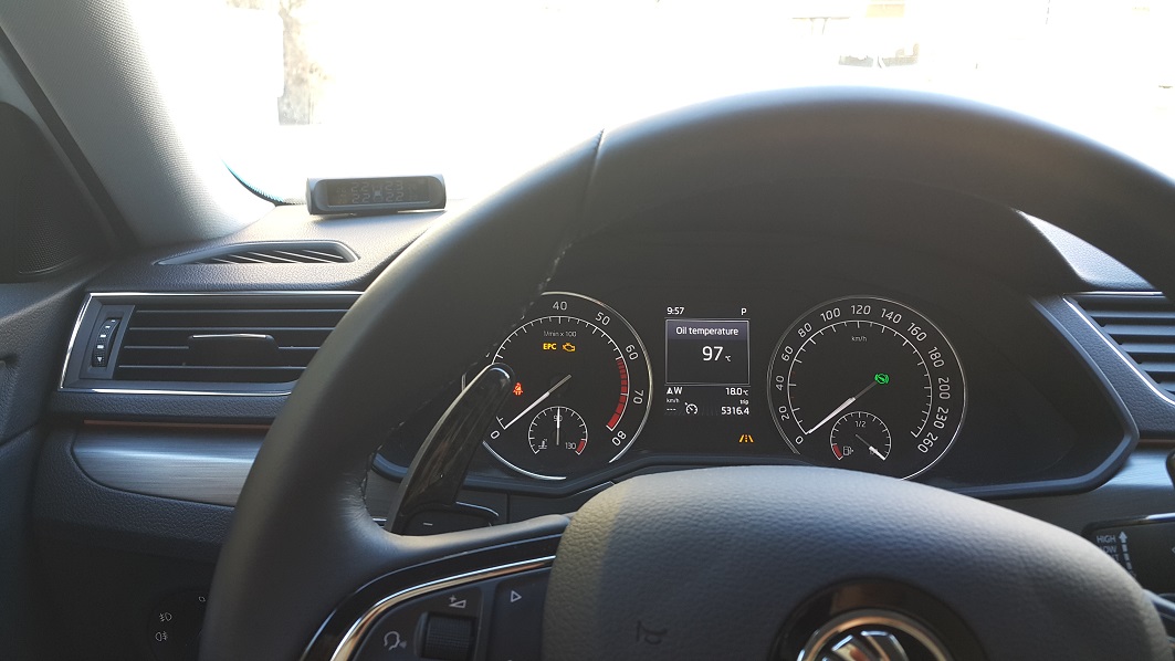

Just now, MartiniB said:

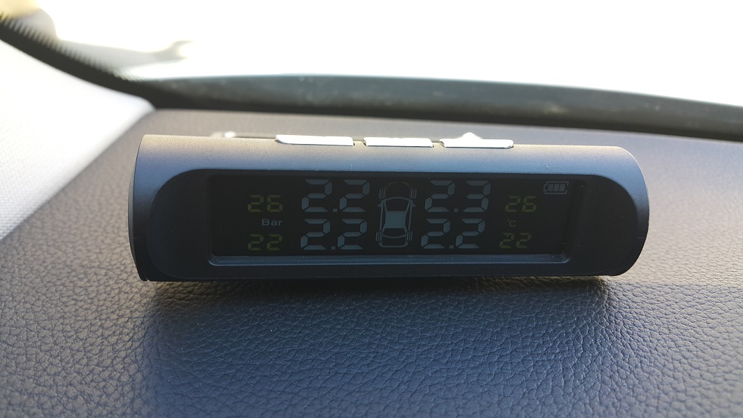

225/55r17
i used to 2.5 in front and 2.4 in rear,
but after have installed Direct TMPS
https://www.briskoda.net/forums/topic/434028-tire-pressure-monitoring-system/
decided increase to 2.7/2.5 because on colder(12°c) mornings that are equal to 2.3/2.2
but after few hours on hot highway(air >30°c; track >40°c; speed >130kmh) pressure increased to 2.9/.2.7
interesting, engine is boiling front right tire when in static,
have got 3.2 and  60°c after three hours waiting on Serbian Hungarian border(1km3h; air 33°c; Sun from the left side)
while other three wheels were 2.8/2.6 and 42°c.
this dangerous situation can't be warned by built in Indirect TMPS

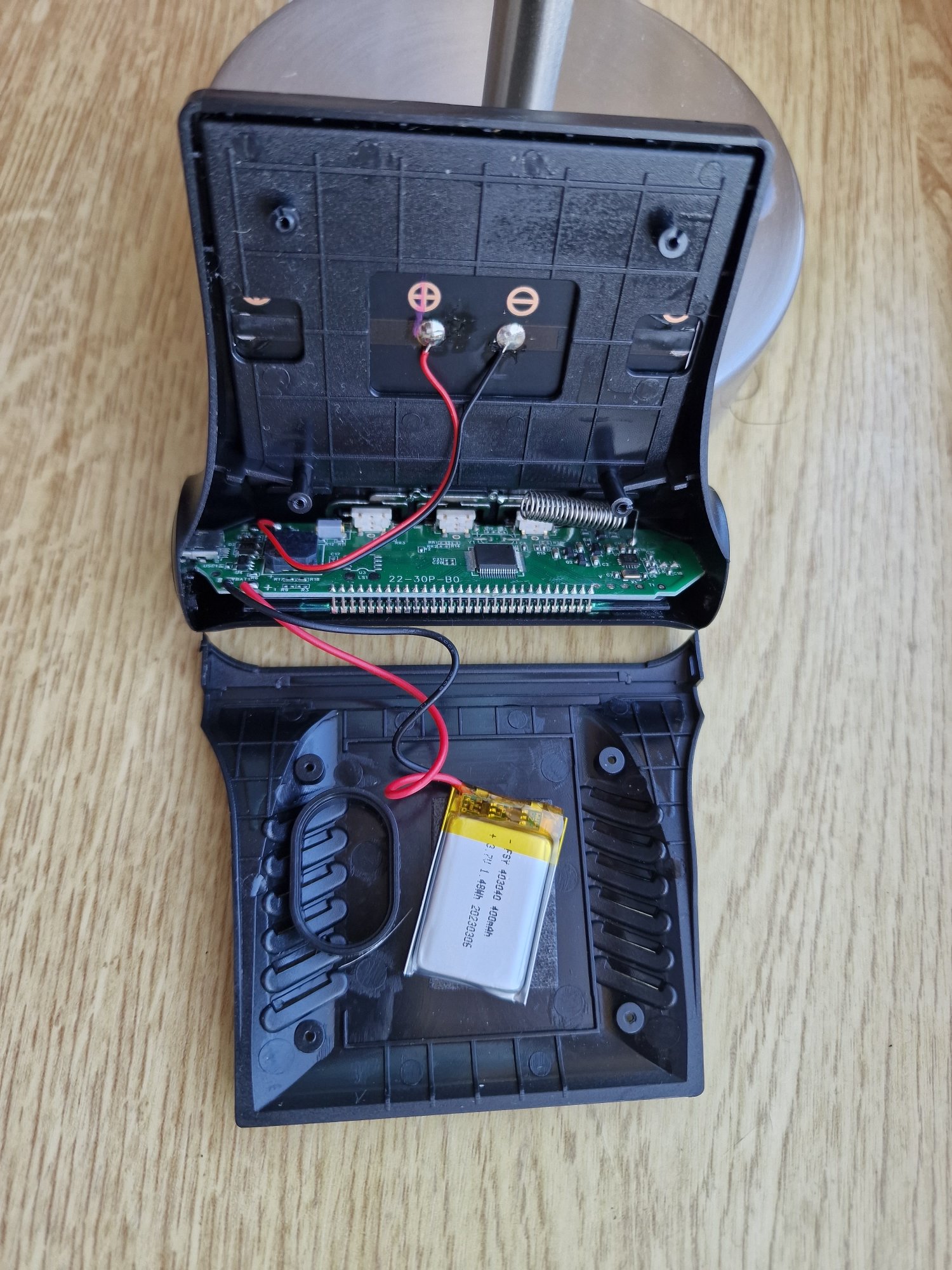

I presume its all wireless, and the main unit is solar powered? Does it have batteries?
@bubib5 @BarneyMike

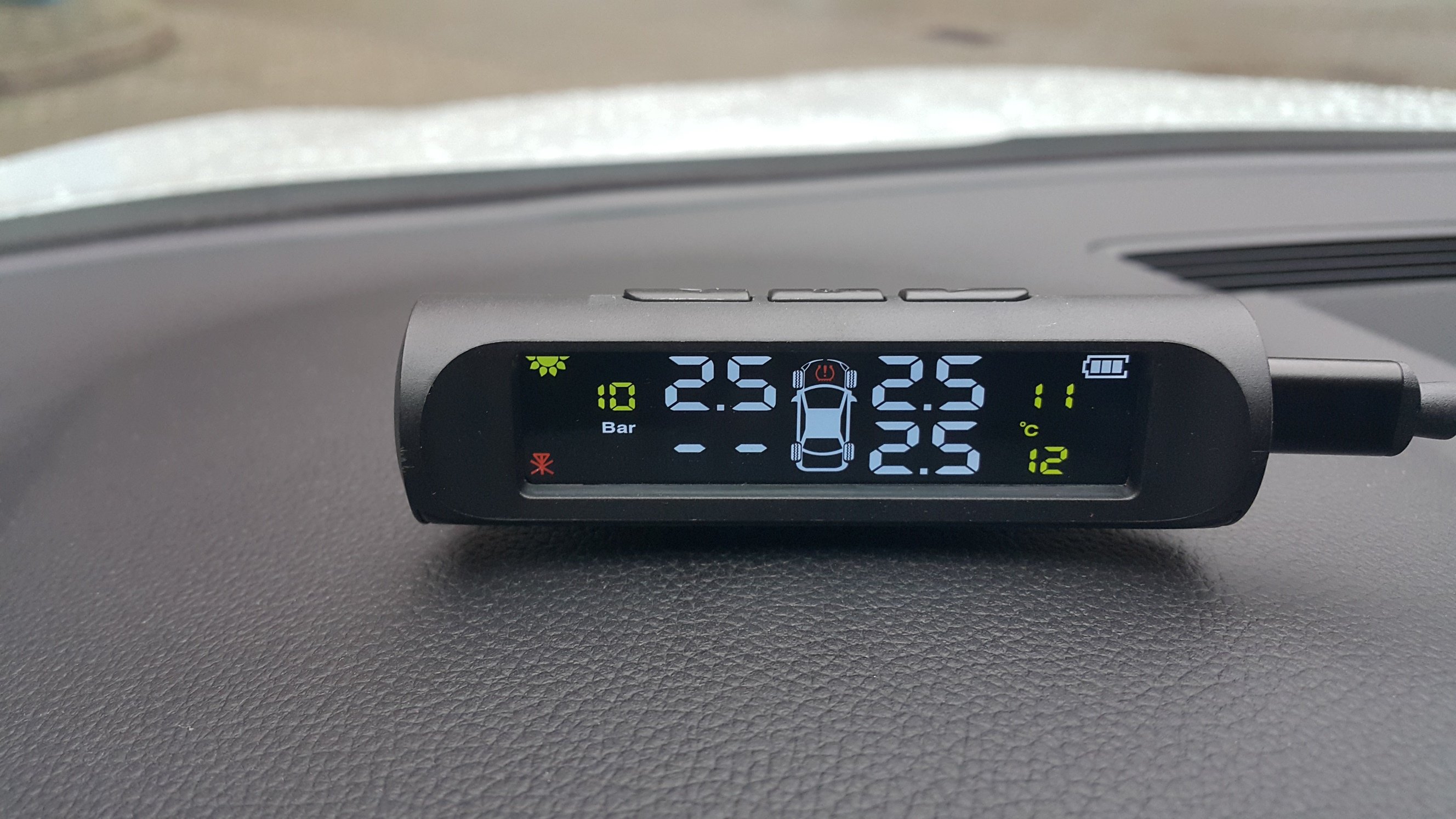

it charges from solar panel, but original 480mAh weren't enough for winter period -
had to charge it once a week trough Micro USB port
then i soldered bigger capacity one, 1500mAh, and now it's asks for cable three times a year
-> https://www.drive2.ru/l/549376208572252702/
not all models got perfect type of display, i still have 2017. year device,
2017 -> https://www.drive2.ru/b/481045409196671532/

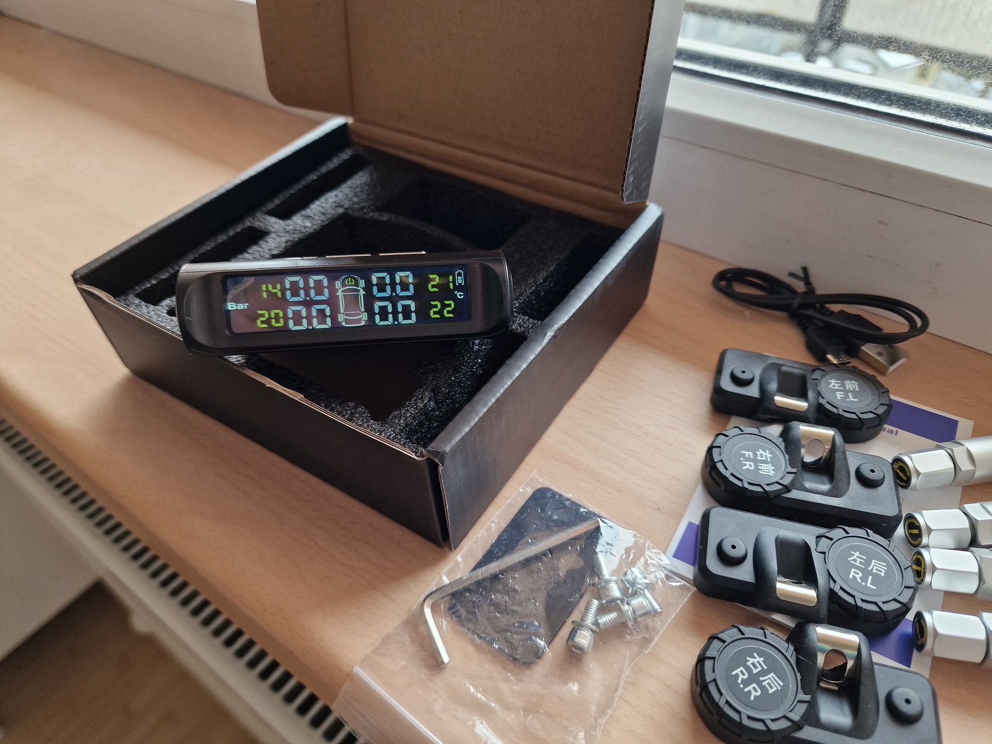

positive:
+ price
+ independence of car systems
+ shows additionally to pressure also temperature
+ in most cases it works well, i have had 4 kits by self + 5 kits ordered for friends, just one were faulty.
 oldest one in my hands lasted 6 summers and were sold together with car,
 during last year it took longer time to wake up sensors in the tires,
 had to drive 100m, while earlier 15m were enough

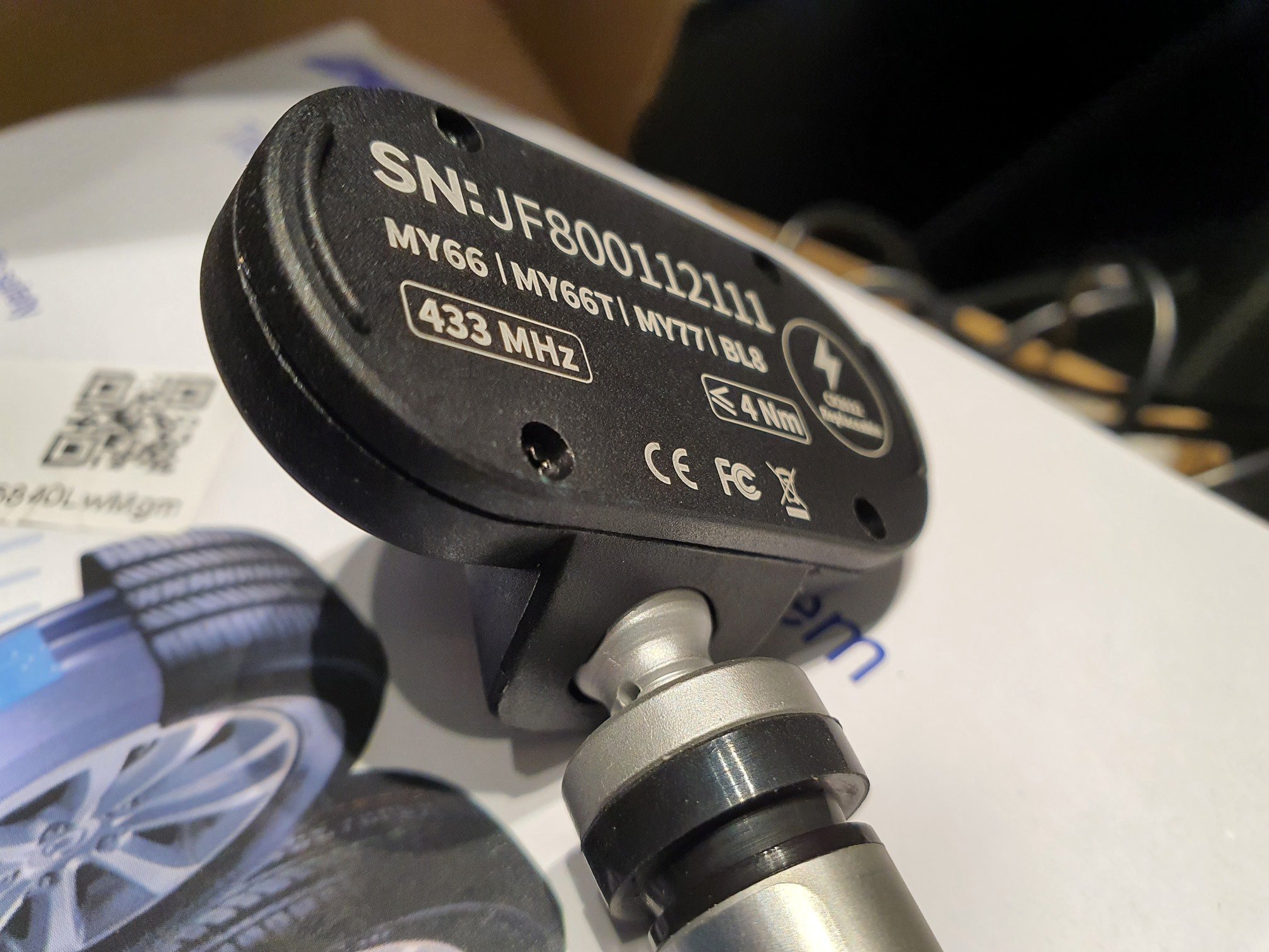

negative:
- devices looks identical, but in most cases sensors aren't cross compatible between different manufacturers
- last two sets have measurement inaccuracy,
  it's not big deal if all sensors lies for similar value,
  but awful when same kit have two with +0.1 one +0.2  and forth -0.1 bar
- last years devices woke up with loud beep, what can't be changed

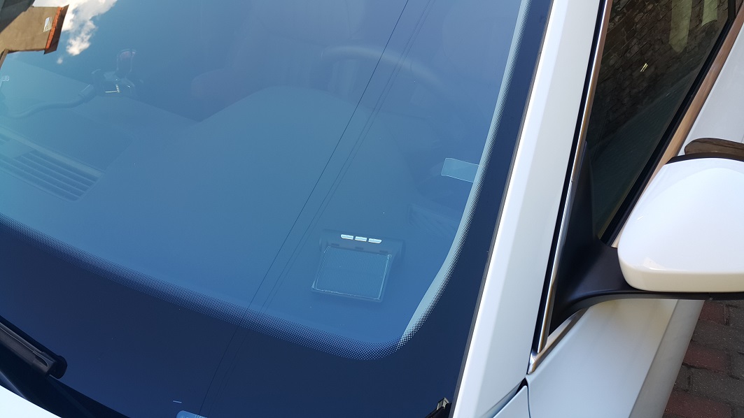

- chrome knobs maybe looks perfect in product description,
 but in real life they reflects in windscreen, some i painted black, some covered by black film
- receiver devices which i had came with 480mAh built in battery,
what is enough for April -> September, when it's fed completely by solar panel.
but in winter months it asks for charge cable once a 7-10 days,
solution is, replace battery to 3-4x more capacious

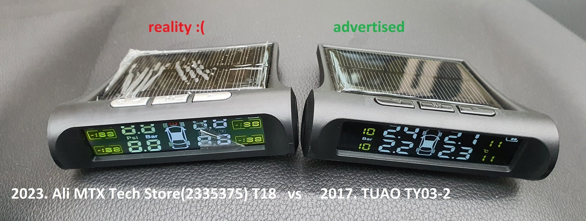

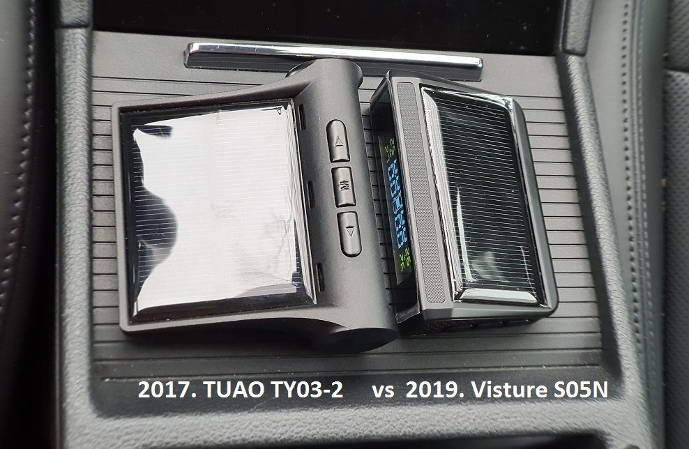

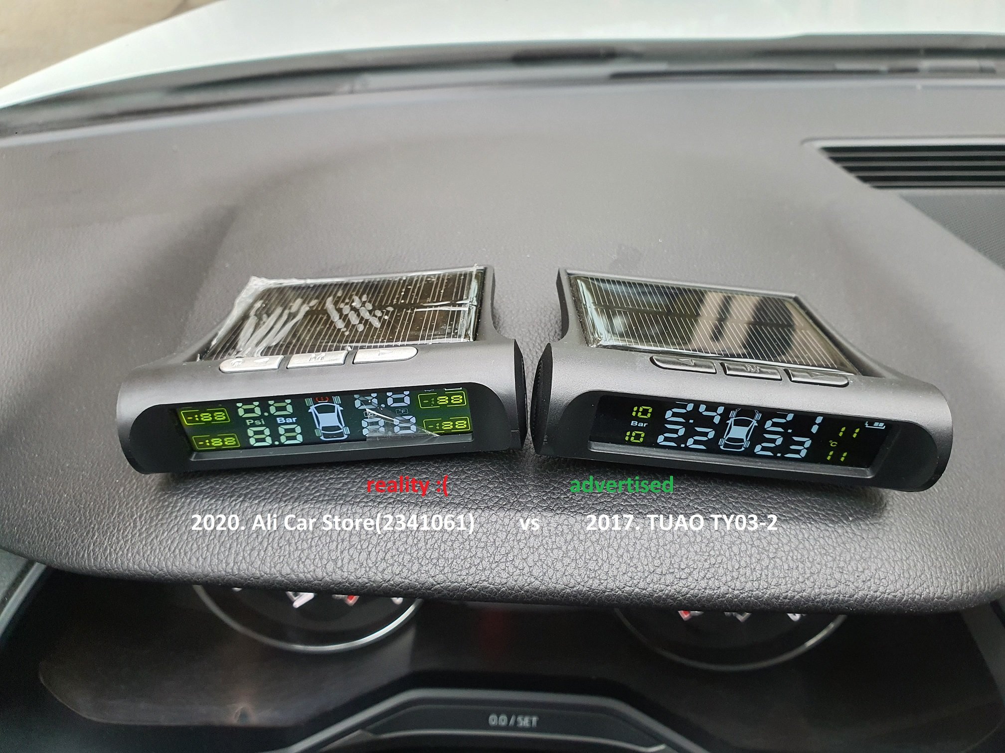

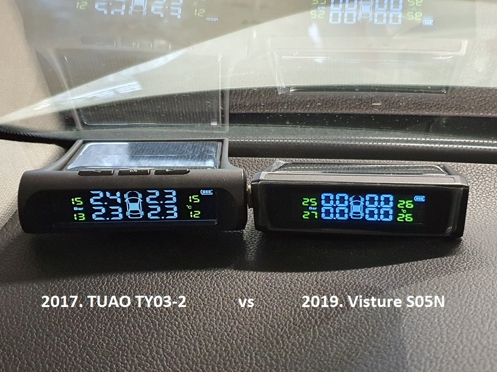

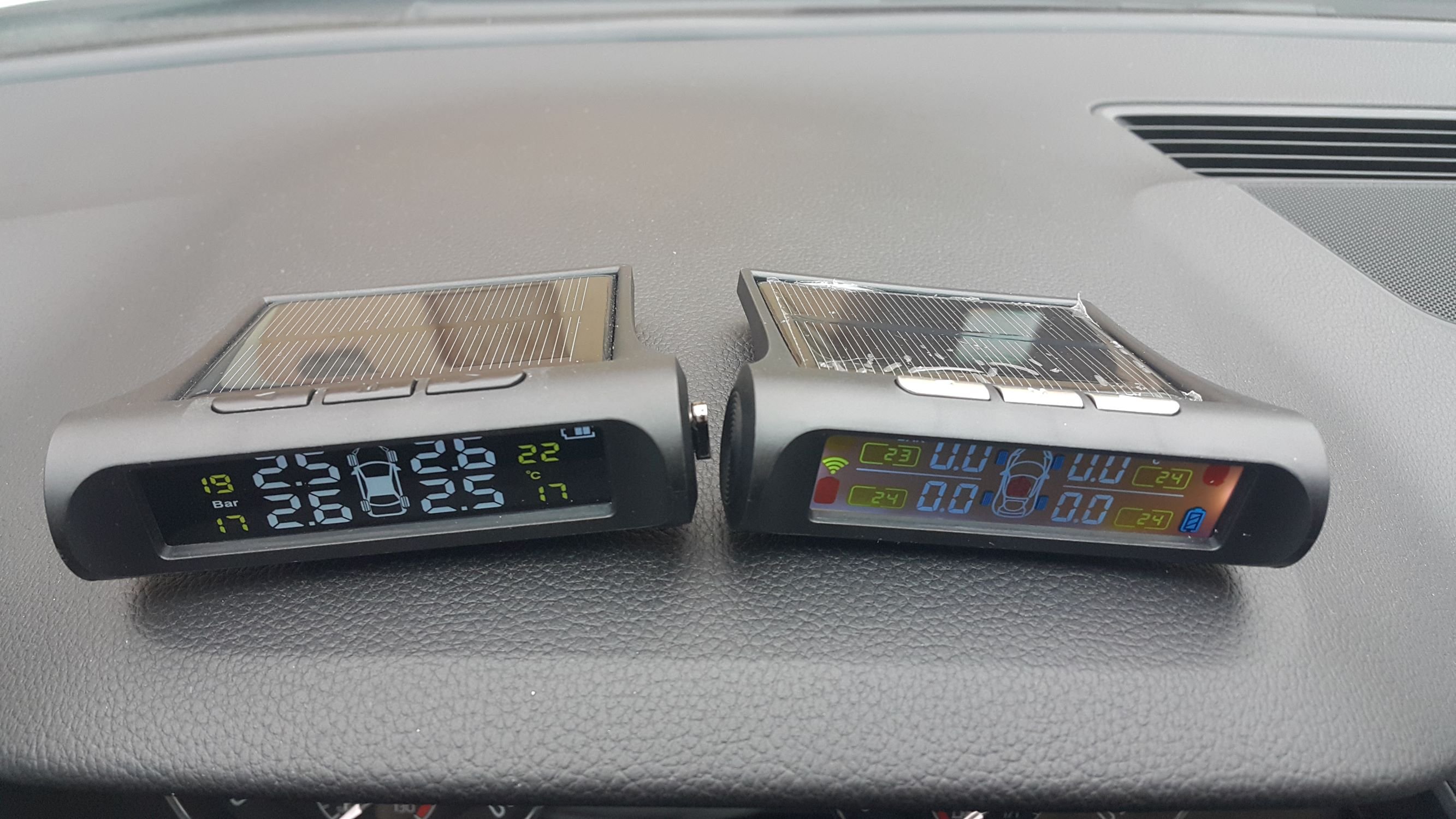

- nowadays is almost impossible find receiver device with perfect type of display
perfect one were TUAO_TY03-2
receiver device had display something like OLED, without visible backlite
exactly same as product description
in far 2017. kit costed me 53€ 4x internal sensors with perfect display
+35€ second set of 4x internal sensors for winter wheels

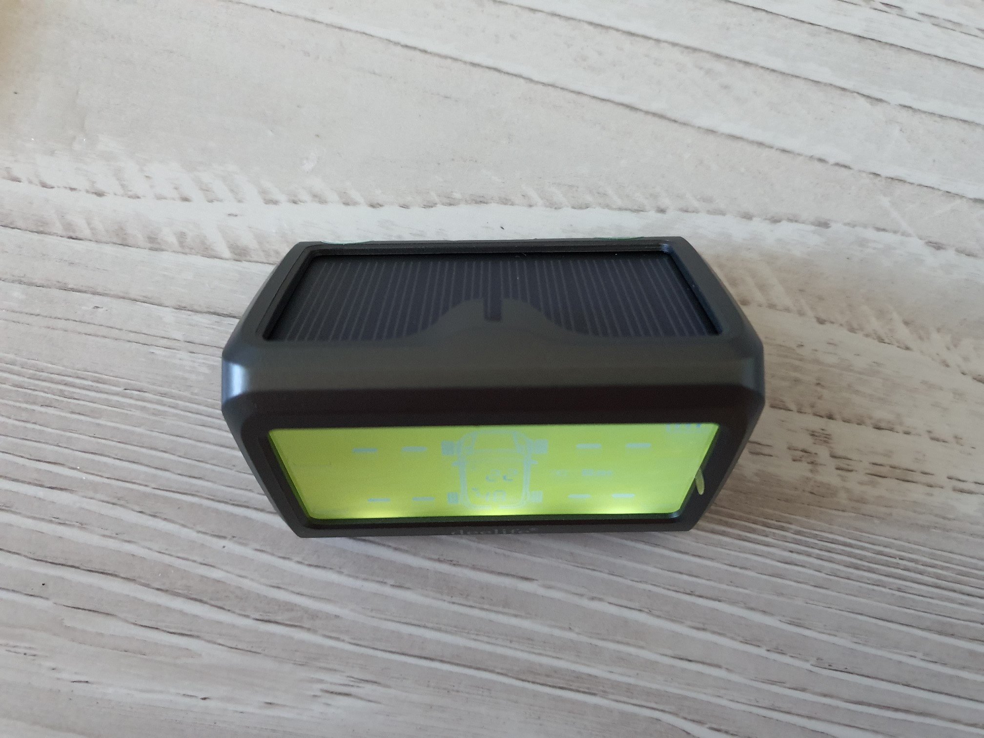

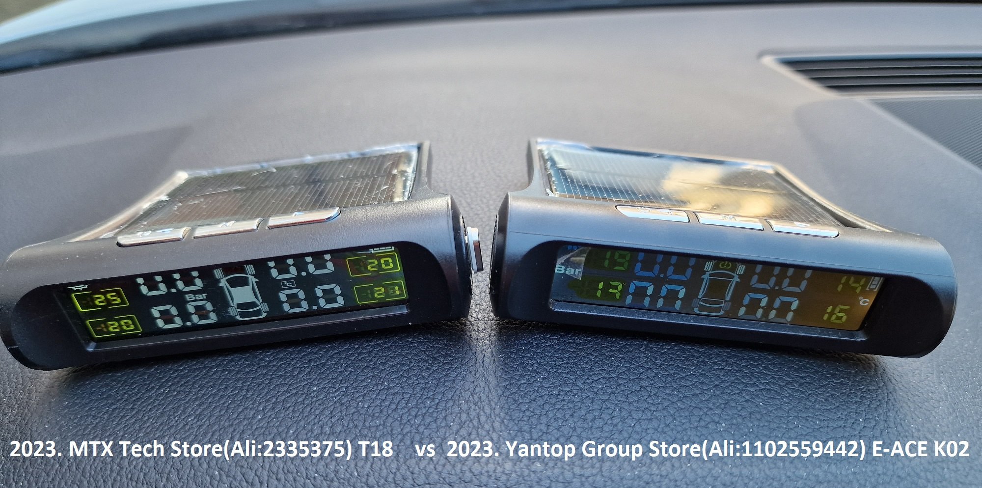

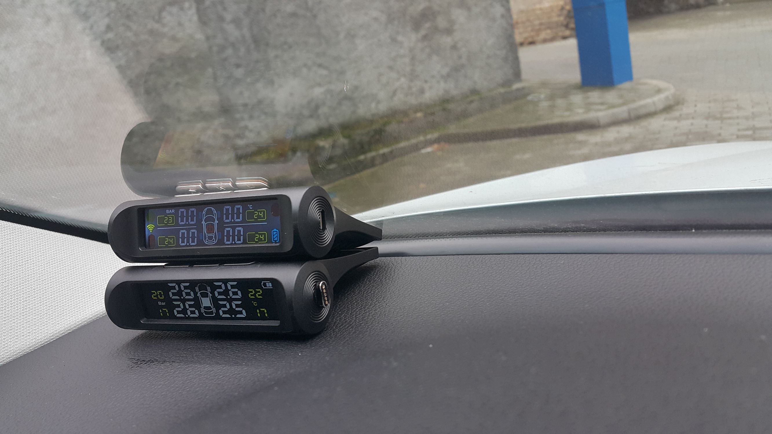

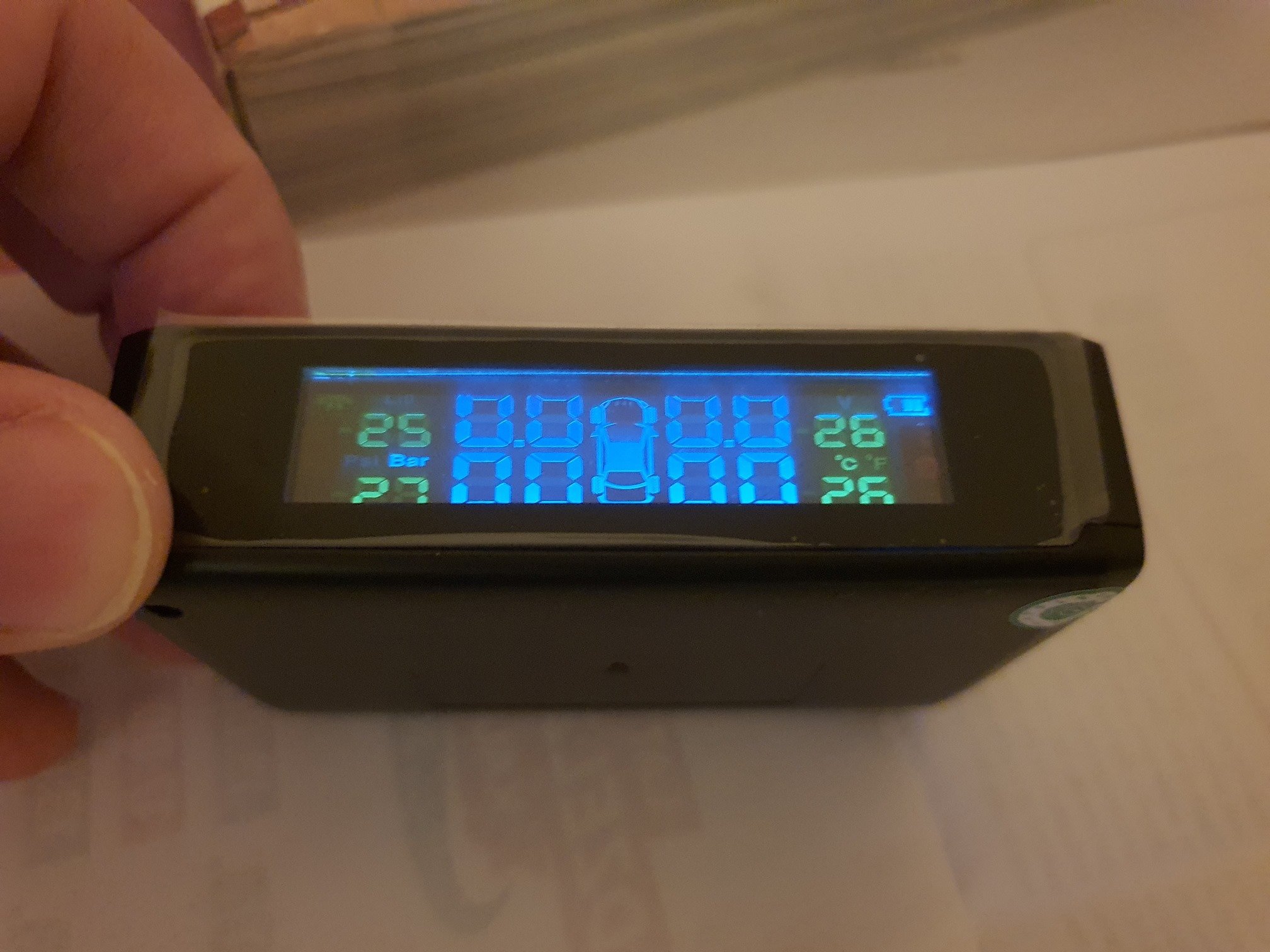

next years displays had noticeable or huge backlite bleed 😞
2017 vs 2018
2017 vs 2019 Visture_S05N
2017 vs 2020

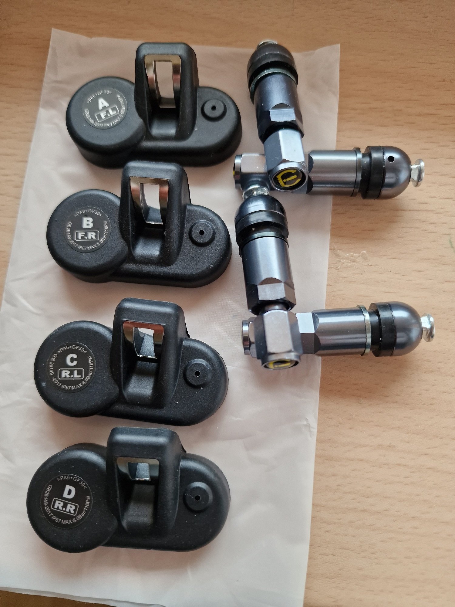

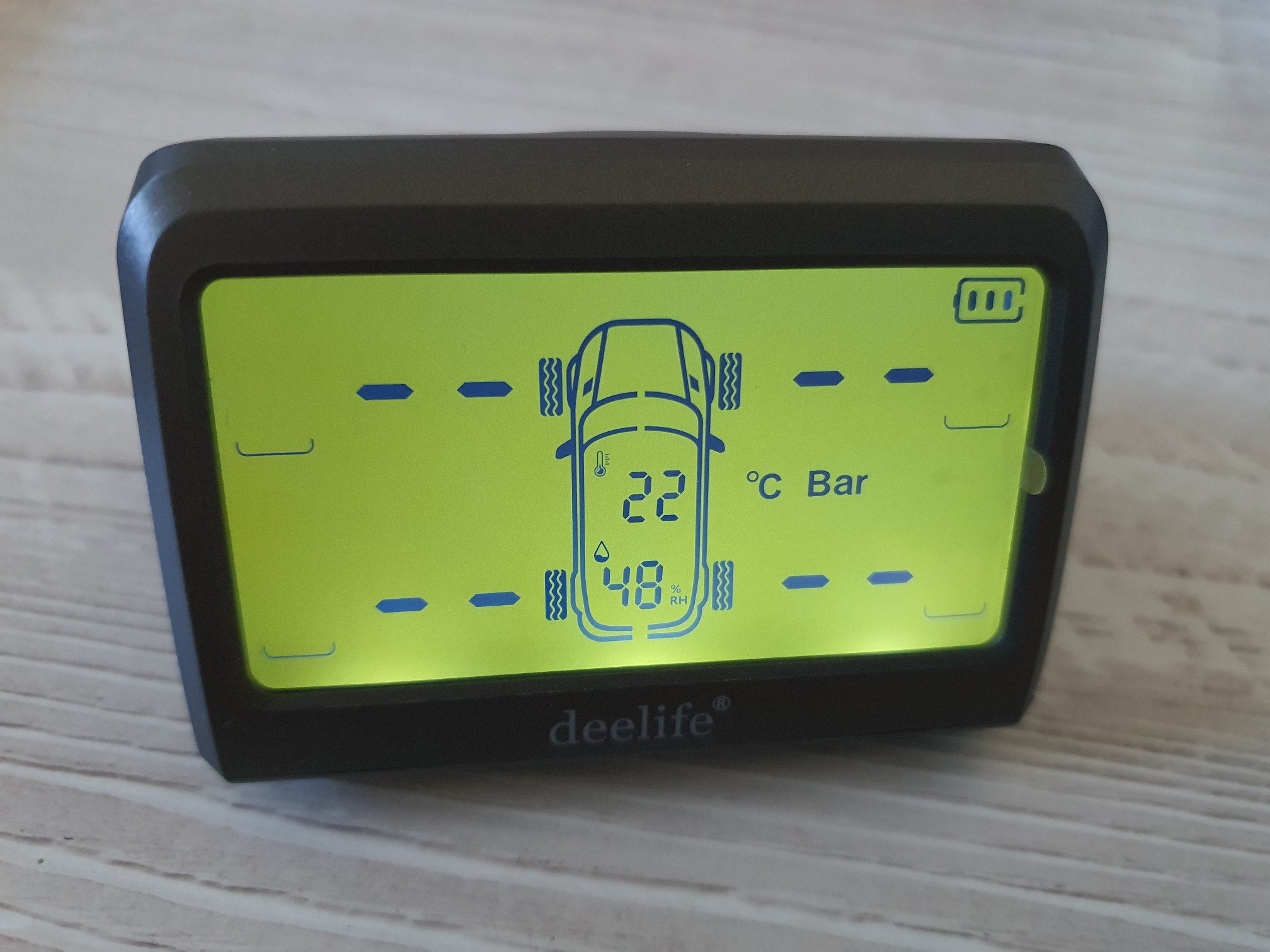

2022 unique kit where internal sensors had replaceable battery, but display looks like from past century

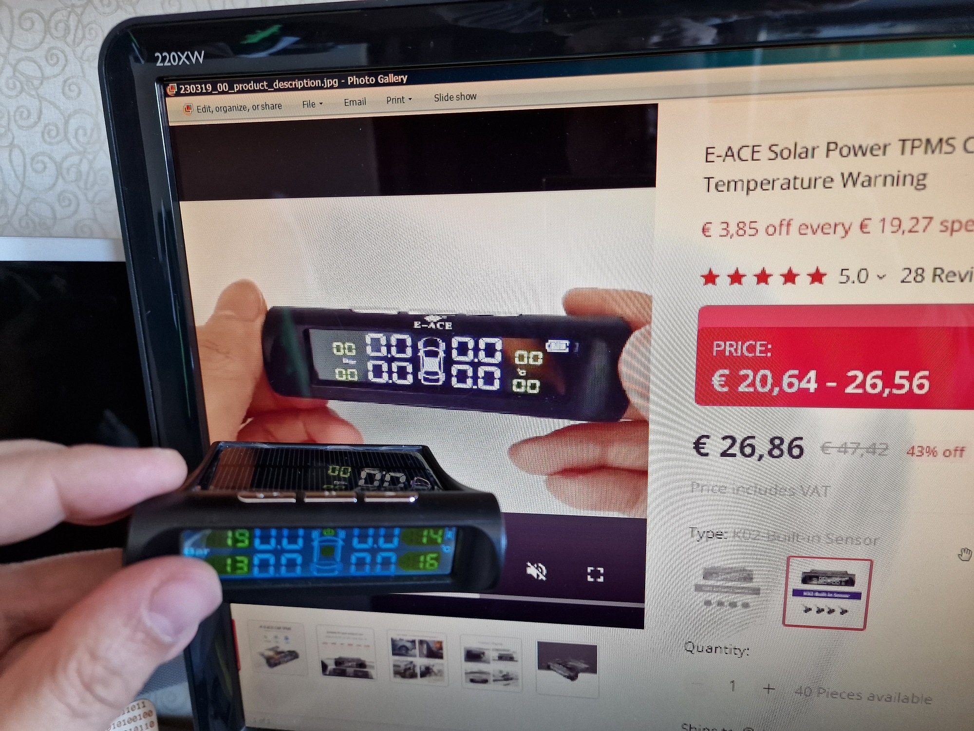

2017 vs 2023 T18
2023 T18 vs 2023 E-ACE K02
but that fact gave me 50% refund from Ali for last two kits,
because before order i asked seller, is their device same as advertised
